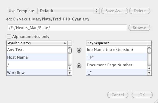

From your post, I think you need to add a Copy File module to your workflow. Go to the workflow using Nexus Manager. Unlock the workflow, then you can see the list of modules that are available to you. The Copy File module should be near the top of the list. Drag and drop into the workflow. Double click on that module, and click on Edit Template. There, you will see where to add the path to where you wish to copy the file to. Below where you add the path, you will see the available keys on the left. Click on the keys you need to, and use the right (add) button to add the keys to work template. Let me know if this is the direction you are trying to go.

An example of what I have done is to add a copy file module to my plate workflow. The plate workflow sends the 1-bit tiff to a hot folder that is connected to Prinergy Evo, which runs our platesetter. Once that job is plated, Prinergy only keeps the 1-bit tiff for a couple days, and it gets purged. I wanted to save those tiffs on a plate folder on our Nexus Mac. I made folder called Plate, and then added a Copy File module at the end of the workflow. It is connected to the Copy File module that copies the tiffs to the Prinergy hot folder. I made that last Copy File module point to the Plate folder on the Nexus Mac, and it sends the file to that folder. Works like a charm. I set up the keys so that the files could be identified with the job name and number, the separation colors, etc. Hope this helps some.
