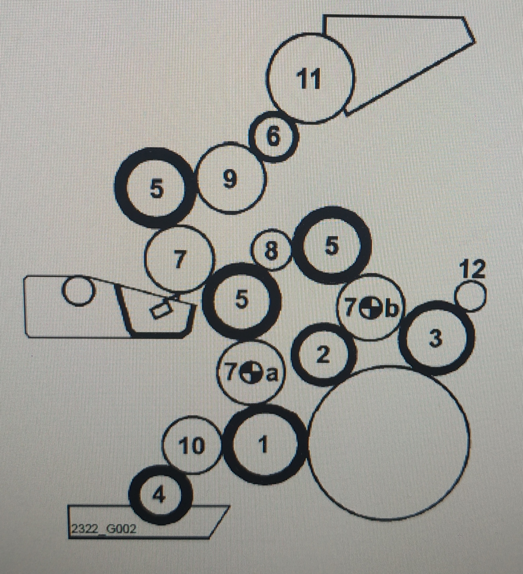

Hello. printing press CONCEPTA Muller MARTINI web. We print with oil paints for web press. There are problems with printing, strong tinting. If you take ink for offset sheet presses, then there are no such problems. Which paint is the right one to choose? Yes dampening device Integrated, without dampening roller. Water is supplied through the ink machine. Anyone with experience with these presses please help.
The printing plate is rolled up with paint. And it's impossible to print.

The main question is what ink should be used to print on such a colorful and moisturizing device as in the photo? For web or sheet machines?

The ink for the roll machine did not go immediately on this machine. We took the ink for the sheet machine that was used on the speedmaster 102 and the tinting of the form immediately passed. Now there is no experienced printer on this printing machine, so I took it upon myself to figure out what the matter is. The ink is ordinary oil.

Yes, the paper is offset, uncoated 50 grams. We use ink for newspaper and offset printing without drying. Next to me I have a similar printing machine for forms, but an older model and there the form does not tint on this ink.
Is it possible that as a result of being a new to your plant machine that the settings and general operation of the presses dampening unit has not been fully mastered yet?
