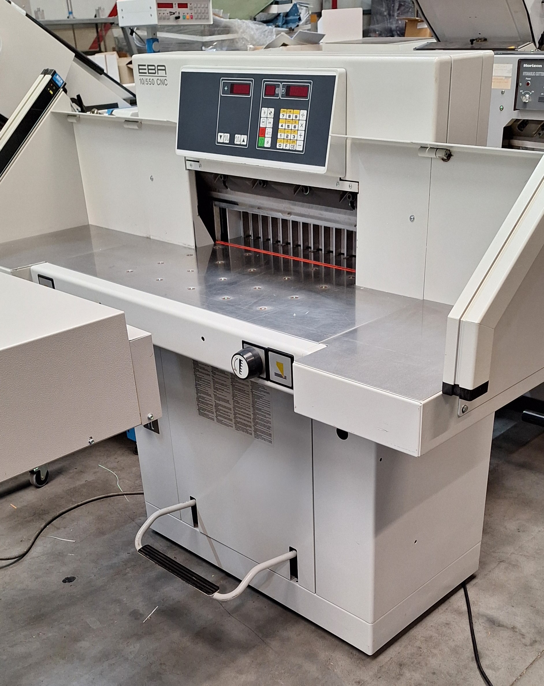

I've spoken to a second-hand dealer and he can offer me this machine for 3750 euro (before negotiating)
The machine is from 2008 and has programmable features. It seems reasonable, but before making the 100km drive, I'd like to make sure the machine fits what we're looking for
If I had the space I would be all over that for the money. You can't go wrong at that price.
That’s an excellent cutter for that price. You even got an air table and safety beams on there!
