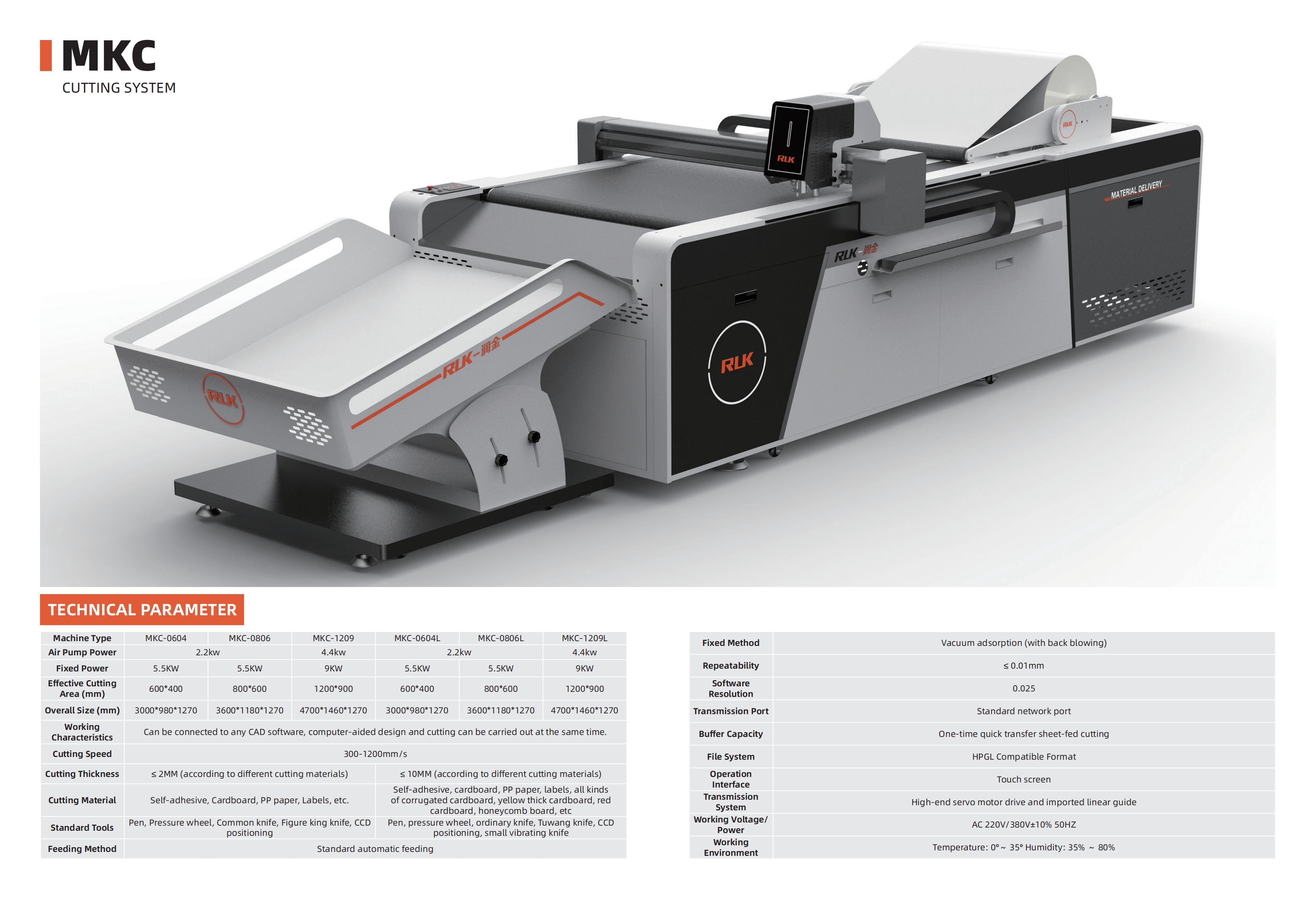

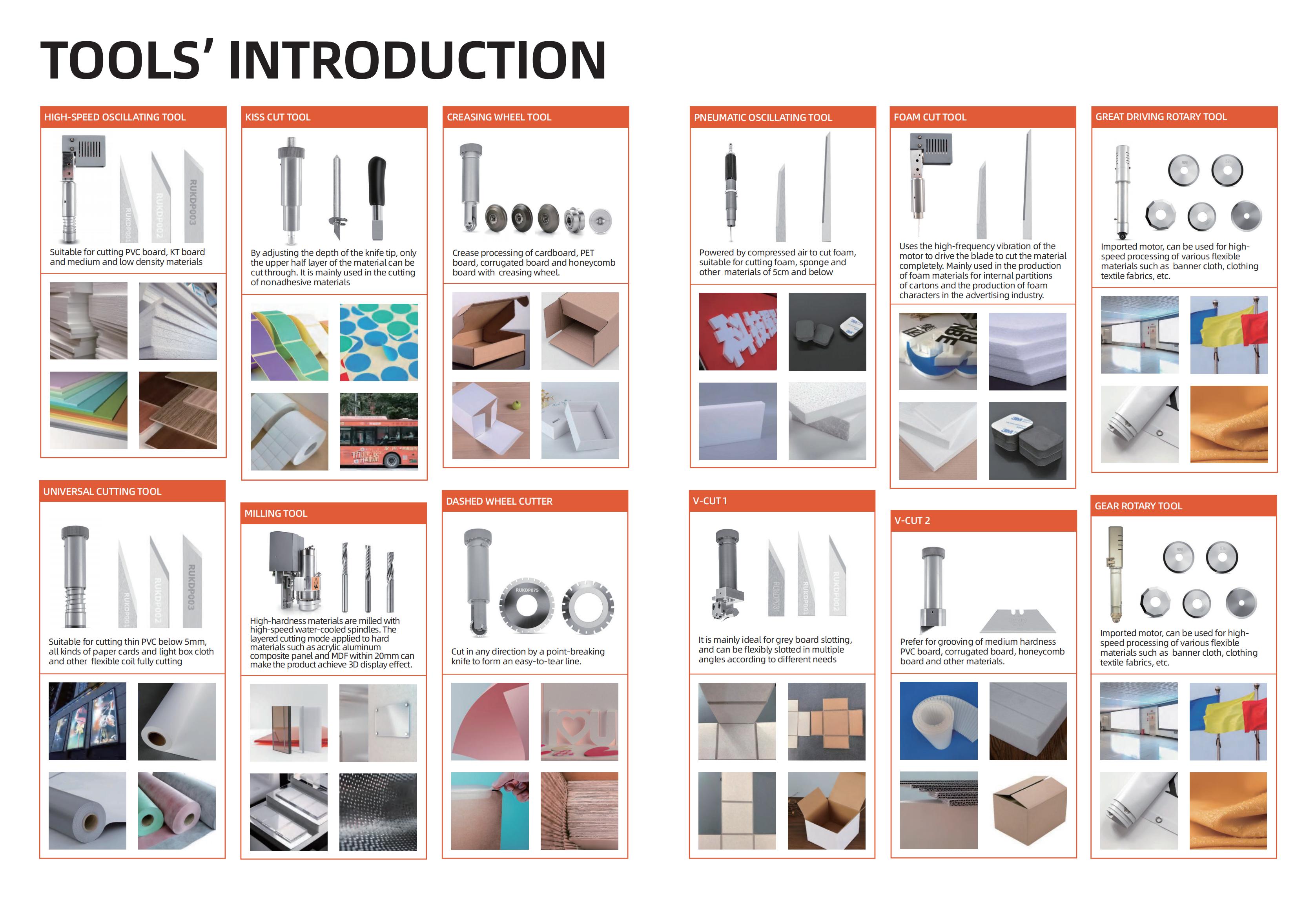

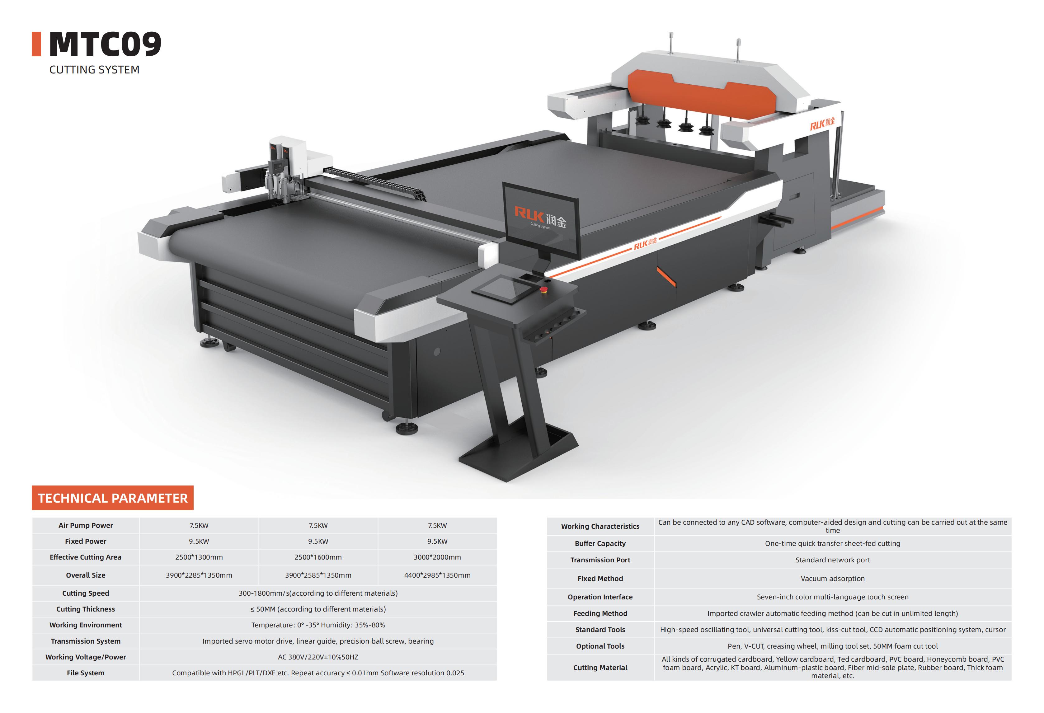

RUK flatbed digital cutter is pretty good for sticker cutting. Its system can be precisely used for full cutting, half cutting, engraving, creasing, grooving and marking. Meanwhile, precise cutting performance could meet the high cutting requirements. www.ruk-tech.com , [email protected]
