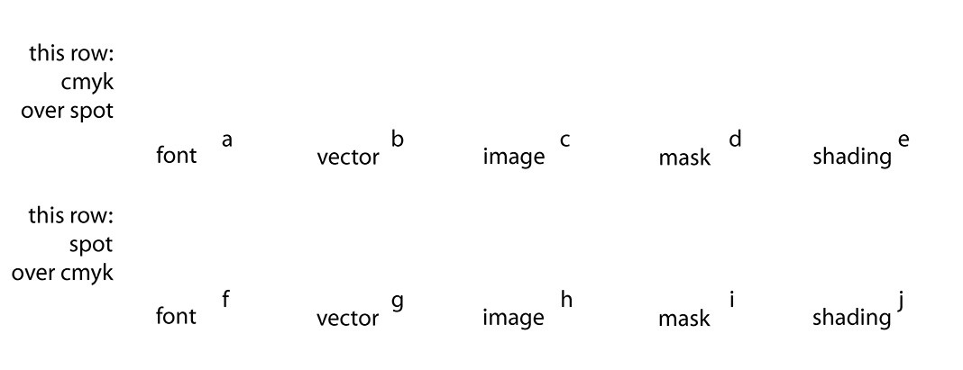

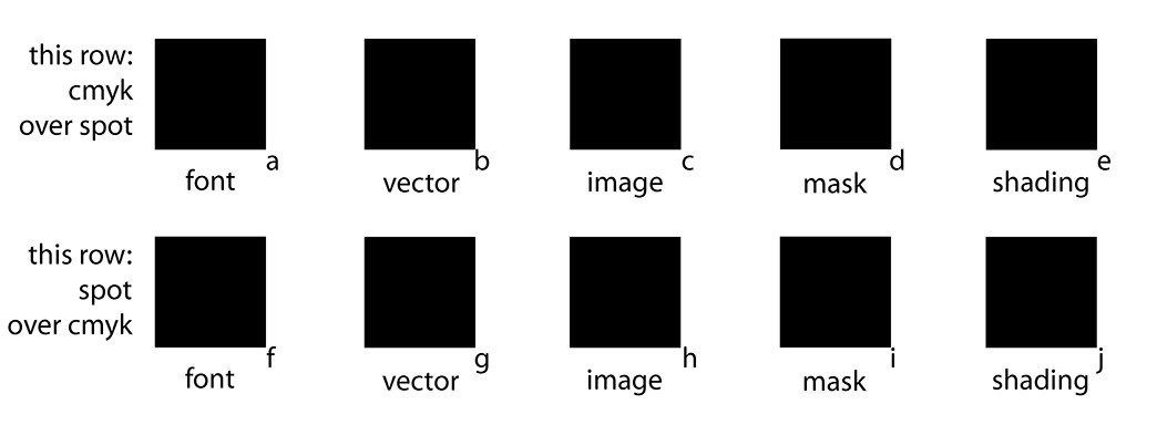

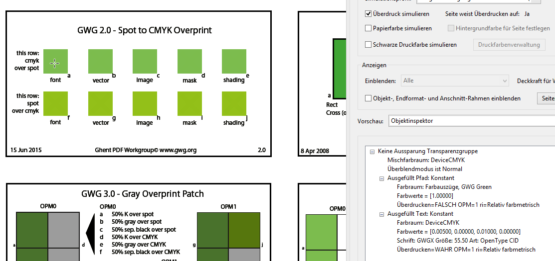

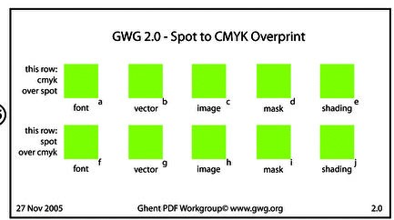

in the moment verifying our prepress workflow. Amongst others the overprinting behaviour. When using one of the common testforms (e.g. from Ghent group) and simply converting the green spotcolor to CMYK (via alternative color definition) the now CMYK-CMYK overprint (overprint=yes, OPM=1) leads to a knockout, which, given the actual channel values, is perfectly right (see first picture). When ripping the original file (with spot color still present) and omitting any separate spot color plate, thus converting by the RIP in the same way, there is still overprinting (see second picture, constructed from the TIFF/G4 files). Am I missing something or is this supposed to happen - although it internally is converted to CMYK?
yes, if you start with a spot color and convert that to CMYK, of COURSE C,M,Y and K would overprint !
Yes, glad you understand that ...
Yes, if the spot color is set to overprint, that would meant that plate is solid - and to "view" that you would need some method to "simulate" that on screen - as you could imagine, if you had a spot yellow color overprinting a 100% black - it would simply "look" blacker.

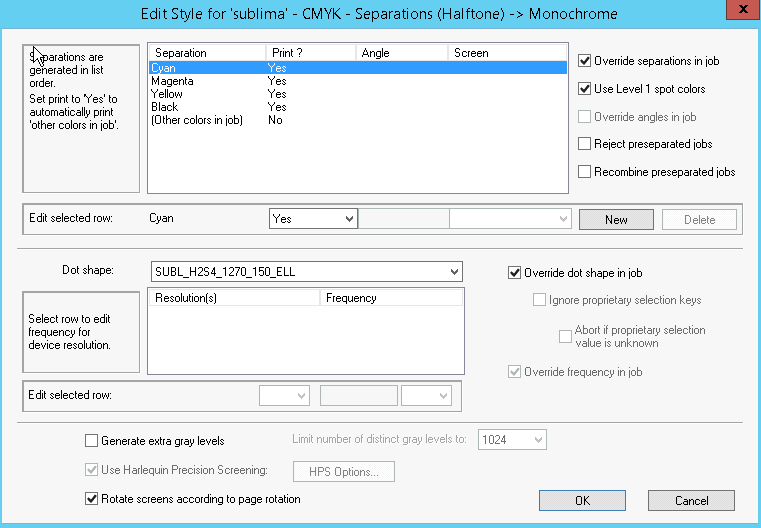

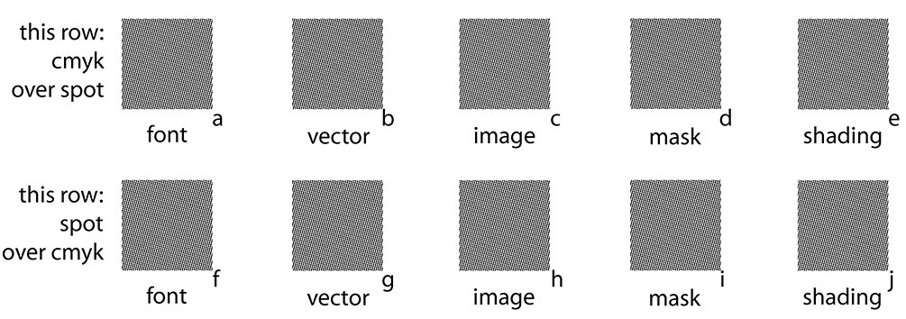

Many thanks for your answers so far. Sorry for the uncomplete RIP info. Our RIPs in the different print houses are all Agfa Arkitex RIP X ones (based on Harlequin MultiRIP 10.1 Revision 1), without ColorPro. Jobs are usually normalized* prior arriving at the RIP (OI is for Newspaper printing), with flattened transparencies. No spot colors. So a very controlled and limited environment, my checks are just to know where we stand. There are a few other "weird" things like overprinting behaviour with DeviceGray (see the color setup picture which should lead, in contrast to default behaviour of no overprint, to no knockout on CMY for images, but there is knockout as soon as an output intent is present in the file). But let's concentrate on the spot color thing first. I also attached the separations (scaled down from the original TIFF/G4 bitmaps created by the RIP). My picture in the first post was also based on these separations.

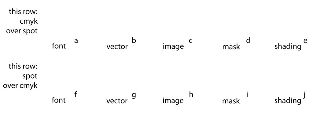

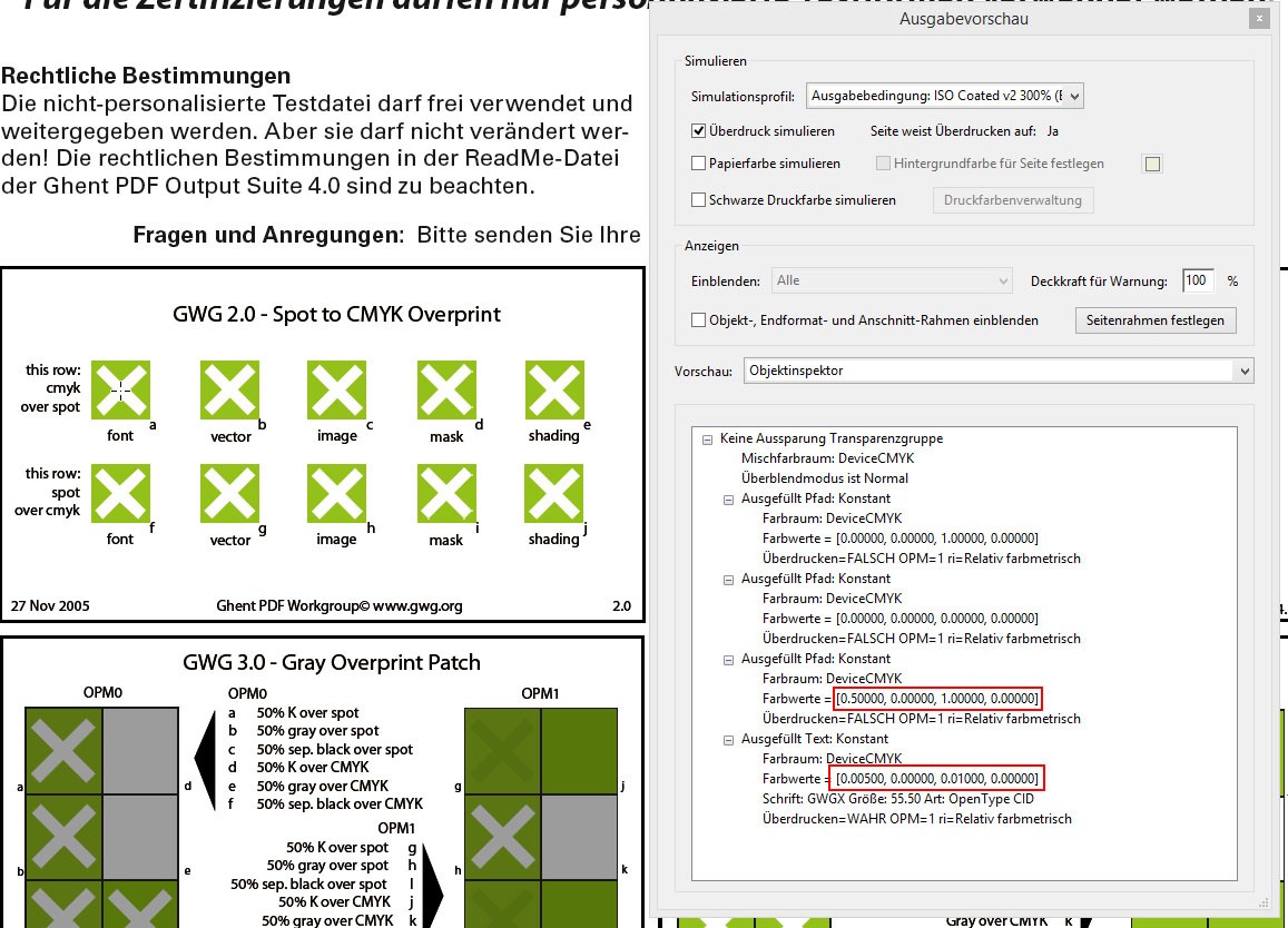

Here the separations (scaled down so raster is distorted but it can be seen quite good that it outputs 100% Yellow and 50% Cyan (disabled any linearization and process calibration), according to the alternate CMYK definition of the green spot color, and there is no sign of the "X" which has minimal channel value in Yellow and Cyan and lies above the former spot color. The behaviour is just as if the "X" would have 0 in every channel. But as you can see in the PDF, Cyan is 0,5% and Yellow 1%, at least when entering the RIP.

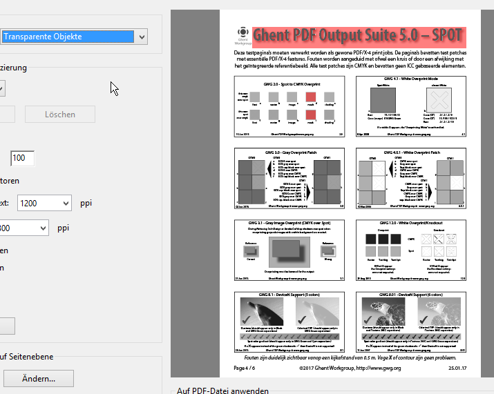

An update. The PDF/X4 testforms from Ghent Group have some additional transparency groups, besides the pages where actual transparency handling is tested. For the header (drop shadow) and the mask => OK. And there are no other affected objects. The inspector and preflight show non knockout subgroups for every object. Should do nothing but in fact when present, the above described behaviour arises. When I remove these groups, everything is as expected. So in the end still the question why the RIP behaves in that way when overprinting objects are encapsulated in non knockout transparency groups with no transparency effect enabled.
