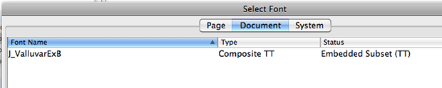

Indesign CS6 exported just fine.
see attached PDF and pitstop screen shot confirming embedded font.

Hi Alith
Pls check with my original required jpg image file and ur pdf still font missing...
Someone told some printer and ppd will sort out the issue ( i tried with scitex / linotronic / adobe /generic no improvement font missing only)
