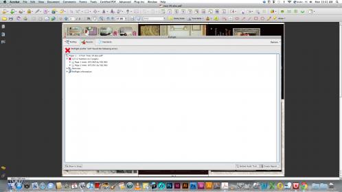

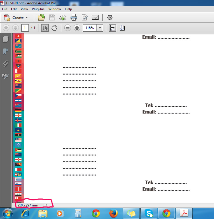

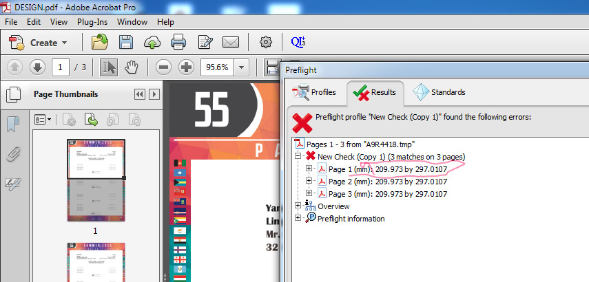

This is my attempt to use preflight
I dont know why it use three number after point ?
and why he see all files is wrong althogh i entered its size in width and hight ?
