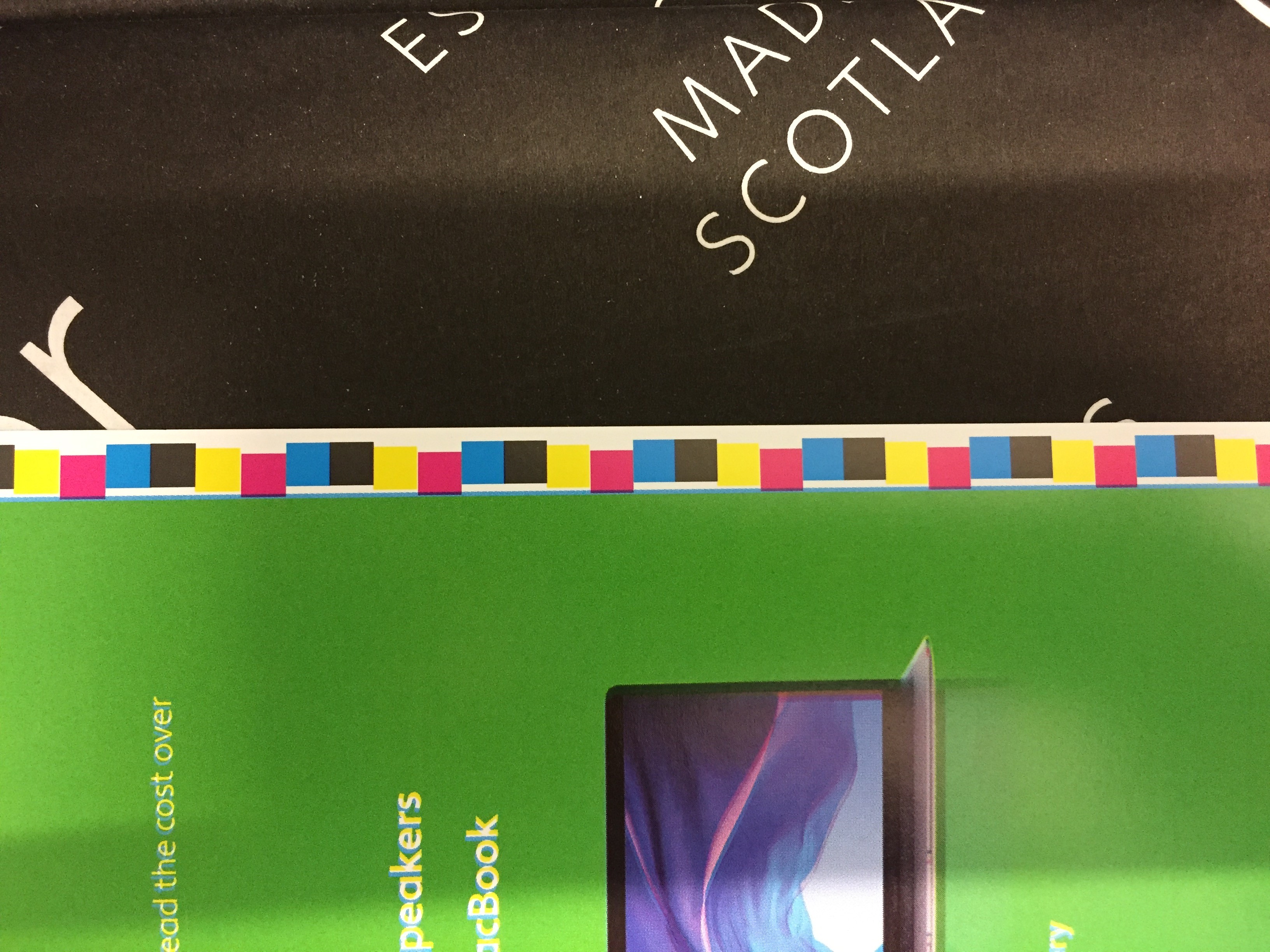

We have recently purchased a reconditioned Palladio II. When we are plating cmyk we are getting about 2mm variation in the position between plates. All the plates are straight. Any suggestions please?
