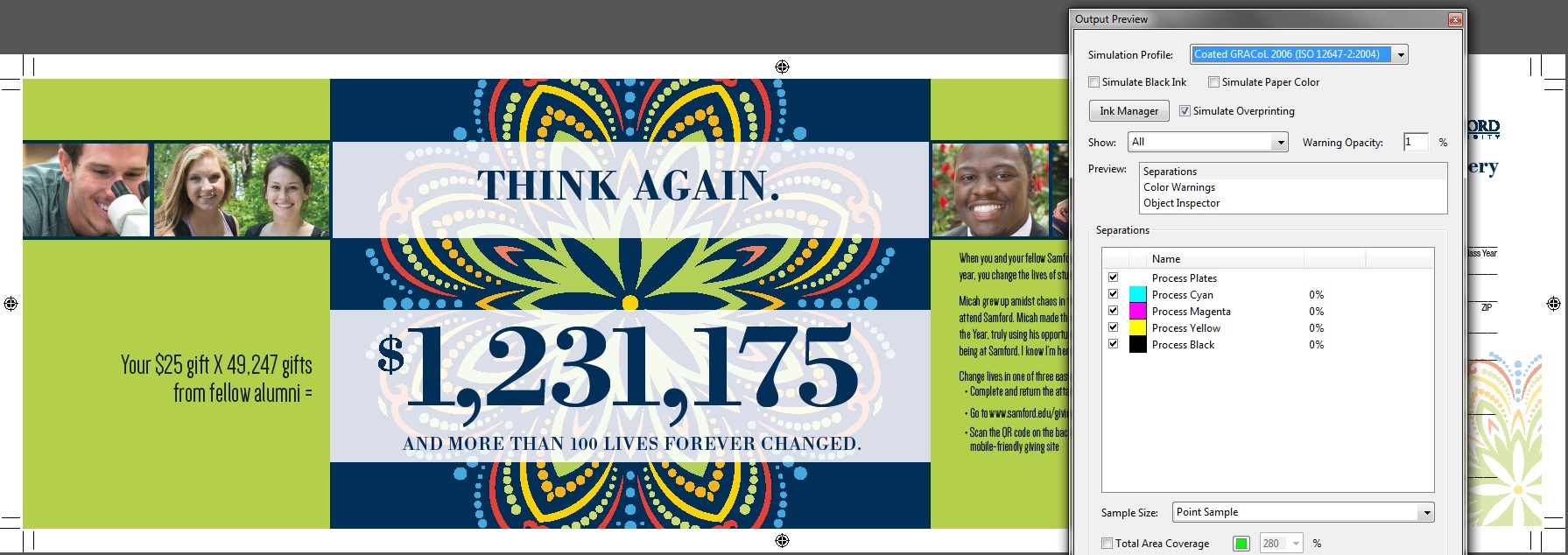

A lot of times when we normalize a file and then send a customer a PDF file for proofing, we do this either by "publishing to PDF" or downloading a high resolution proof from Insite, there are artifacts like chocked type (that being the most prominent artifact) in the post normalized PDF files. If we tell Acrobat to "simulate overprinting" then the artifacts go away. Many of our customers complain about these artifacts in the PDF files that we send post-normalizing. I can even turn off trapping or "remove traps" from the publish to PDF dialog and the artifacts are still there.

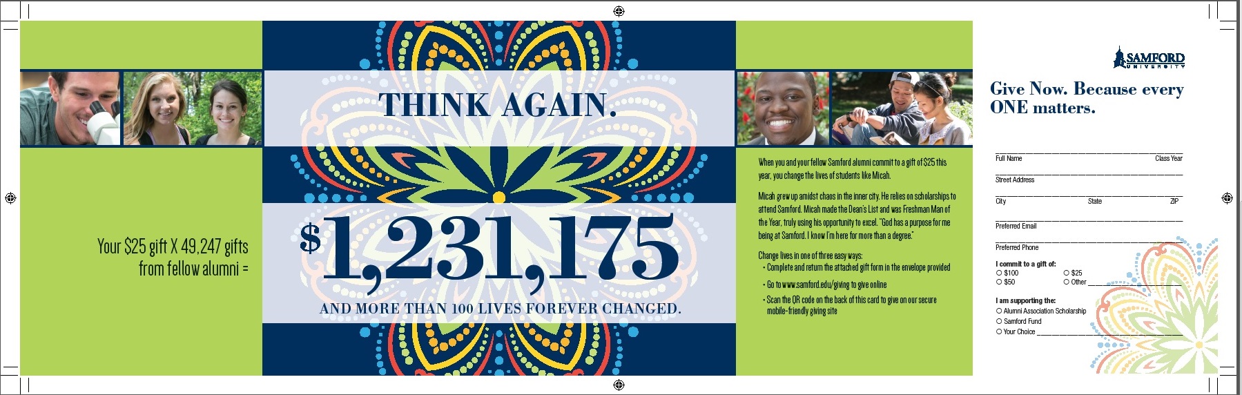

Here are 3 attachments. We do not flatten the PDF files during the normalizing process.

First thought...you should always have overprint showing if you want to really see what the file will actually look like in the end. I would tell those customers to turn on Overprint Preview in the Acrobat/Acrobat Reader preferences. I set mine to "Automatic" so it will show overprint if the file has anything set to overprint.
If under File format you have "Delete Traps" checked, this should not be happening.
I agree with Joe, overprint preview should be on for viewing PDF proofs from Prinergy or Insite. In Prinergy you have the option to delete the traps but PDFs generated and downloaded from Insite do not have this feature, at least not that I am aware of.
