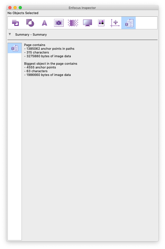

If you have PitStop, open the Inspector and go to this tab.
Don't select anything and it will give you some other feedback on the document.
This is from a file that is quite complex as an example, nearly 1.4 million nodes in a single A4 page.

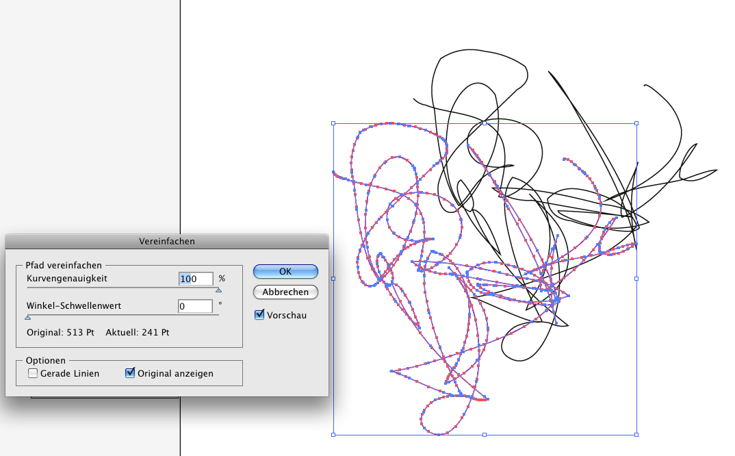

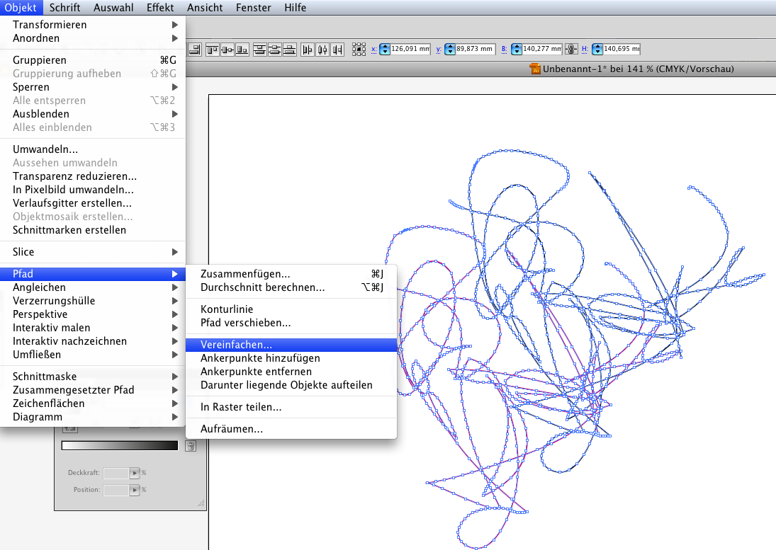

so, we do not know the file, but if the nodes are the reason and you do not have PitStop but Illustrator as you stated, give a try to this, if it is not allowed to send them to abc:
select all opened in Illustrator (black arrow, should does not matter when bitmaps will be selected also by that...) ->menue -> object-> path-> simplify with 100% and Preview

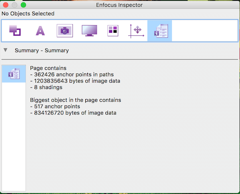

See the attached result from Pitstop:

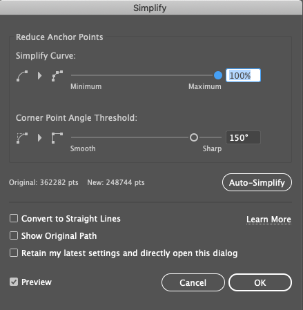

Just to isolate the problem:
Try simplify with a less quality (not maximum 100%, try 1% or/and activate „create straight lines“, no matter curves are not acceptable anymore, it is just for testing with the aim to reduce the nodes remarkable...
Which shading types are listed in a preflight report? (Make a screenshot please with the opened listing in the report. There are 8 shadings in rhe file...)

This does not match:
A few posts above it is reported there are 95 objects with more than 1000 nodes
PitStop info says there are only 517 nodes the most in an object
Looks like you have one image of 834 mb's.
Not sure how big the page is, but you should probably take a look at resolutions as well.
You might be able to reduce the amount of data the rip has to process
