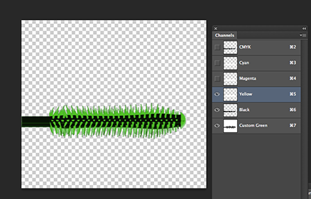

I have been supplied with the attached image.
I am working in a commercial print environment – this needs to print two colours (green uncertain of what PMS – but just call it custom green for the time being) and black – ideally it needs to be on transparent background.
The image I have been supplied has traces, very small traces, of the other process colours. Obviously I could just indicate to suppress these extra colours – but I would rather get it right. Could anyone advise on what would be the best strategy for removing these colours.
This is not really my line of work (in normal circumstances) – but I have tried deleting the other channels (which sort of works, but I lose my transparency) – I feel there is an obvious answer staring at me.
I just wish I knew what it was.
Help anyone?
Use Curves to remove the traces of ink in the CMY channels. Click on the CMYK composite channel, go to Curves, then on each individual channel (C,M,Y only) grab the upper right point and drag it straight down, so it will read Input: 100 and Output: 0.
This will remove all traces of ink on those channels.
Another way is to go to each channel and Select All>Delete. Don't delete the actual channels, just the pixels in the channels.

Erik - great idea. In fact, I was going to suggest a similar approach when I looked at the OP's screenshot and he already has the K and Spot channels in place - he's just trying to eliminate all pixel data that remains on the CMY channels (seems there's a few rogue pixels hanging around.)
