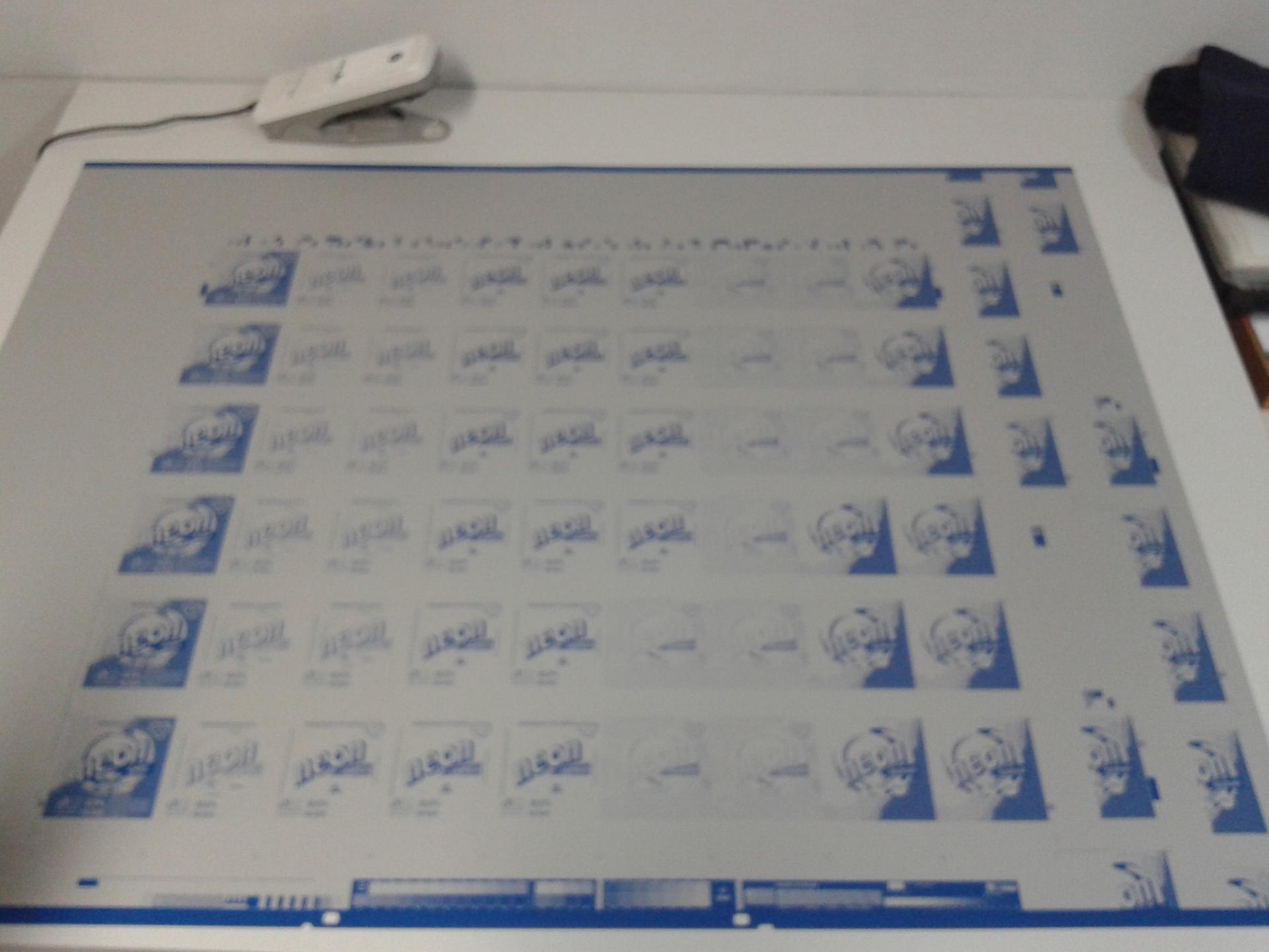

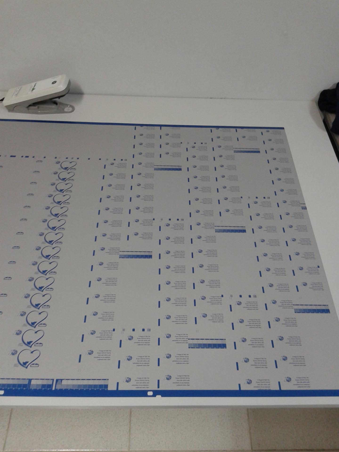

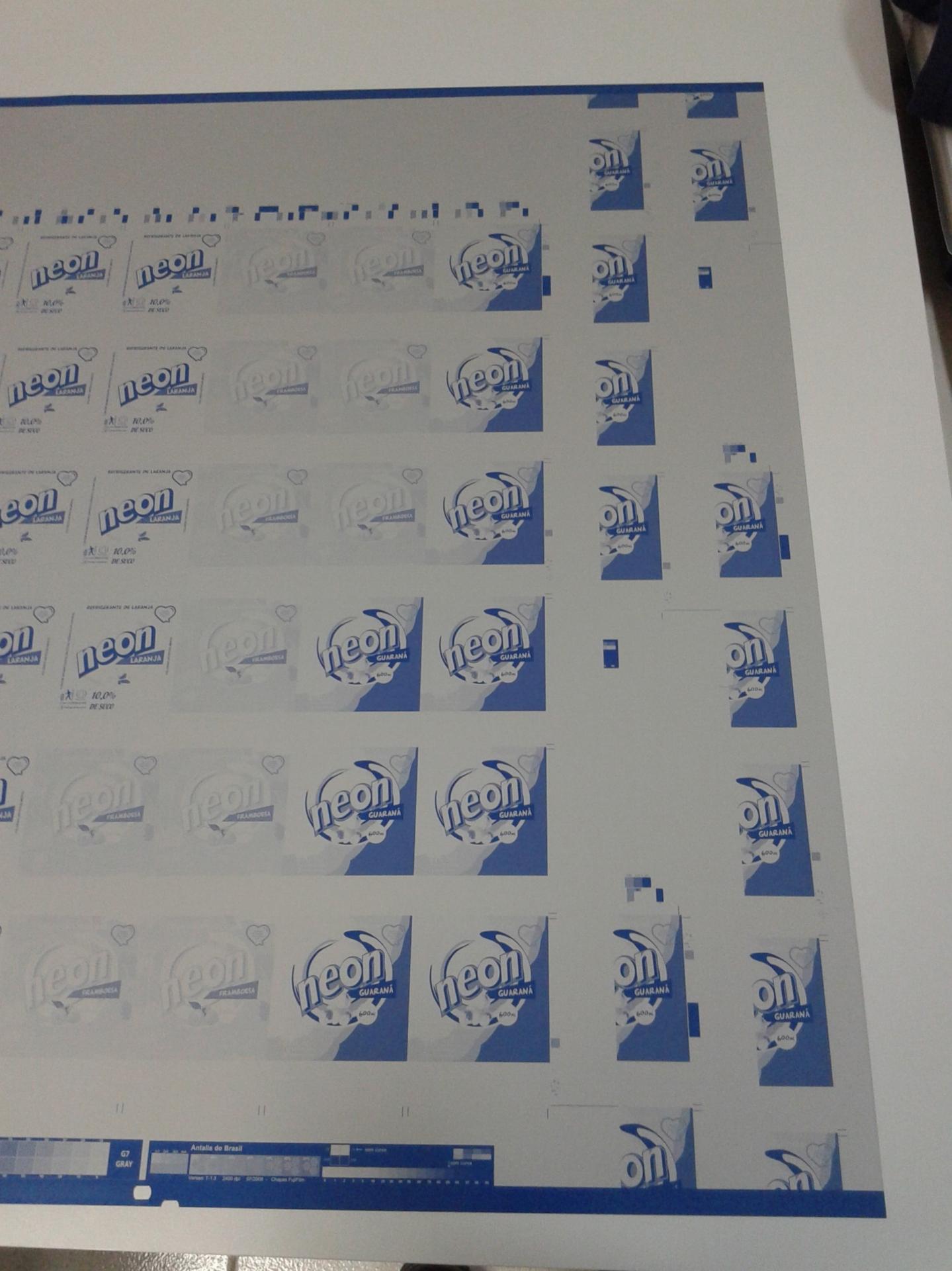

Pieces of image repeat uncontrollably on the plate.
Something strange is happening, pieces of images began to be recorded uncontrollably on the plate.
Strange that the assembly preview is correct.
Has anyone seen anything like this?
Hi Michel
Can you supply more info?
1) What Rip are you using
2) Are you using a tiff catcher to drive your CTP
3) What CTP device are you using
Marc
Hi Marc.Ram !!!
Here is the information:
Express RIP (Harlequin RIP 8.1 Revision 3)
2) Are you using a Tiff catcher to drive your CTP
No, my CTP is connected directly to the PC through the PIF input.
Plate Rite 8100
NOTE: Windows 7 Professional 32 Bits
Thank you very much for your attention.
try to test some built in tests (from the ctp itself)
my opinion bad contact or damage card
I second pam_add's suggestion. If those tests do not imply a problem with the platesetter, try testing remakes of the same plate starting at different points in your workflow. I would start at the end - tell your platesetter to make 2 copies of the same plate if that's possible. If it can plate twice without the RIP having to send it the image twice and the plates don't match you'll have it narrowed it down to the platesetter's data processing. If the RIP has to send it twice you'll have it narrowed down to the platesetter or the communication between the RIP and the platesetter. At the beginning of your workflow, you could recreate the job from scratch and see if you get a matching plate. If you get unmatched plates when remaking from a given workflow step and identical plates from the step immediately following, the error is probably being caused somewhere between those two steps.
