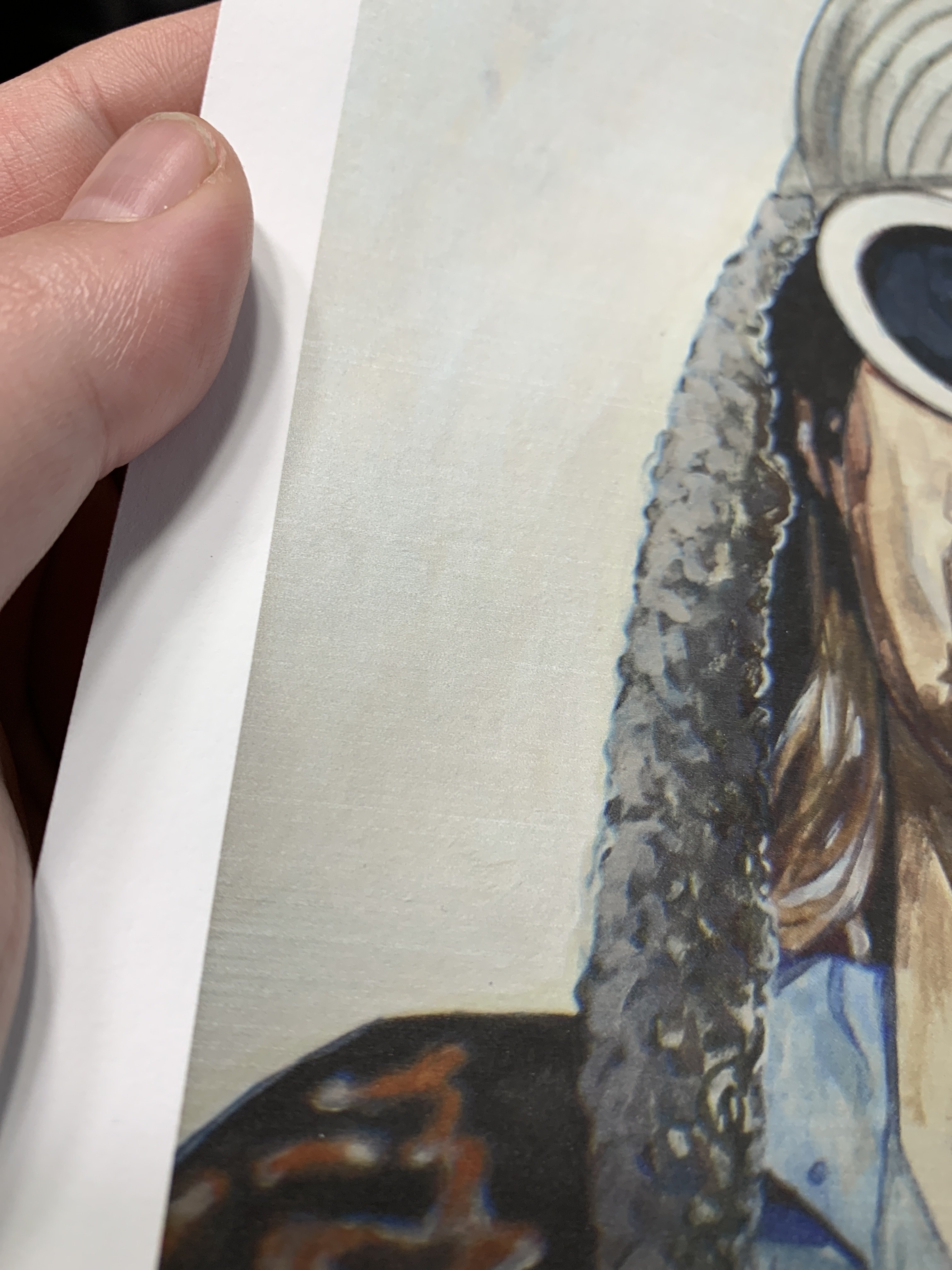

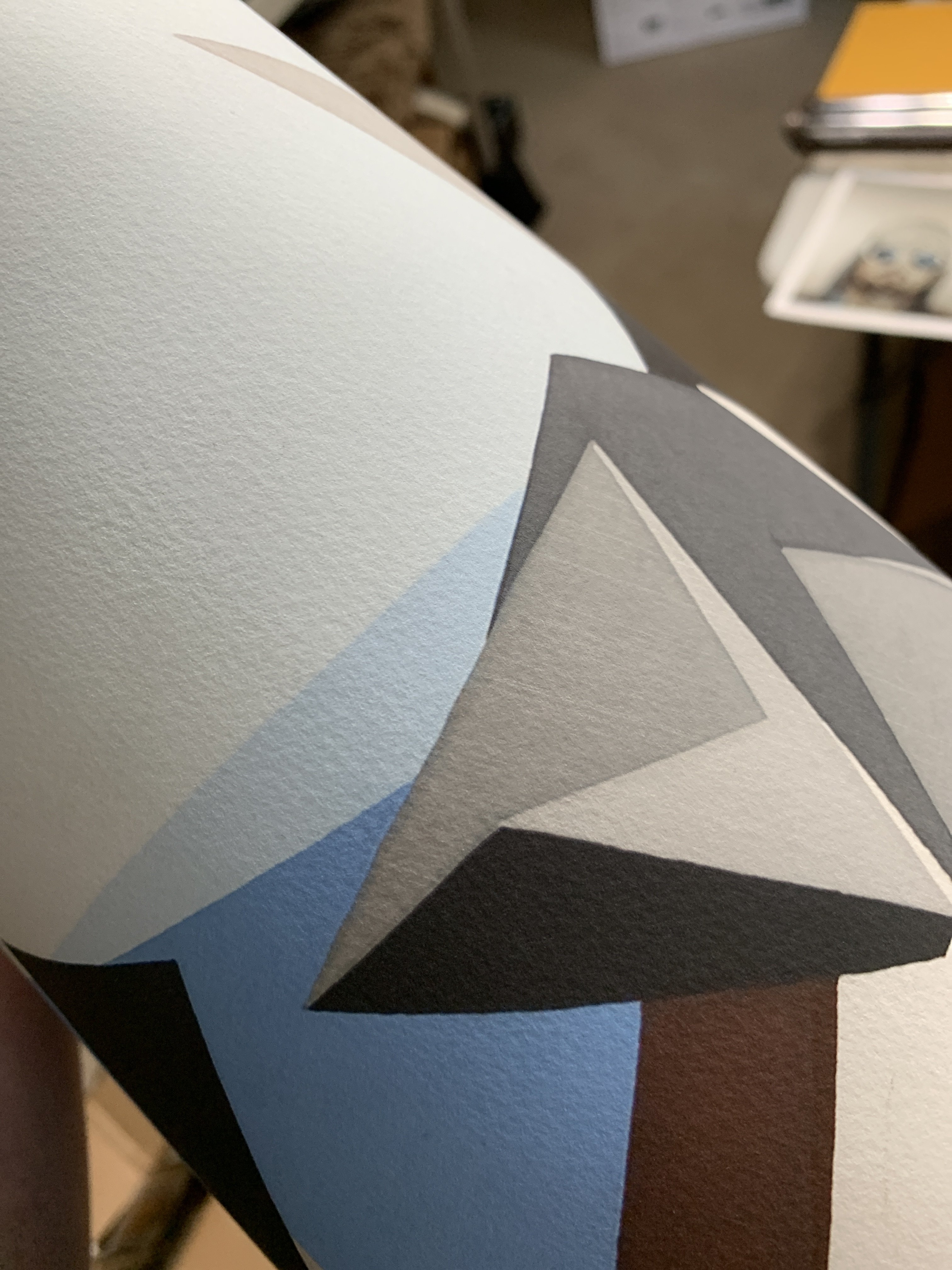

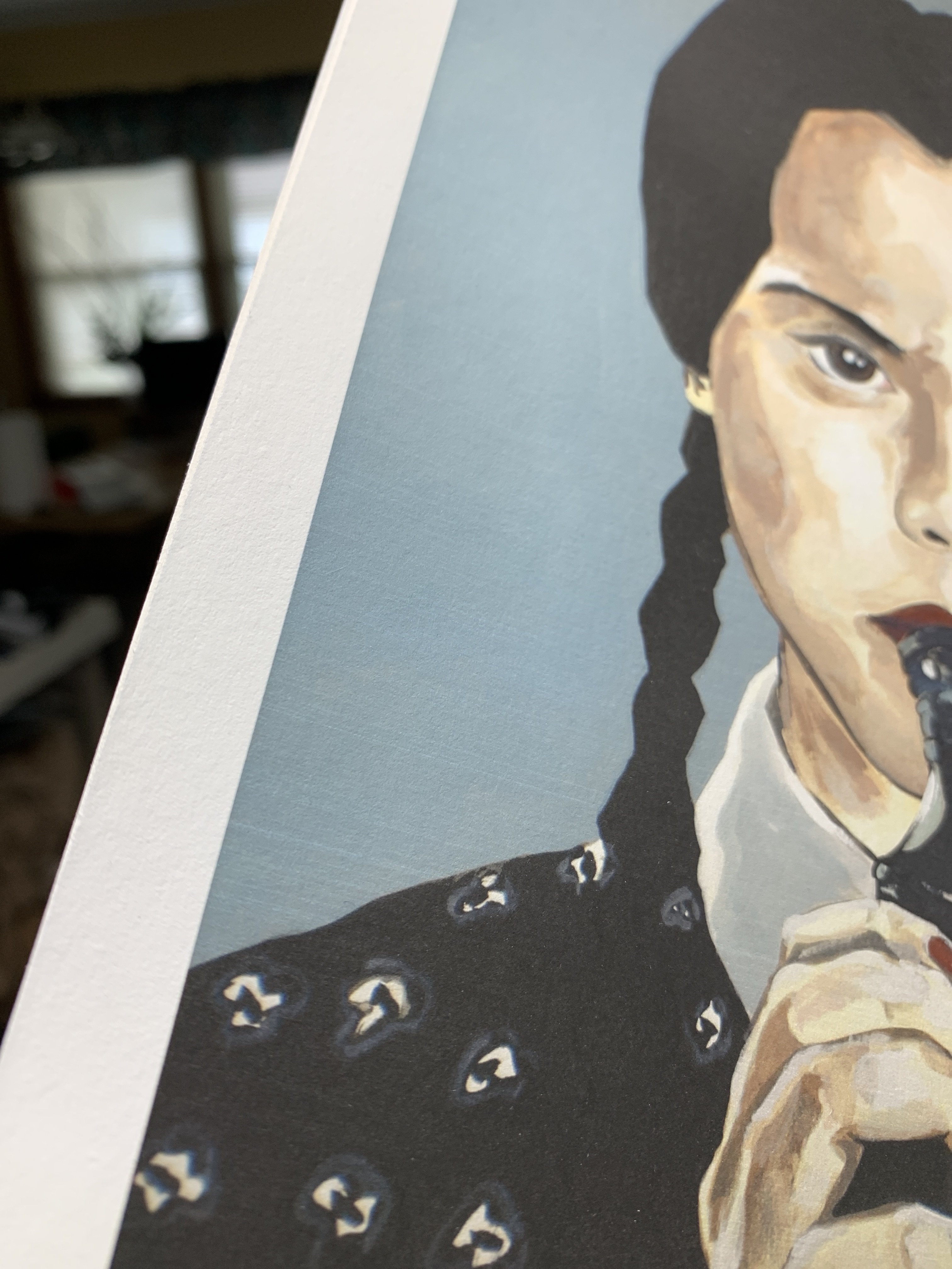

This is definitely different than banding. I’m getting pinstripes of no print on the side closest to the printhead carriage resting spot. Has anyone dealt with this? I’m losing prints when I do multiple up on that one side.
Pictures of occurences

What is the printer make and model and are the bands parallel or perpendicular to the paper feed direction?
HP Z3200ps, parallel. Less so much “bands” and more thin pinstripes that are heavier on the print carriage resting side and thin/disappear as the printhead carriage moves outward.
