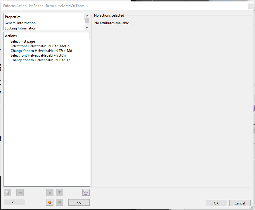

I have "Select First Page", then select & replace the necessary fonts. Even though only one page (first page) ever gets selected, it still processes the entire document. I know I can change "Run On" to current or selective page number, its extra clicks i'm trying to avoid, plus the oops factor of forgetting to change it.
Your problem is actually coming from your selection and how you believe it works.
When you do:
  • Select first page
  • Select font
You actually change the first page selection to the font selection that can be found anywhere.
Hence your problem.
What you need here is to tie both selections with a AND operator.
  • Select first page
  • Select font "xxx"
  • AND
  • Change font
Then changes will only occur on page 1 given that "Run on" is set to work on complete document, or if current page is first page, or if Page range is set to 1.
In other cases, nothing will happen.
Loic

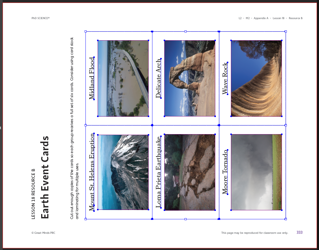

@loicaigon Here is the problem I run into over and over again with files I receive from our science department. I need to constantly crop out "cards" off a page, then immediately turn around and treat the individual pages where the remaining content is removed and media\trim boxes are changed to the selection. Otherwise as "croppied" pages in a document to either split (tile) them into individual cards, Quite Imposing will reveal the hidden content and improperly separate the cards. This is my Workflow as it stands:
  1. Select "Cards" on the page:
  2. Change to "User Selection":
  3. Crop to Selection:
  4. Repeat Crop to Selection for all pages in document...
  5. Change back to "Complete Document"
  6. Perform cleanup operation that removes extraneous objects and modifies Media\Trim Boxes for all of the pages
Since the process of selecting the cards on a page can't really be automated... Sometimes each page will have a different number of cards, often they are on different areas on the page, and sometimes they are different sizes. But if I could complete all of the above on one page instead of multiple steps
Now having to tile each page individually in Quite Imposing is a task in itself... but I digress.
"Since the process of selecting the cards on a page can't really be automated..." I see in your picture that there is a kind of a dotted line around images, couldn't that used to select your cards?
Feel free to send me a PDF at loica at enfocus com.

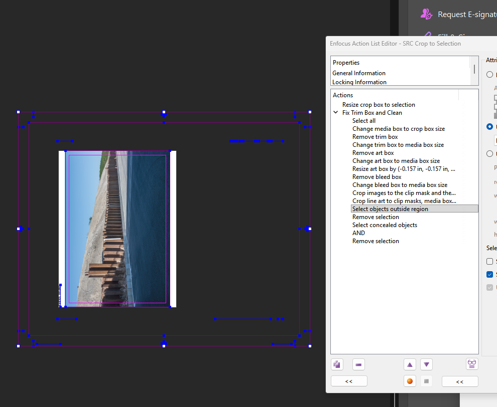

I tried combining the two operations, but actions like the removal of objects outside of the media box are ignored because they aren't selected and thus not removed. After resizing the cropped page, if necessary to unify card sizes, content that should have been removed is being revealed.
Based on the files you sent me, I believe this is perfectly doable. The thing is that you have images that are some alone, others accompanied by a title.
Both cases can be covered by
Select texts [2 actions for font +point size]
Select Images
OR
Then resize;
That will resize to images and title if found.
