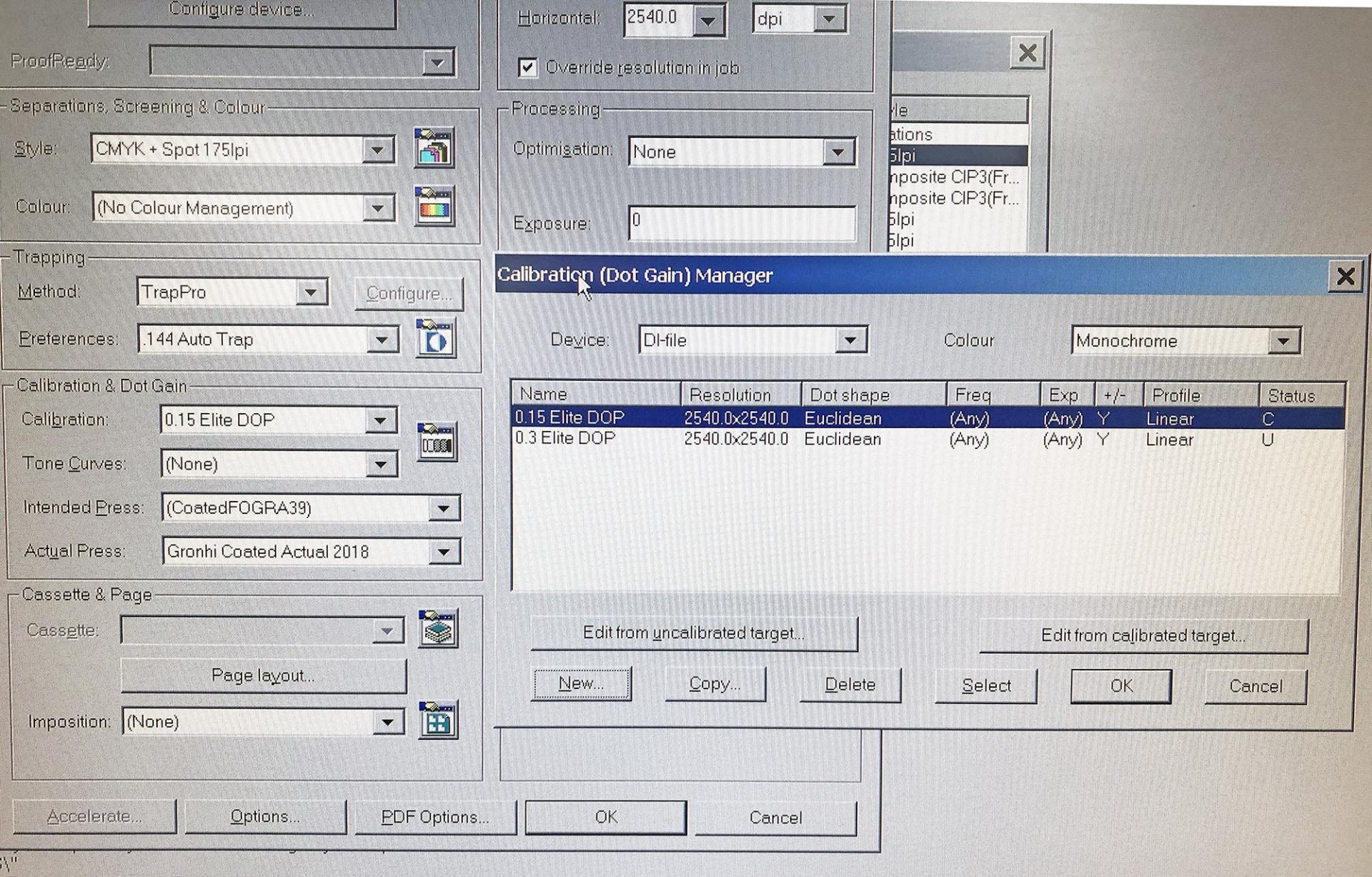

Here is a screenshot of the RIP interface...thought it might help to visualise the process!
Good idea to post a screenshot: I notice by viewing it that my memory fools me!:
I have mistaken left and right concerning the Buttons "Edit from calibrated target" and "Edit from uncalibrated target" in my postings above...

What you do - if your plating is consistent - is to:
1 have a target - a desired tone reproduction in your presswork
2 output your tone patches to your plate. Do not apply any curves. It is preferable not to include images as that may confuse the press operator.
3 run on press at your target densities/Lab values or whatever
4 measure the tones in your presswork.
You should be able to enter the tone values you got in your presswork into your RIP. The RIP then compares what you got to what you wanted and using that data builds a compensating tone curve that remaps the tones in your source files so that they will deliver your target tones in your press.
5 do a confirmation press run with the compensation curve calculated by the RIP
6 Celebrate success
NB you can see a more detailed version of the process here: https://the-print-guide.blogspot.com/2010/02/principle-of-dot-gain-compensation.html
that is exactly what Andy did already with curve 3 (Target/Intended press) and curve 4 (press curve via left button “Edit from uncalibrated target”) and what leads him to a result 5-8% above the target.
The only difference to your recommendation is that he uses a linearization (curve 1), too, which really does not matter in this case. It is for sure not the effect of the linearization curve what leads him to a higher result as aimed in the harlequin dialogue ...
6 Celebrate success
That is what he want!

So i am thinking the best (and simplest) approach would be to...
1.) Run a set of plates with no settings in any of the curves.
2.) Measure the values of those plates.
3.) Adjust accordingly using a single tone curve.
4.) Repeat step 3 if required further.
It completely makes sense to just adjust at the end of process...so much more efficient.
Also thank you Ulrich for recommending ESKO i shall take a look...but in the mean time i have managed to configure a page setup to output TIFF's that i can view in Photoshop, this alone is very useful in seeing how any adjustments affect the output from the rip before it is plated.
Apologies I misled you in this message...
when i said measure those plates I meant measure those values of that plate when printed.
i beleive we are now talking the same method
