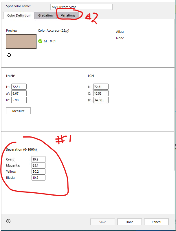

If the source object is RGB/CMYK instead of spot, create a custom Spot Color in Spot Pro. (I think there is even a "replace color" option, I haven't used it years?? I'll have to re-research)
Tweak the Spot Color until it matches, then you will need to edit your source PDF with something like Pitstop Pro and replace the solid color with the newly created custom Spot Color.

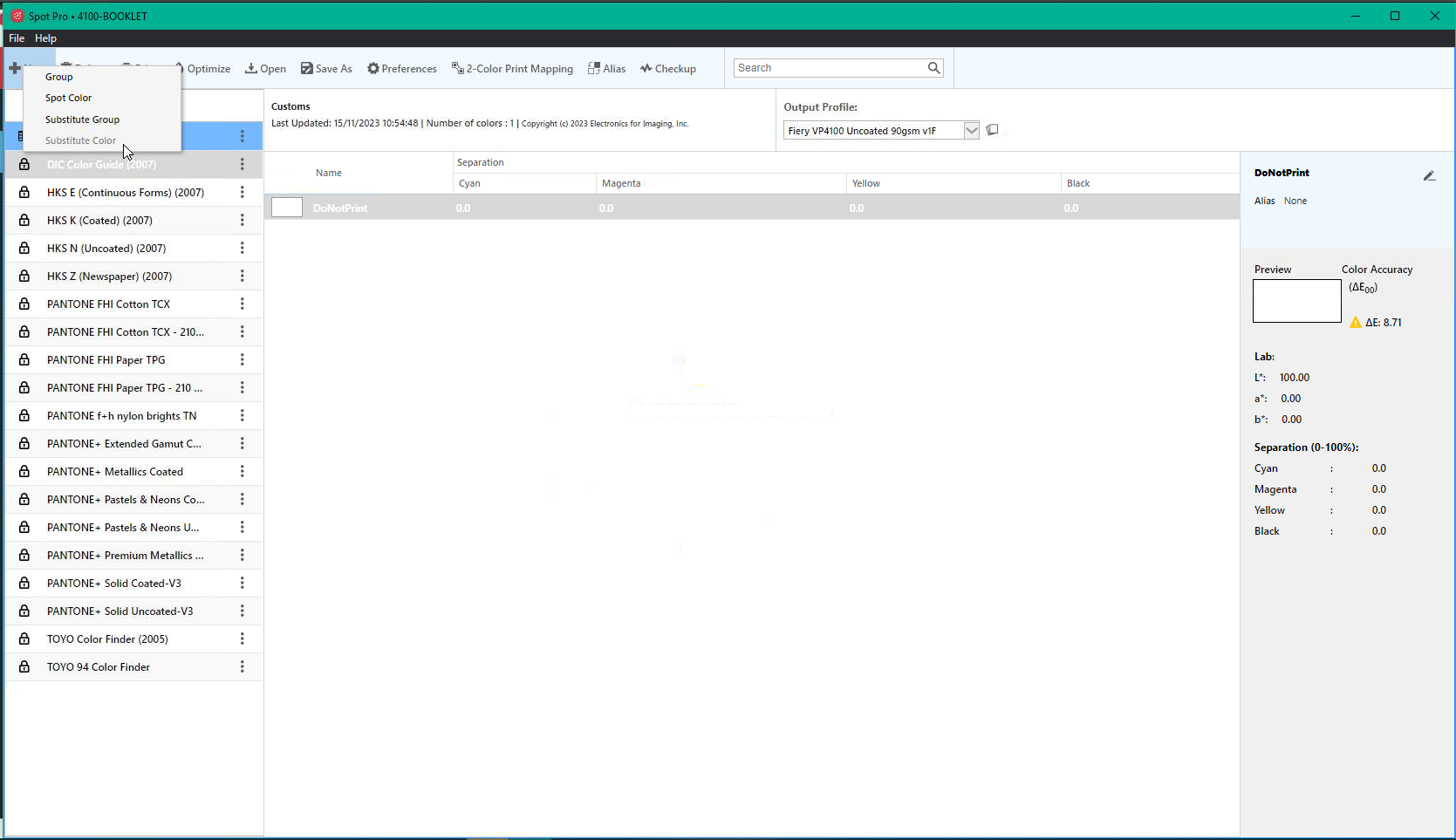

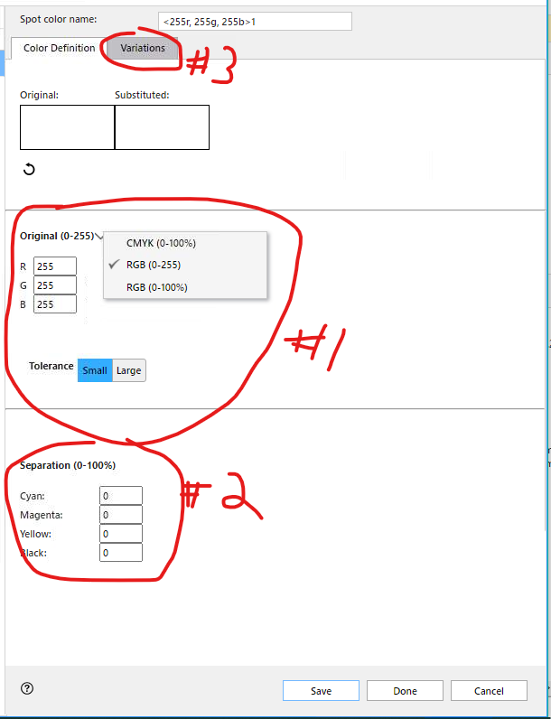

Create "Substitute Group" give it a name, then Create "Substitution": You will need the exact source RGB or CMYK of your object, enter a new CMYK replacement color, then #3 under Variations you can tweak the actual output of your replacement color.

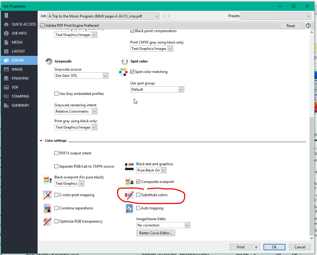

In your print job on the Fiery you need to turn on Substitute Colors

Why not just select the Spot Group under "Use spot group:" instead of Default?

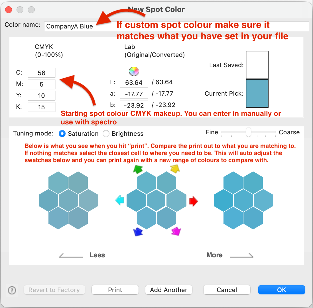

Personally if the colours are Pantones or spot colours I would make a new library for the client so whenever the job comes it uses a specific profile. This would mean the file has to use the specific spot colour or Pantone colour. Use a starting CMYK makeup, I generally just use what I see in Indesign and do the rest on the press.

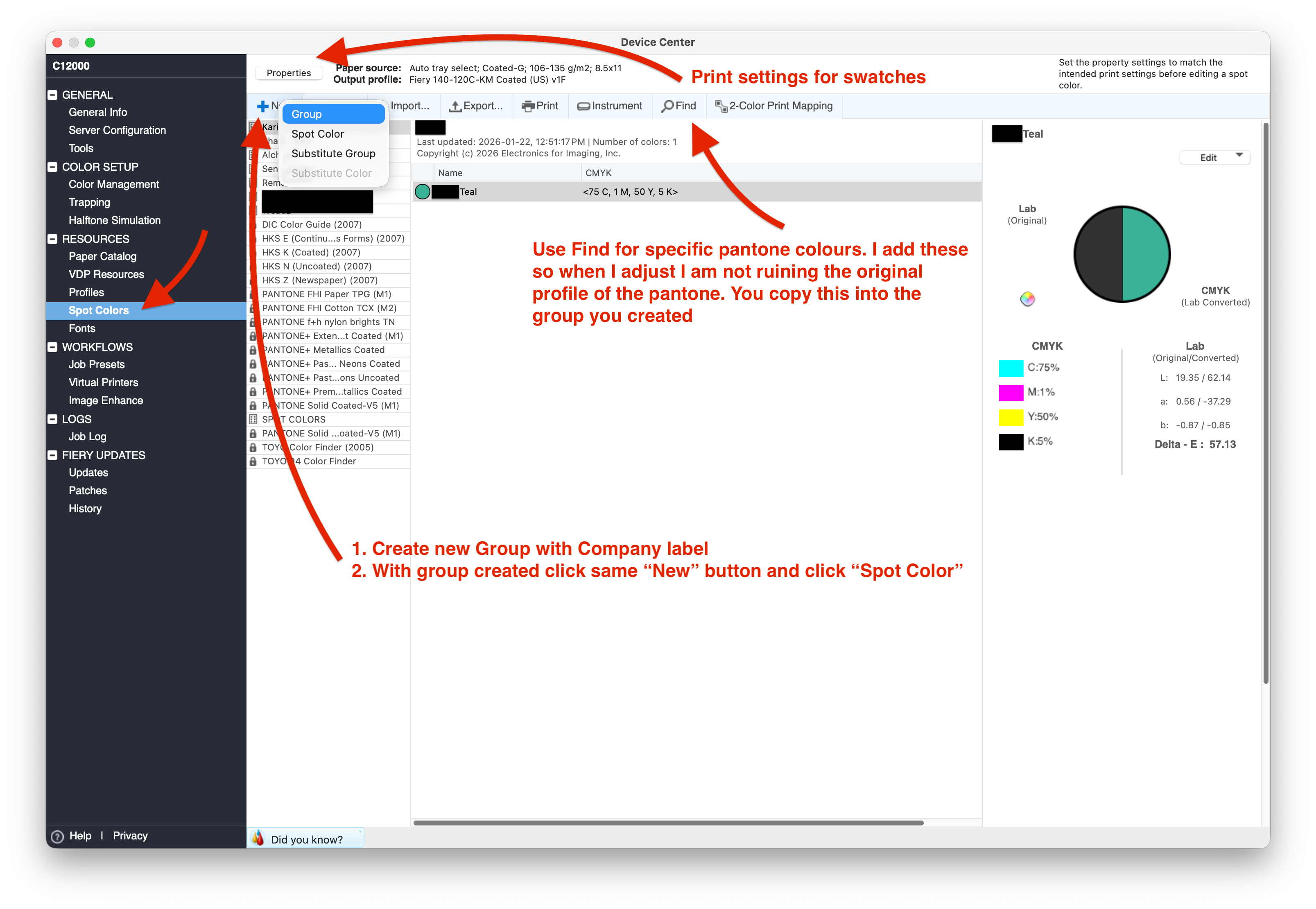

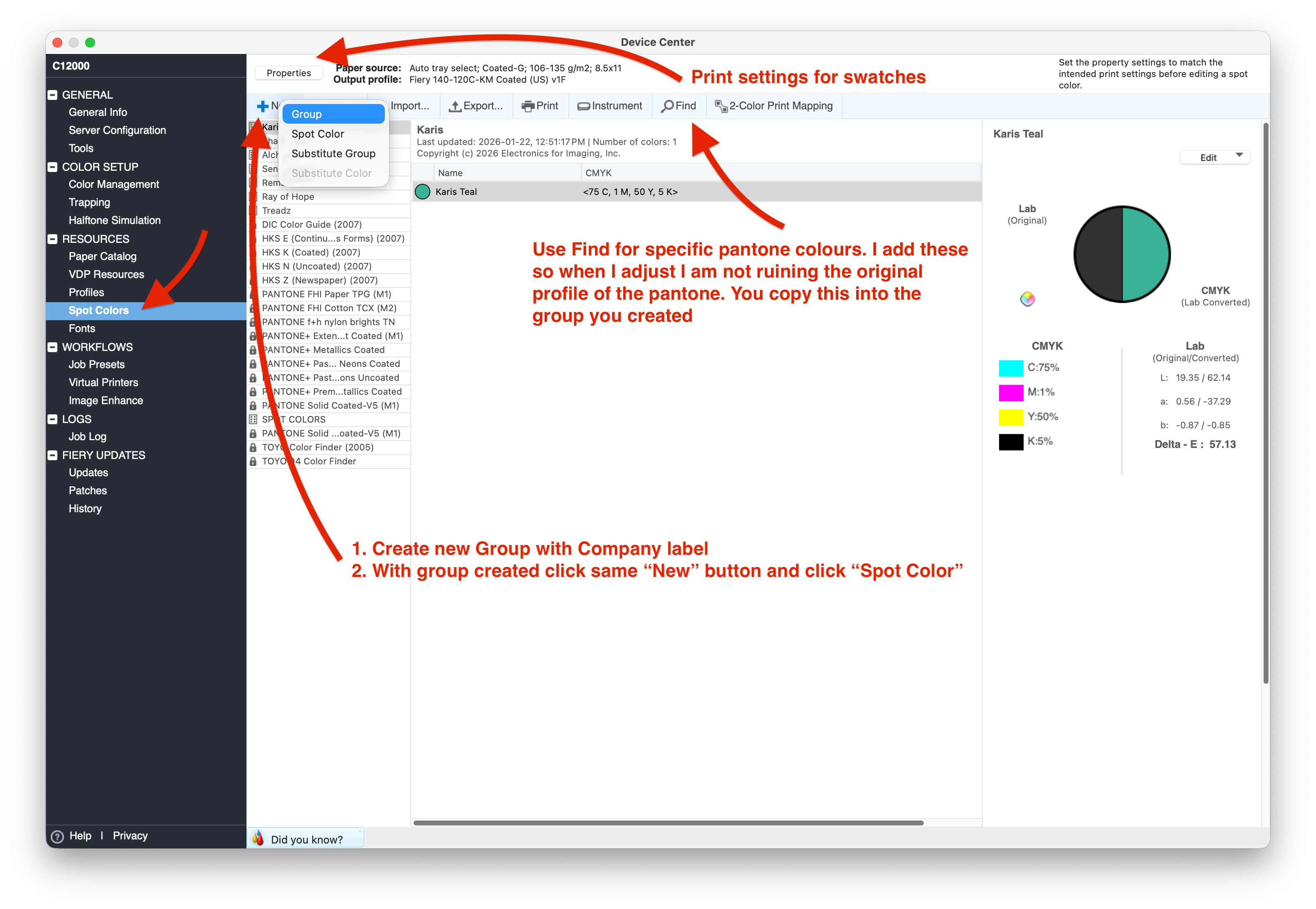

Same area EdwardB was in. Go to Device Central > Spot Colours.

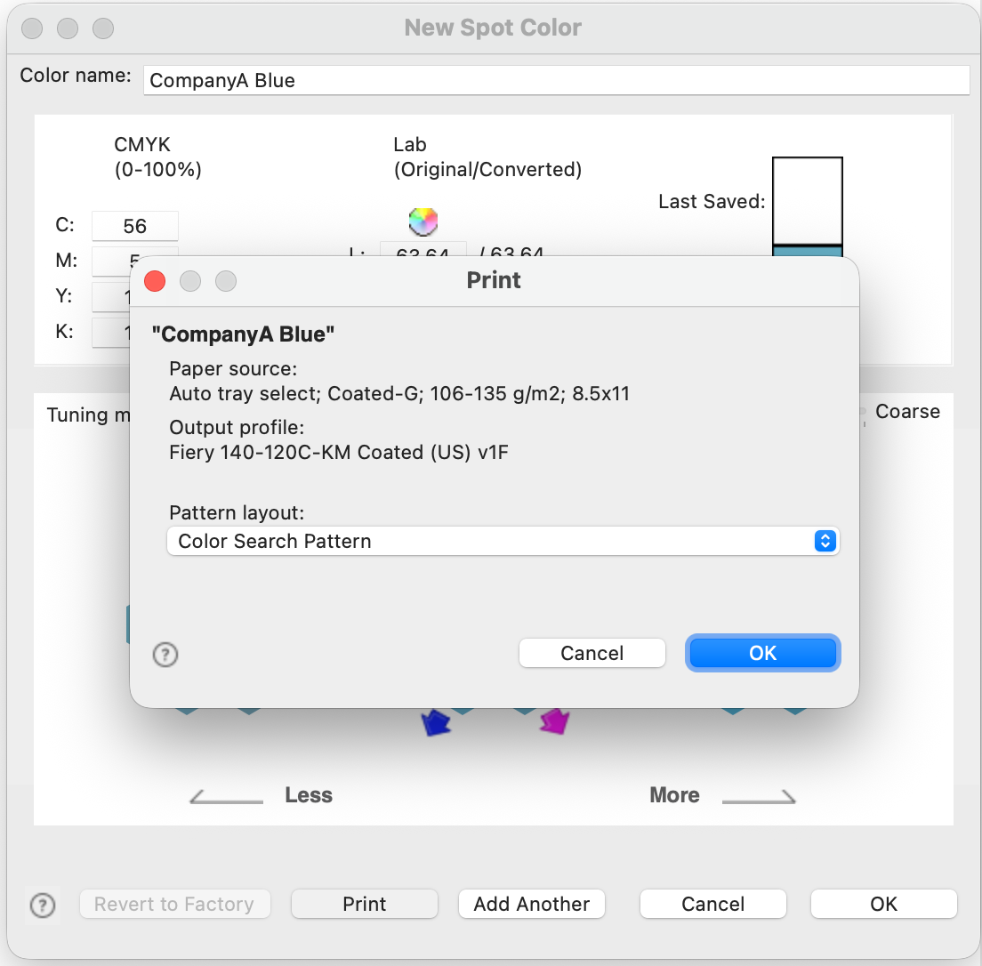

In there the first thing to do is select "Properties" This will be at the top. In here is you basic print setup, you need this for when printing colour swatches for matching. With that done you make a new "Color Group"
I think of these as playlists in iTunes. I have ones setup for different clients that I need specific colours to constantly match.
You create this new Color group and you can either search for the Pantone you need or just create a new spot from scratch and enter

I found this the easier way to do colour matching. Regarding the spot colour groups, the Fiery software starts looking through colours from the top of the list and works its way down. In the past I have had adjusted Reflex Blue for a specific company, so to not have it used when not needed I would need to move the libraries around. So if 2 groups have Reflex Blue, I move the one I want to the top of the list.

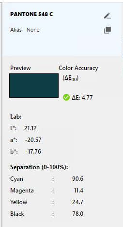

interesting... my Fiery Spot Pro lists 548C as 90.6, 11.4, 24.7, 78.0
more interestingly the Delta E... of 4.77! Basically it'll never match the Pantone Coated book.
Do you guys realize the CMYK values listed in Spot On are the values that are sent to the printer/specific papers. They really have nothing to do with the colors listed in any spot color book. Yes the libraries have the lab values which the printer paper output profile uses to determine the values sent to the printer. Check different printer paper output profiles and you will find Spot On will have different CMYK values for different papers and different profile creation settings.
This is why you should visually choose (from a book) a named spot color you want. What adjustments you want or need to make to match that color as close as possible should be done in Spot On affecting only the color output to the printer values.
