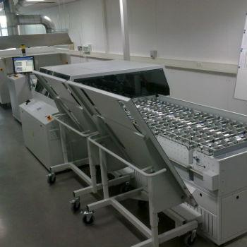

Take a look at this image from Nela. Something like this might suit your needs (or if you have a handy man, he could build you something?).
pd

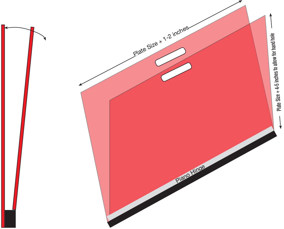

What size presses are you running, it shouldn't be too hard/expensive to make a protective sleeve that could easily be carried to and from the pressroom, see attached drawing. Adapt to your plate size and you could add stops at each end to prevent the plates from sliding out and or add weatherstripping to hold them inside if needed . . .

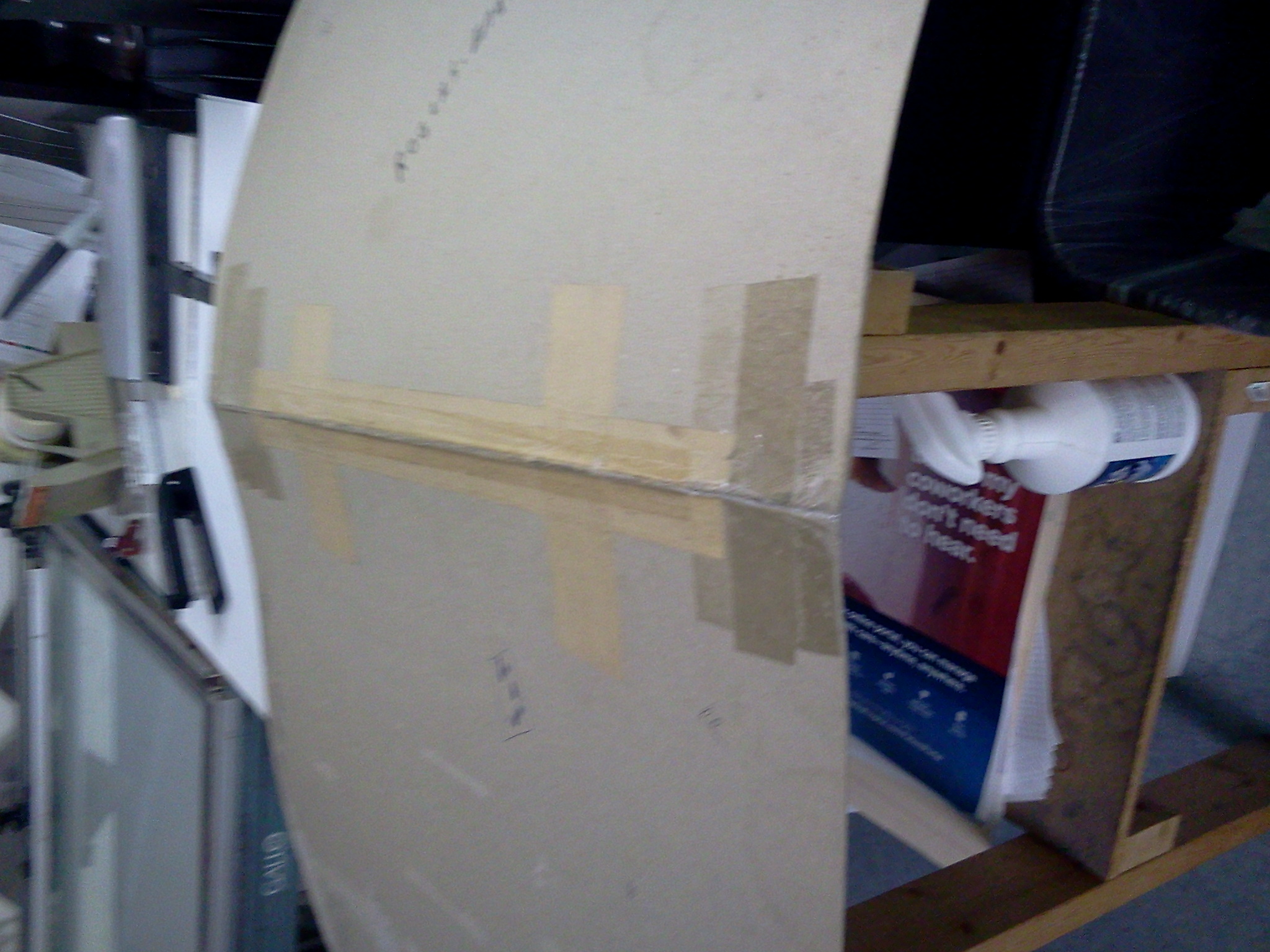

Chipboard - Double Thick - .080 - 32x40 Cut this down to the size you need 2 of them and tape them at the center on both sides. We have used this for years.
