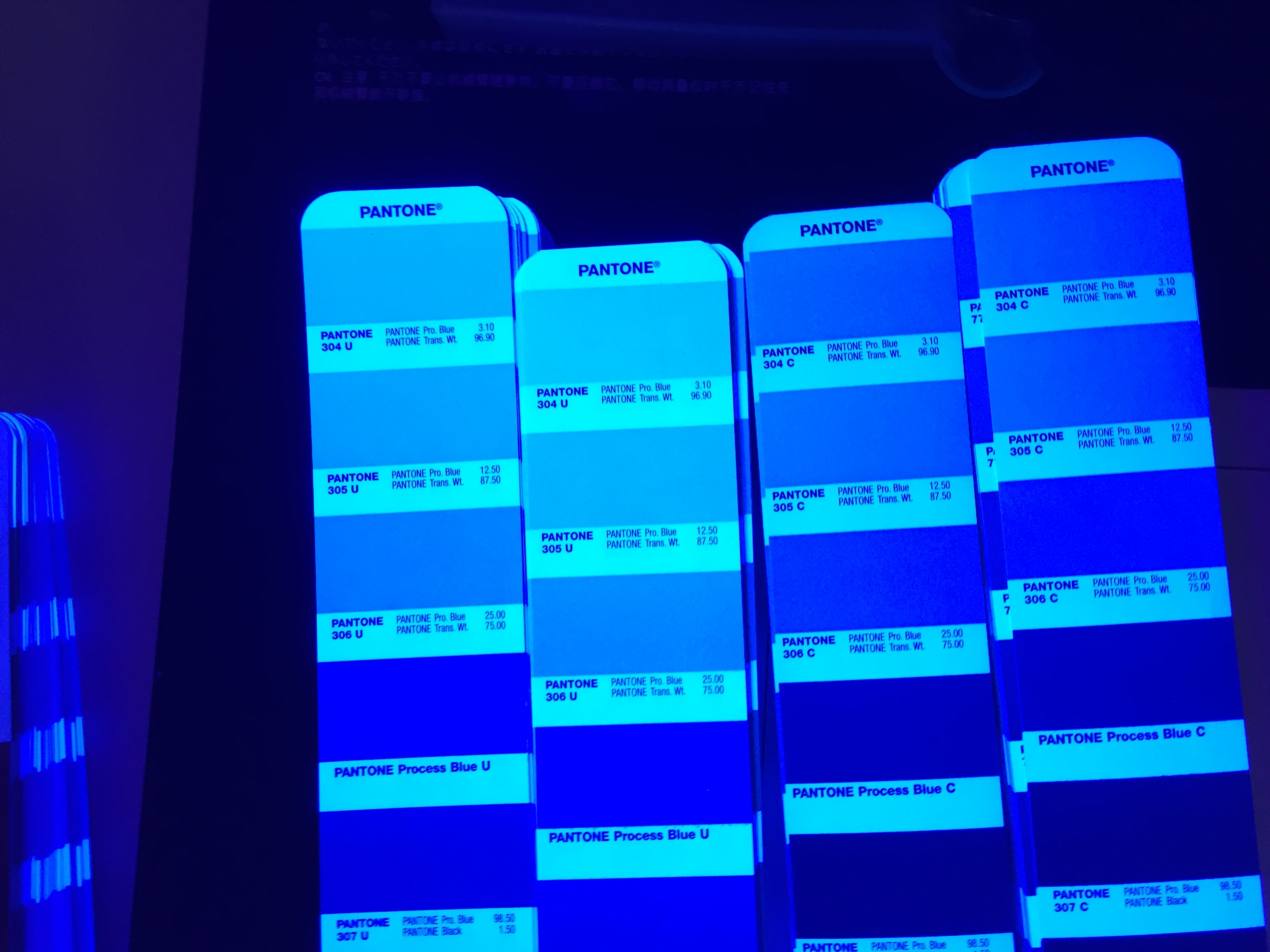

I think the difference in color is basically due to the very different OBA content of the Gloss vs Matte paper used. The difference in color will shift according to the UV content of the lighting source they're compared under which is why some folks here see a big difference while others don't..
Here's what they look like under UV light:
The gloss sheet glows under UV light while the uncoated doesn't. The lack of OBAs in the uncoated shifts the PMS towards a yellowish cast while the OBAs in the gloss shifts the PMS towards a blue cast.

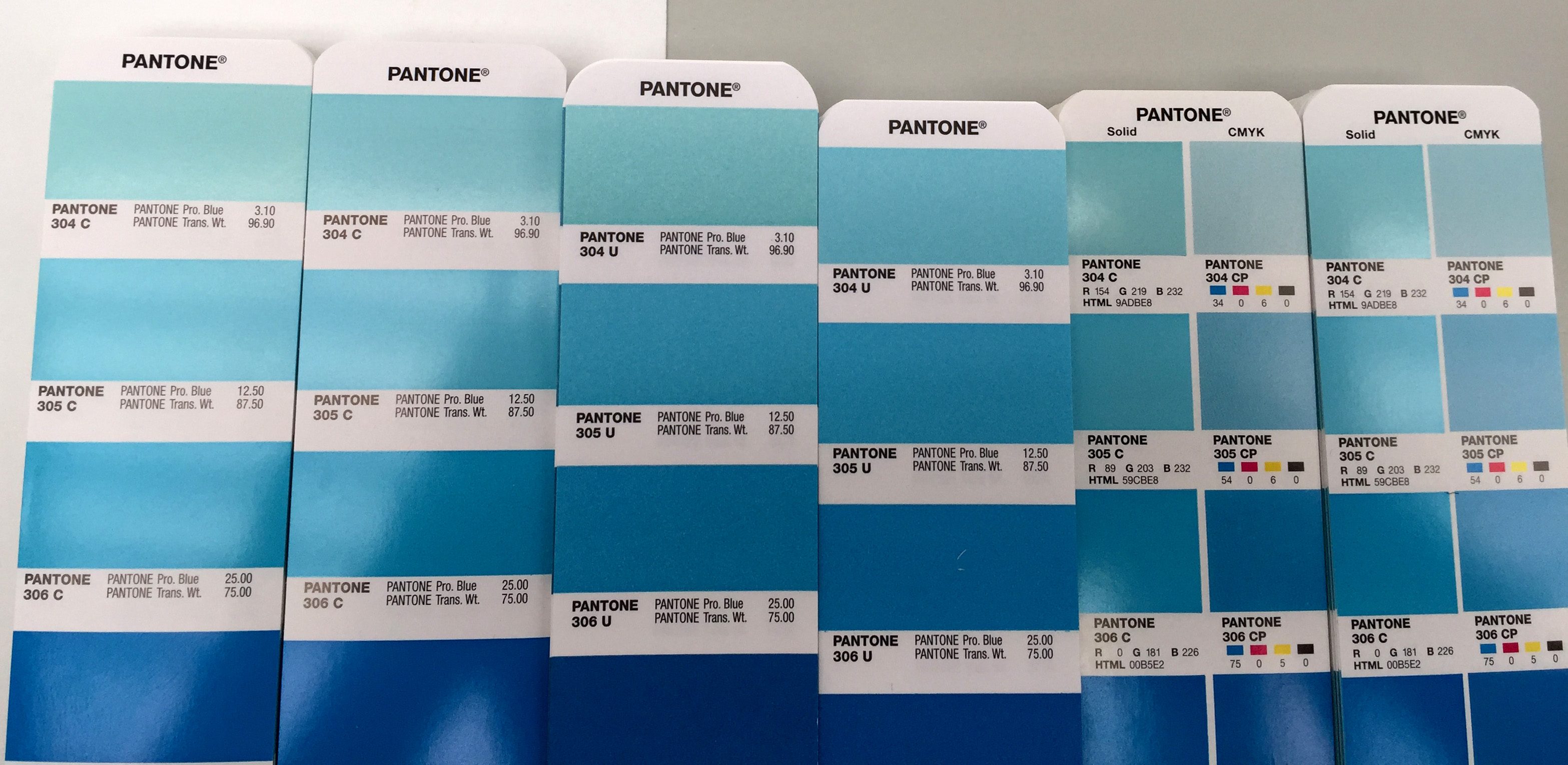

Here is the Coated, Uncoated and Bridge 2nd Edition 2nd Printing (Left) and @nd Edition 3rd Printing (Right) it really looks like they changed the ink. Newer 304 is much less yellow. All other colors look fairly unchanged. The older books have lived in a drawer for a little over a year and the new ones are fresh out of the box a week ago.
Also OBA Content looks relatively unchanged in the different printings.
