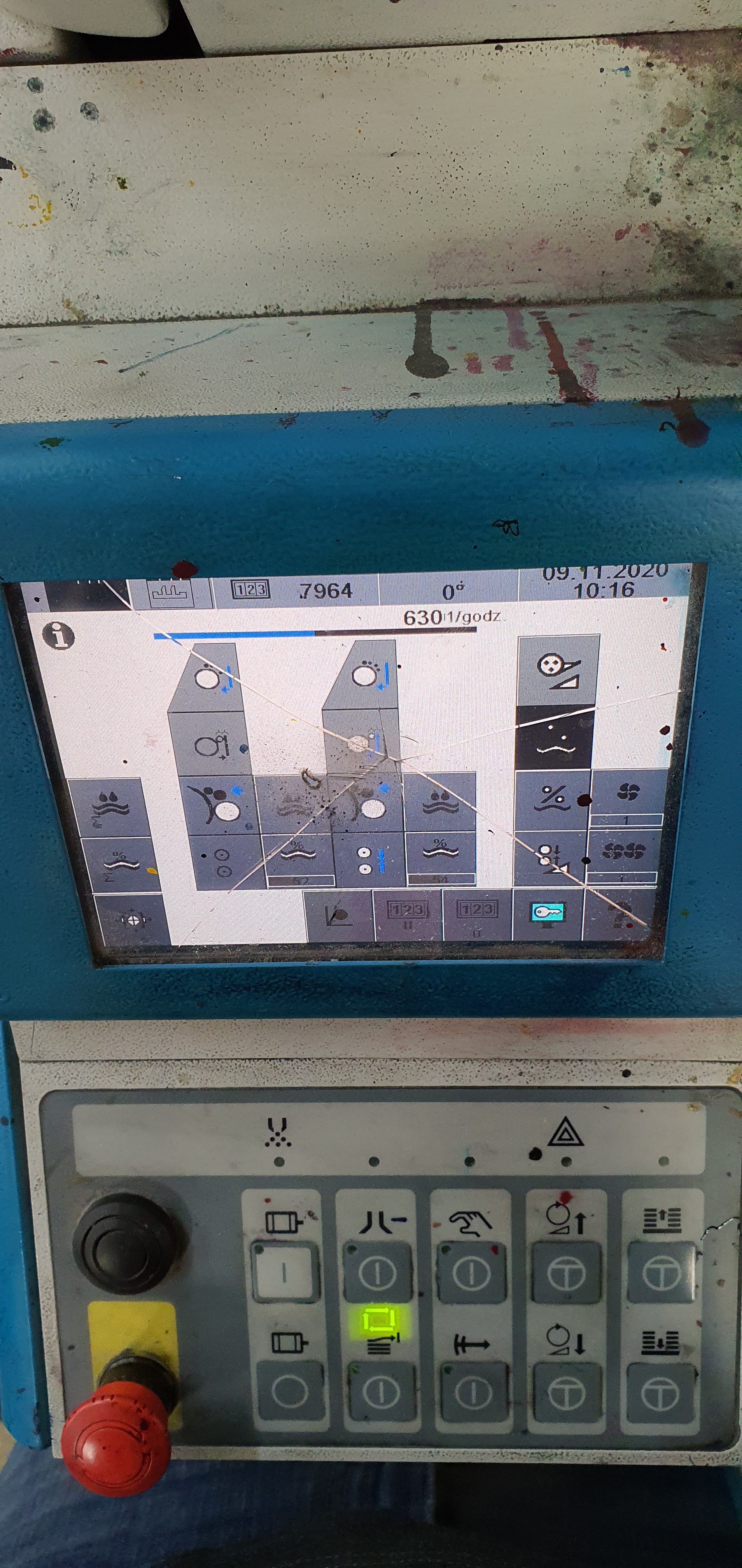

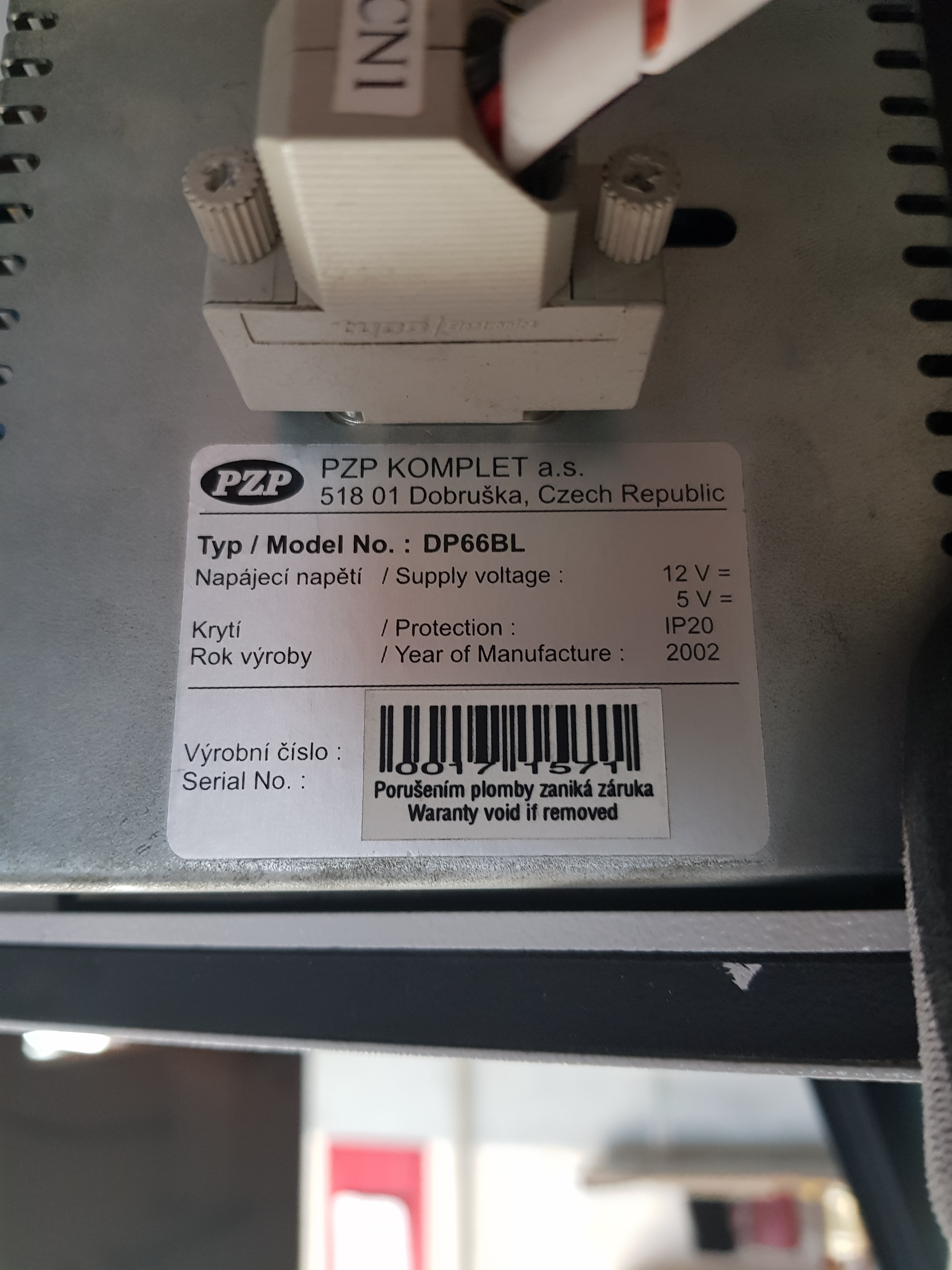

I have a Polly performer 266 with a Czech production computer model: DP66BL. I have damaged the touch / glass in the panel. The problem is that the company that installed it in the machines - PZP KOMPLET a.s. no longer produces it. There are also no parts. Anyone had a similar problem and it was solved?

The best you can do is to disassemble (or get it disassembled by a technician) the display unit. Inside you will find some kind of code, which will help you to find a replacement part. My bet is that there is an industrial panel inside the house which must be still available.
