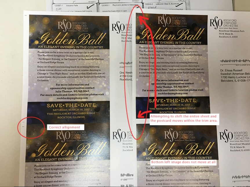

After exporting a PPML.zip file into EFI Command Workstation (WS), we impose the file into a 4up Cut & Stack order. The files are 2 sided. Using Image Shift in CWS we then adjust one side of the sheet to make sure it lines up to the other. Strange things are happening in the last month. Regardless of what side we indicate to shift, only the back moves. Now it even gets better - consistently all but one position moves, regardless of how many up it is imposed. And, the images seem to move within the trim box area. So it isn't actually moving the crop marks and image, but just the image within that area. We are running a KM C1100 and have tested both CWS 5.6 and 5.8 on and it happens on both. We also have an older K C7000 that runs CWS 5.3 and it does not happen there. Keep in mind, these files all ran fine up until early January 2017. I have older PPML files that previously ran fine, and now do not. We took the file to 2 other places, and they have the same issue. Has anyone else seen this?

We have narrowed the problem down to Fiery RIP version 2.0. Version 1.0 works fine. We have tested this on 4 separate machines at different offices and the problem has occurred on all. If you are running a Konica C1100 using a Fiery 2.0 RIP, PPML files from FusionPro (any Version) then you probably have the problem too. Also, the feature to define a separate proper drawer and color mode for the covers/body from within Impose for any PDF does not seem to work either. Konica is working on resolving the problem. Please test this if you have this equipment and let your tech support know too - so they know how urgent the problem is to get resolved.
