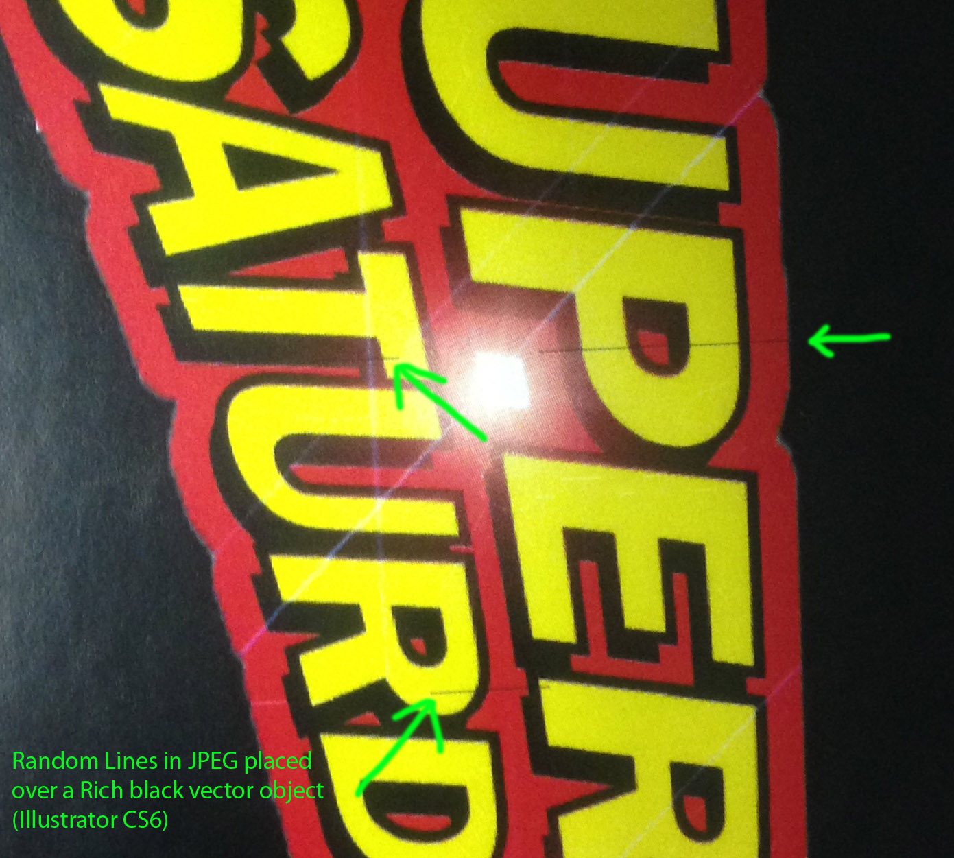

We just purchased a J75 machine about a month ago with an external Fiery EX J75 RIP running FS100. So far I've been pretty disappointed with the RIP end of the equation. I've used Fiery RIPs in the past (about 5 years ago on a Docucolor 250) but all of our more recent machines have been purchased with Creo RIPs until Creo no longer was an option. I'm having several problems that I'm hoping someone might be able to help with.
1. We're seeing a fair number of transparency issues that I thought were long gone (and were with our Creo RIPs) with the advent of APPE. I'm seeing transparency issues on drop shadows and the like that RIP fine on our older hardware. I'm also getting random lines (artifacts) on a few jobs. I've attached a photo showing a job that we just printed that has some problems. If I print this using the print driver on the computer, i.e. Postscript (not APPE) then there seem to be no problems. If I drop the pdf in the hot folder I get a strange series of lines running through the image. These are randomly placed so if I have this card imposed on a sheet with 4 per 12x18 sheet the lines appear in different locations on each of the four pieces. The file is a jpeg image (transparent) dropped on a black vector square. Very strange. I have the option on the RIP checked to "use APPE" and it seems as though I still get a number of transparency issues. From the experience I've had over the last week the best way to get rid of the transparency problems is to print using the old method of printing directly from the computer using Postscript 3. So much for the lastest APPE engines.

When you have a single color pixel on a page, regardless what it appear like to the eye, that page gets a color click. The Fiery offers the Grayscale radio button in the Color tab of Job Properties which ensures that the entire job is treated as B&W. If you wish to selectively turn pages to Grayscale you can do so by going into the Media tab, scroll to the bottom and in the Mixed Media section click New Page Range... In that window you can define a page range using commas, and/or "-" to select as many as you like, then go into Color mode and select Grayscale.
Transparency Problems: If you are using either the APPE or the PostScript interpreters you should select Color Tab, and check the "Composite Overprint" check box. If your Fiery has it, also select the "Optimize RGB Transparency" This may have a performance hit but it should resolve white knock outs and other transparency related issues. If you are printing from a Print Driver you do not need these setting because the print driver flattens all transparency.
Performance: APPE and PS are two completely different interpreters inside the Fiery. There is no standard as to which will be faster than the other. Since PS is a very mature interpreter it still has some advantages. APPE is still a developing standard and the Fiery is adopting the newer versions with newer products. A tip that may help is try going into the VDP tab, and checking Cache PDF and PS objects. That setting can have a dramatic effect on performance.
Artifacts in images: If you experience artifacting in images (TIFF or JPEG) go into the Quality tab and select Best for Image quality. In most cases the artifacting will disapear.
