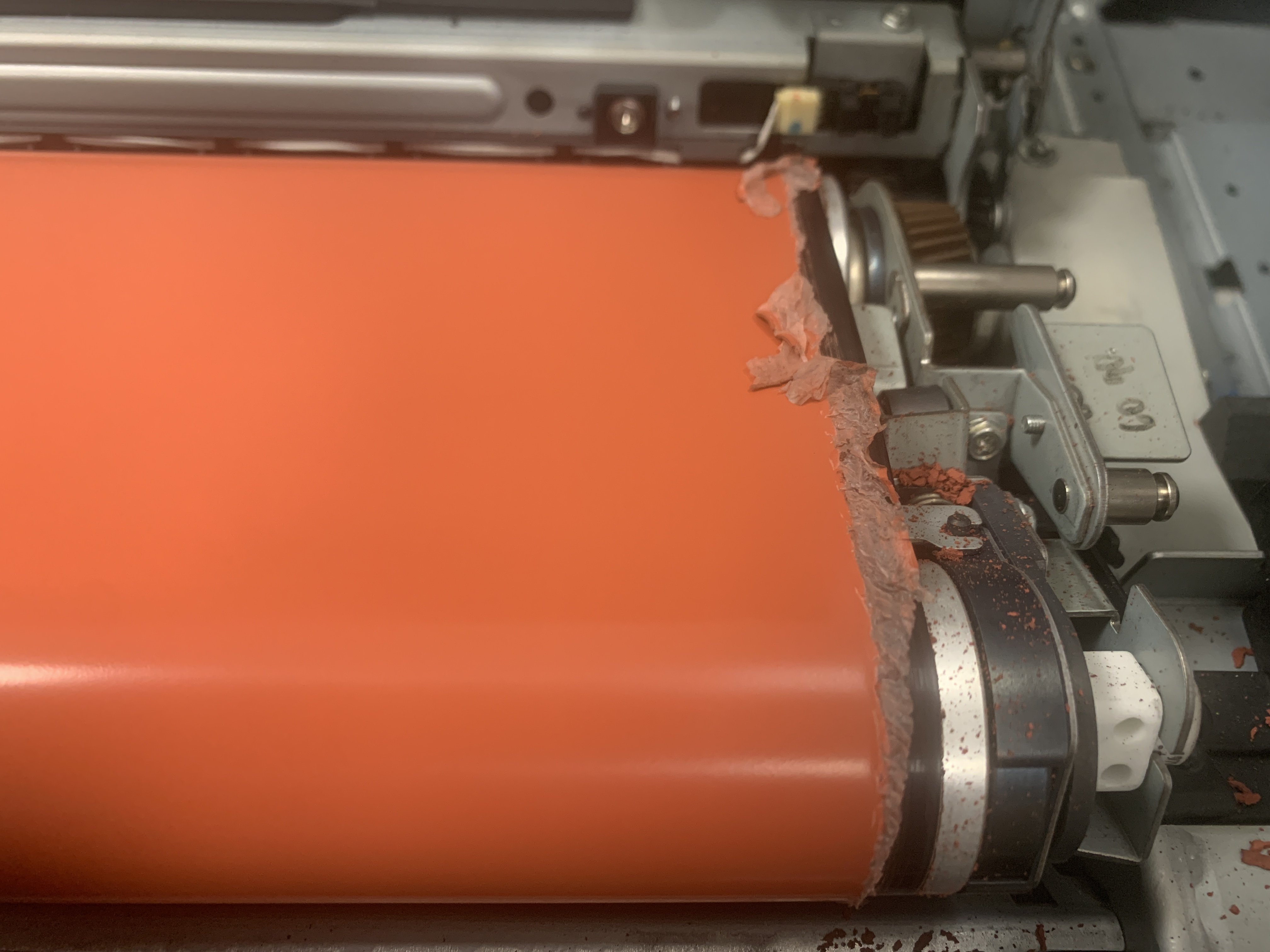

Anyway, I took a look at the fuser to see if there was an obvious issue and lo and behold, the fuser belt (that was brand new 2 weeks ago) is shredding.
So, now waiting for the tech to come and replace the belt again but need to try and work out why it’s shredded a brand new belt.
This used to happen to our former Konica like clockwork. I found out the tech had DROPPED the fuser unit before I was here. Then I fought with the service manager for another year to get the entire fuser unit replaced instead of playing games. Big reason why I’m not a KM customer anymore.
There's an arm on the opposite side of where the damage is on your belt. It's underneath the fuser assembly and the belt needs to run up against this arm. The arm is part of the belt position sensor. The belt moves around slightly back and forth on the rollers and the sensor makes sure it doesn't go too far in either direction. Could be as simple as the belt wasn't centered when installed or the sensor is bad or not working properly.
It's hard to tell from the photo, but some of the orange debris looks large. If it is large chunks and not from the fuser belt, then it's from the pressure roller under the fuser unit. I had one go bad and the roller was damaged and falling apart at the one end. This could cause the belt to go off track too.
The press will heat up more if the suction filter is plugged with toner. I take mine out and clean it (outside with a small leaf blower) because my dealer doesn't have the filter on my supply list like Xerox direct did. The tech will replace it when I ask but I do try to keep it from plugging. The recommended temperature range is 68-76° F/20-24° C with RH at 45% (listed in CED) and the upper limit is 90° F/32° C. Keep it at the recommended range and they can't complain about environmental conditions.
