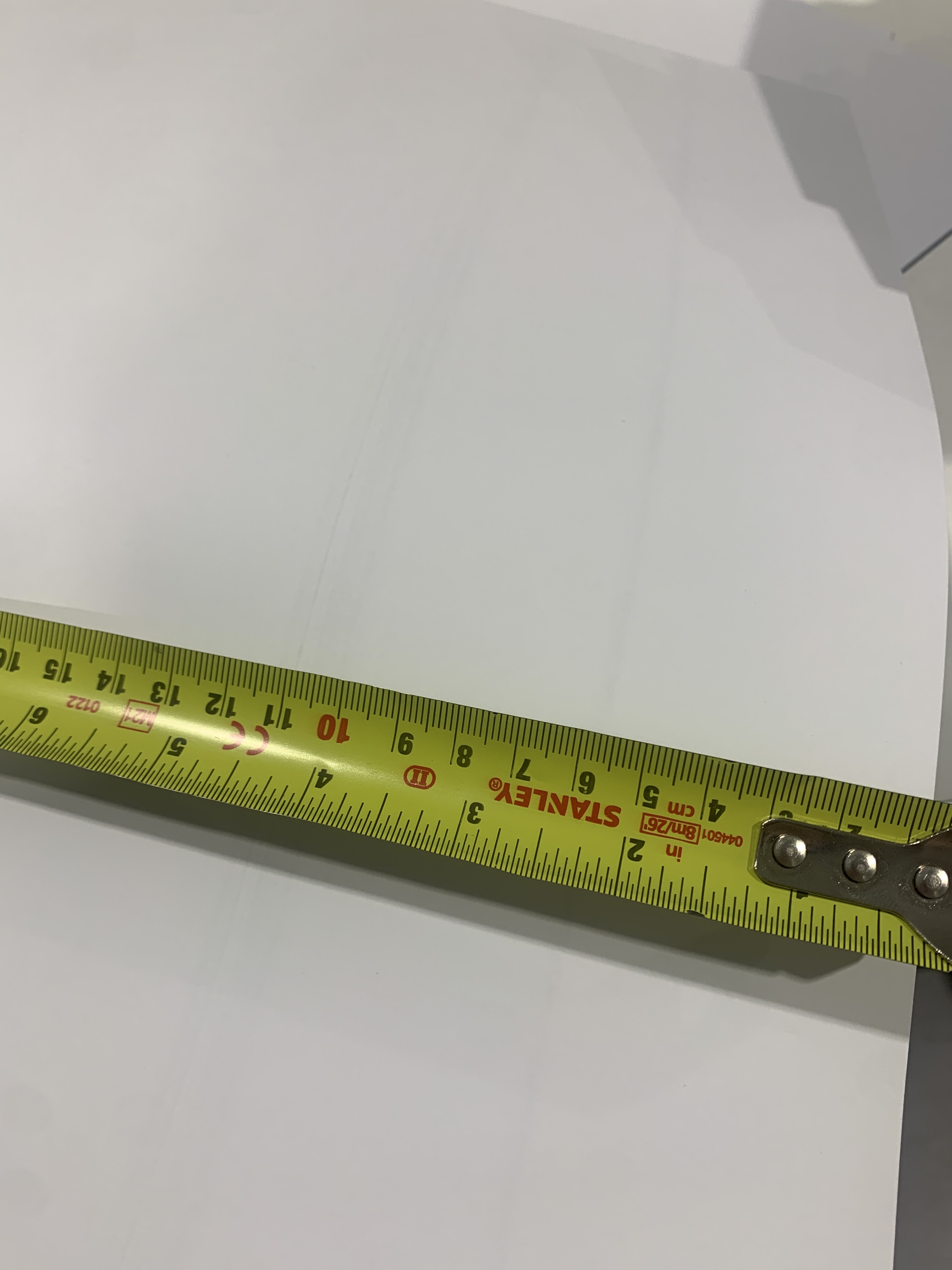

Unfortunatley our Versant 80 started acting up again today. Got back up and running on Tuesday, printer about 1,000 sheets between yesterday and today and now we are getting black marks on the backs of prints, even when only printing single sided.
At least it won’t affect printing stickers as it’s only affecting the backs of the sheets, but it’s literally driving me insane now.
That's the 2nd btr marking them. I've found lately I'm getting through alot of them than before but I have been running alot more coated stock. Thankfully xerox have no problem with me ordering a few at a time.
We are getting more refurbished 2nd btrs that last maybe 1500 clicks before spraying toner all over the place. If I can get genuine then they will last around 4-6 weeks at my current volume.
Thanks. I have gone to my dealer and asked if I can replace myself rather than waiting for an engineer to come. Hopefully they’ll just sent me a 2nd btr and instructions on how to do it.
Thankfully it’s not impacting my stickers because who cares if the backing has a bit of toner on but it’ll hold up my other printing for sure. Never a dull day 🤣
