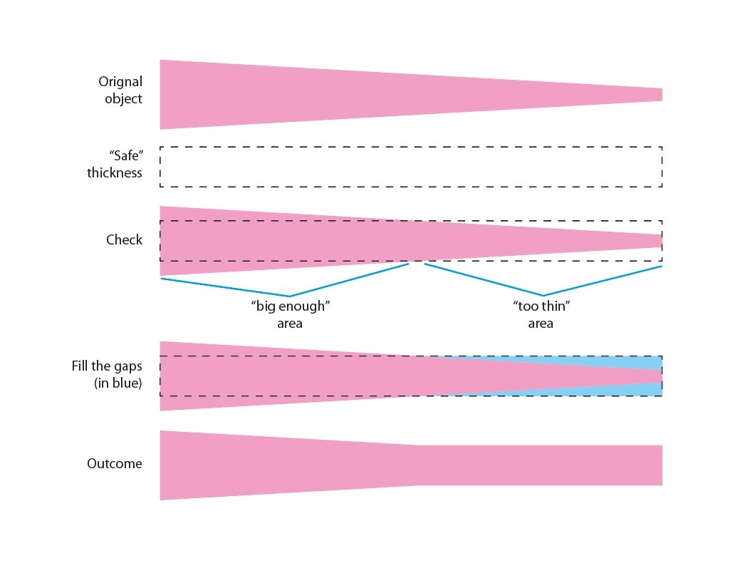

Suppose those hairlines aren't lines but tiny rectangles (such as 'expanded' strokes): how do you preflight them? Can you?
Suppose you have tiny vector objects - such as an 'art nouveau' logo with lots of 'branches' and so on - you can't actually print it using your printing method (now I'm talking about foil stamping). How do you fix them?
I'd like a method to check if the actual thickness of an object is under a given size, and then it to enlarge it only where needed.
I know my English sucks, so please see the picture; I hope it'll be more clear.
Do you know any way to do something like this?

Esko has a feature within their Deskpack tool set called Thin Parts, which is part of their Preflight plugin for Illustrator--it allows you to set a thickness & then adds vector objects to compensate for any areas thinner than what you've specified. It should do what you're wanting.
Our company has it, but we don't often use it--when you start thickening portions of art, it starts looking odd. Mostly we rely on strokes and do the best we can. We do hot foil & cold foil on rotary presses.
I'm not sure if it's available as a standalone purchase--Esko usually sells software in bundles and charges 15% of the purchase price annually for a maintenance contract (covering Illustrator upgrades, fixing bugs, etc).
Not aware of any other software that does this, but it's probably out there.
