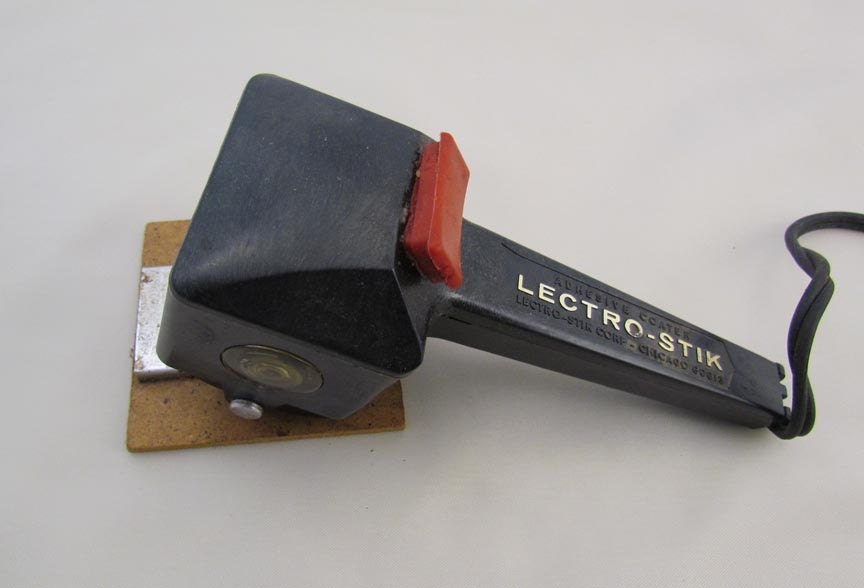

This waxer was great for use on the back of the Agfa-Gevaert Copyproof photo papers.
Kodak had similar Diffusion Transfer materials family named PMT (Photo Mechanical Transfer).
Possumgal
Oh, that hand waxer. Ours would finally start leaking. They came with thin plastic-sheet inserts you could use to stop the leaks, but you couldn't use more than two. I finally had to resort to three.
