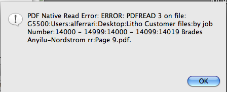

For a long time now I have kept Acrobat Pro 8 installed after I installed Acrobat Pro 9, and generally I try to use 8, simply because that's the application I had used for printing the IT8 target to have Chomix profile my Epson 7880. So Acrobat 9 would only launch if I double clicked a pdf when neither was running. Mac OSX 10.5.8.
That's the background; now comes the problem: I recently started allowing Acrobat 9 to be the working pre press version to do the kind of fixes allowed without additional plugins. Well I started to have problems with Preps accepting the edited pdfs the last few days and have narrowed it down to the Acrobat 9 saving of the edited pdfs. Even just a simple name change without any edits causes Preps 5.3.3 to not accept the pdf.
Simply continuing the pdf editing in Acrobat Pro 8 solves the problem. So Acrobat Pro 9 and Preps 5.3.3 don't play well together. Has anyone else seen this?

reduce the PDF to version to 5. In Acrobat 9 go to Menu Document - Reduce File Size - Acrobat 5.0 and later
I know you said you're not using plugins, but if you happen to have Pitstop there's a preference you can set that will not allow the PDF version to be changed upon saving. Not sure if there's a such a preference in Acrobat.

You can also edit a config file in Preps to get them to work without doing the "Reduce File Size" which degrades the quality.
- In the Preps 5.3.3 default.cfg file, modify:
USE_PPT_PDFLIB:NO
Change to:
USE_PPT_PDFLIB:YES

Yes, that is what I'm saying (as far as I know, anyway.) A PDF-to-PDF workflow simply passes the PDF code straight through - there is no conversion taking place. Conversions only take place if you use a mixed workflow, which is really just a PS workflow that converts PDFs to PS behind the scenes, either using Acrobat or Preps' internal converter based on your Preferences setting. If anyone knows for a fact that this is incorrect, please let chime in to correct me.
If I'm understanding your problem correctly, you are performing edits in Acrobat 9, then saving the PDF, then adding it into Preps. This is where you are seeing the error. All that error really is is Preps telling you (cryptically) that it can't handle the PDF version. By using the Reduce File Size to essentially backsave the PDF format, you're giving Preps something it can work with. My only problem with that is the lack of user options to control or at least see what is actually happening to the file to reduce the size. Size reduction is not really the goal here, so you might experiment with PDF Optimizer (under the Advanced menu) to see if that will work for you. The dialog window gives you control so you don't unintentionally downsample or recompress any images. You can even save your preferred settings as Presets.
I would take a PDF that you know exhibits the initial problem, then use Optimizer to make it Acrobat 8 compatible. See if that works. If not, try it again (from the original PDF, not the Acro 8 one you just made) and make it Acrobat 7 compatible and keep working your way back til you hit the one that works. Don't go back to 4, as that will flatten transparency. I'm hoping that Acro 8 compatible should work, since that was what you were using prior to upgrading to 9.

OK, I have done exactly as Dan describes in his third paragraph. I have done it both with Acrobat 8 and 9 to the same original file which caused me to post this thread. And with both versions it was not until I got to compatibility with 5 in the Clean Up tab of the Optimizer that the file became acceptable to Preps. Note that simply opening and Saving As from version 8 did not cure the problem.
This particular file was a Microsoft word generated pdf from Windows not needing any fixes beyond making it acceptable to Preps 5.3.3. I cannot post the customer file, but if anyone requests it, I can give all of the specific information from all of the tabs in the File Information window and the Additional Metadata popup.
