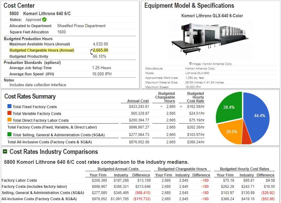

We just release our CostRatesAdvisor.com BHR rates study and cost comparisons feature which enables you to compare your digital printing cost and budgeted hourly cost rates to other companies. CostRatesAdvisor compares your labor, factory, and overhead costs rates to thousands of costs rates from other companies.
