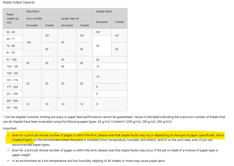

I don't think you guys have looked at the finishing capabilities of the 180 and 280 recently. If you get the production booklet maker you can do up to 120 page booklets at 20lb. Ive done 96 page 80lb cover with 80lb text before. Lied to the machine about gsm as I believe it maxes out at 80 pages with 80lb but it printed quite nicely. And was nice just grabbing the book and putting it straight into the box.
The OP wasn’t specific about the paper that was going to be used, but did say it was fairly thick high quality. When a customer says something like this, I normally skip using 80lb/118gsm coated text and go with 100lb/148gsm coated text. It may be possible to run a 64 page booklet on 148gsm through the production ready finisher but it won’t be supported by Xerox and that’s where the problem is, the OP is thinking of buying a 180 specifically for this job. If the OP already had the 180 and wanted to know if a 64 page booklet could be run on 148gsm I’d say go for it. If it doesn’t work send it out. But this is a purchase with no turning back if it can’t do the job it was bought for, even if the sales rep said it would work.
At 96,000 clicks on coated stock I'd be replacing the 2nd BTR at least 3 times just to finish the job on my 280.
