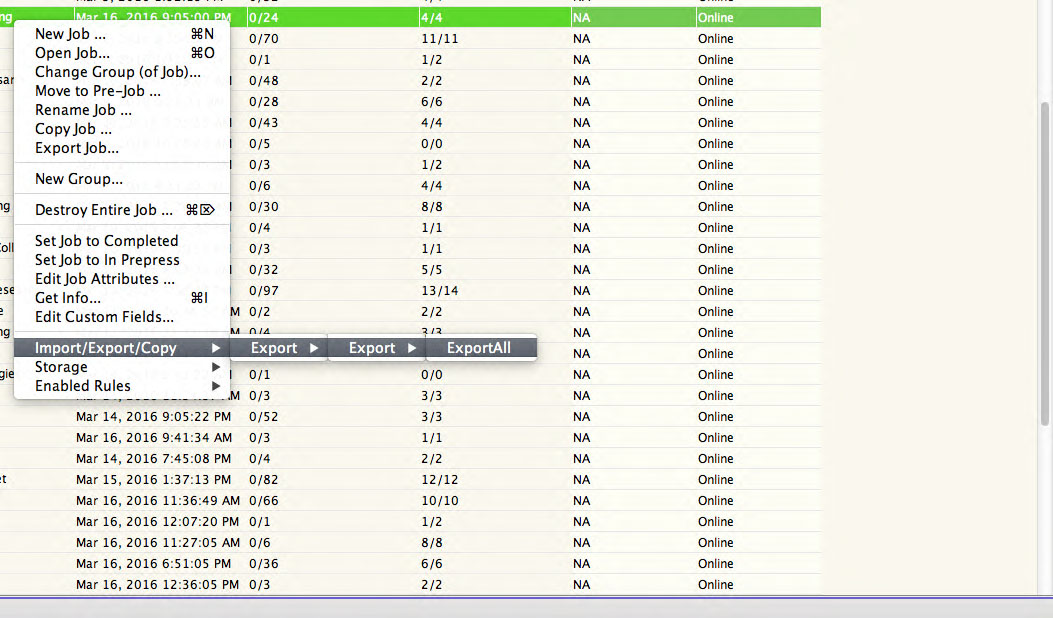

Can you Export the folders? I attached a screen shot. It zips the job for archiving, and you can move them to another location for storage.

it export everything except the UserDefineFolder and Job History but I can export and then copy UserDefineFolder then reverse back and it should be all there.

I tried the export and keeping the UserDefinedFolder yesterday and imported it today and it worked fine with all the data. So it's going to be fun creating each folder to house the zip and UserDefineFolder for each job.
