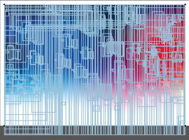

I've uploaded a sample of one of the pages. Excuse the typo.

It's no wonder it's killing your RIP. Take a look at the number of objects that make up that background. Rasterize the background image!
With PitStop you can separate the elements into layers (text on a layer, graphics on a layer, images on a layer) to get at what you need to work on.

Yeah, I'm pretty sure it was purchased from one of those art websites like dreamstime.
We rasterized the graphic and it significantly improved the rip speed.
