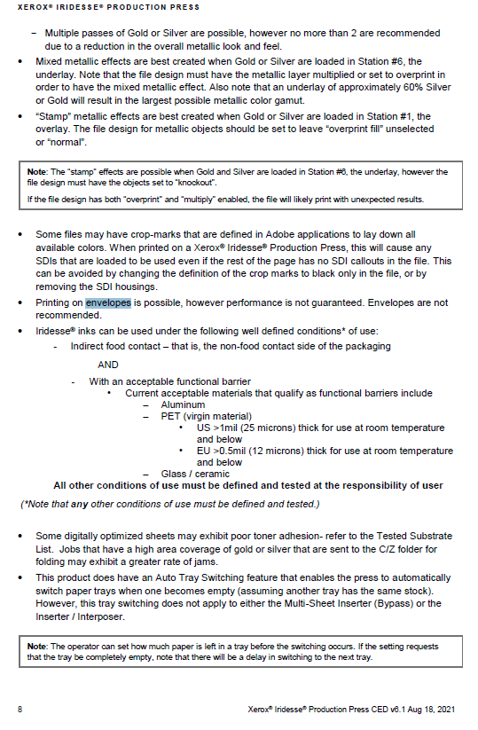

Xerox puts out a CED - Customer Expectations Document - for their equipment. I found this to be much more realistic with regards to how the machine will perform at a minimum. Attached is the page from the Iridesse CED that addresses envelope printing. It's not a long read, lol! I did find a Recommended Media List online, and there was not a single envelope on there. That being said, we do successfully run envelopes, but not EVERY envelope will be trouble-free. Ironically, the Iridesse high-capacity feeder has the envelope guide attachment included :unsure:
