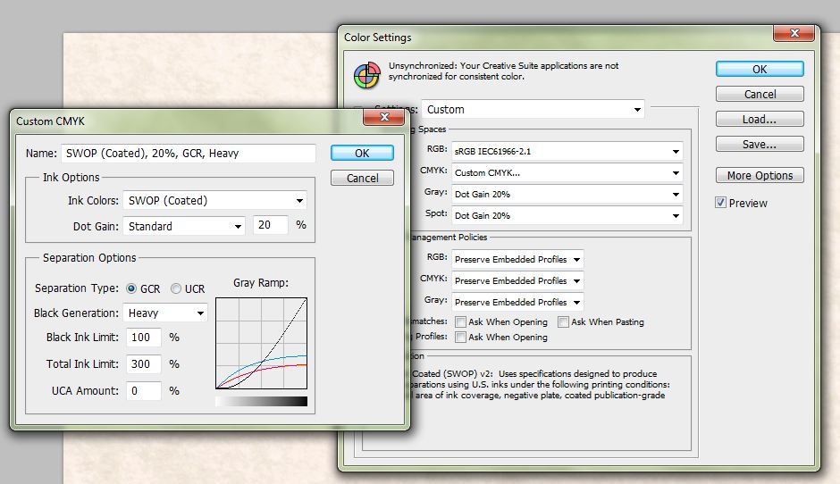

GCR Adjustment
GCR Adjustment
I think GCR adjustment is available in PS, under Color Management...
Regard,
No GCR adjustments available for the designer/prepress operator in the design software. Features that involve hacking the output files don't count ;)
Regard,
You are right but it's an old method from the pre-ICC days and if you want to use it, you have to rely on obsolete ink description like Eurostandard (at least if your work is going to be printed in Europe). ICC profile is the way to go if you want an up-to-date gray balance and a better conversion to CMYK but you cannot change the GCR setting of the profile you are using… That said, I am sometimes still using the old method when I need a CMYK separation with maximum black generation (our profile-making software doesn't allow us to have this much black in a profile…).
