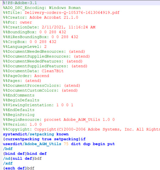

I have been changing settings in my Xerox Freeflow settings. I don't know what I've changed along the way but now my Versant is printing 40+ pages of text instead of the print file I sent over.
Has anyone come across this? Any help will be gratefully received.

I'd managed to change a setting in the Queue Manager.
under 'settings' tab
'Input / Format'
Format drop down needs to be Postscript.
Hopefully this will help someone out down the line
Cheers
i HATE it when that happens !
And does anyone ELSE remember when the film coming out of the imagesetter had this same issue?
It cost a LOT of money.
We had multiple processes that we trained the desktop operators to follow to avoid exactly this outcome.
The more things change . . .
