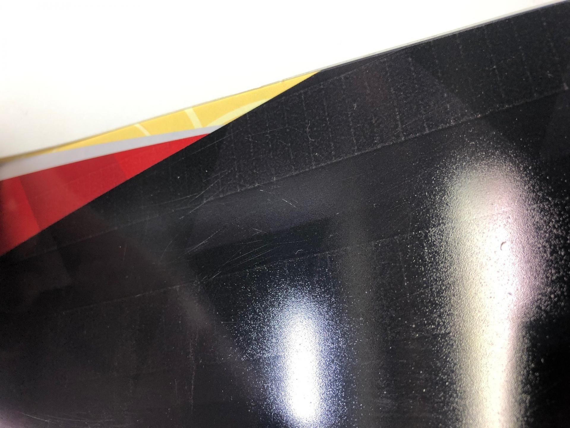

I threw some 4x8 foot polystyrene sheets into our new Epson Surecolor printer that are .030" thick. It prints beautifully except for the fact that the feed rollers are doing something to the plastic that makes the ink look bad in high coverage areas. Almost like a slight pooling of the ink. Where the feed rollers don't hit the image is perfect. Does anyone have any experience with this?

Sounds like it's either a setting issue or the substrate isn't made for the inkset.

I have attached a pic of the issue. The marks line up with the feed rollers. So they seem to be doing something to the sheet before it is printed. I have no profile, so I had to make one for this material, but I can't think of a reason why the rollers would affect ink laydown.

It seems that our problems stemmed from the polystyrene having some kind of a coating on it. We wiped a sheet down with glass cleaner and the streaks are gone.

Sounds like what you may be seeing is Plasticizer Migration. I would not recommend glass cleaner, Isopropyl Alcohol would be better and if you get 99% it will flash off faster. As Plastics age or get hot/cold plasticizers come up to the surface of the material. One way yo check is with a dyne solution.
You may want to wipe of the rollers occasionally too as the Plasticizers can transfer to the rollers causing similar issues when they touch the raw stock.

We have run more of the stuff and simply wiping every sheet down with alcohol before printing fixes everything.
