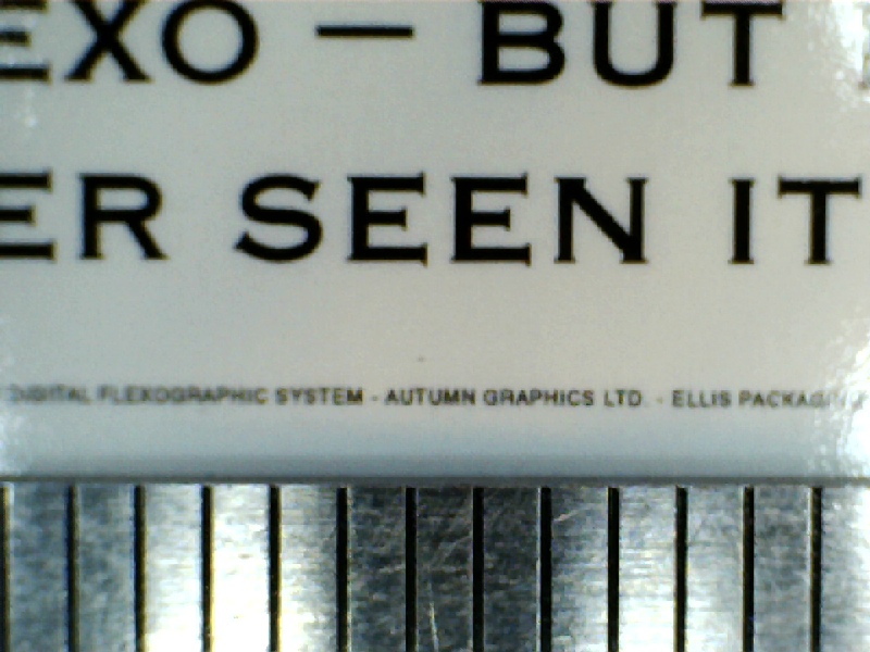

As others have stated, this is also routinely performed in traditional printing – even flexo! Kodak have demonstrated micro text printing using their Flexcel NX plates, with capabilities to have 0.5pt legible microtext. I don’t have a print sample in front of me as I write this, however If I remember correctly the folding carton flexo sample was 1pt type.

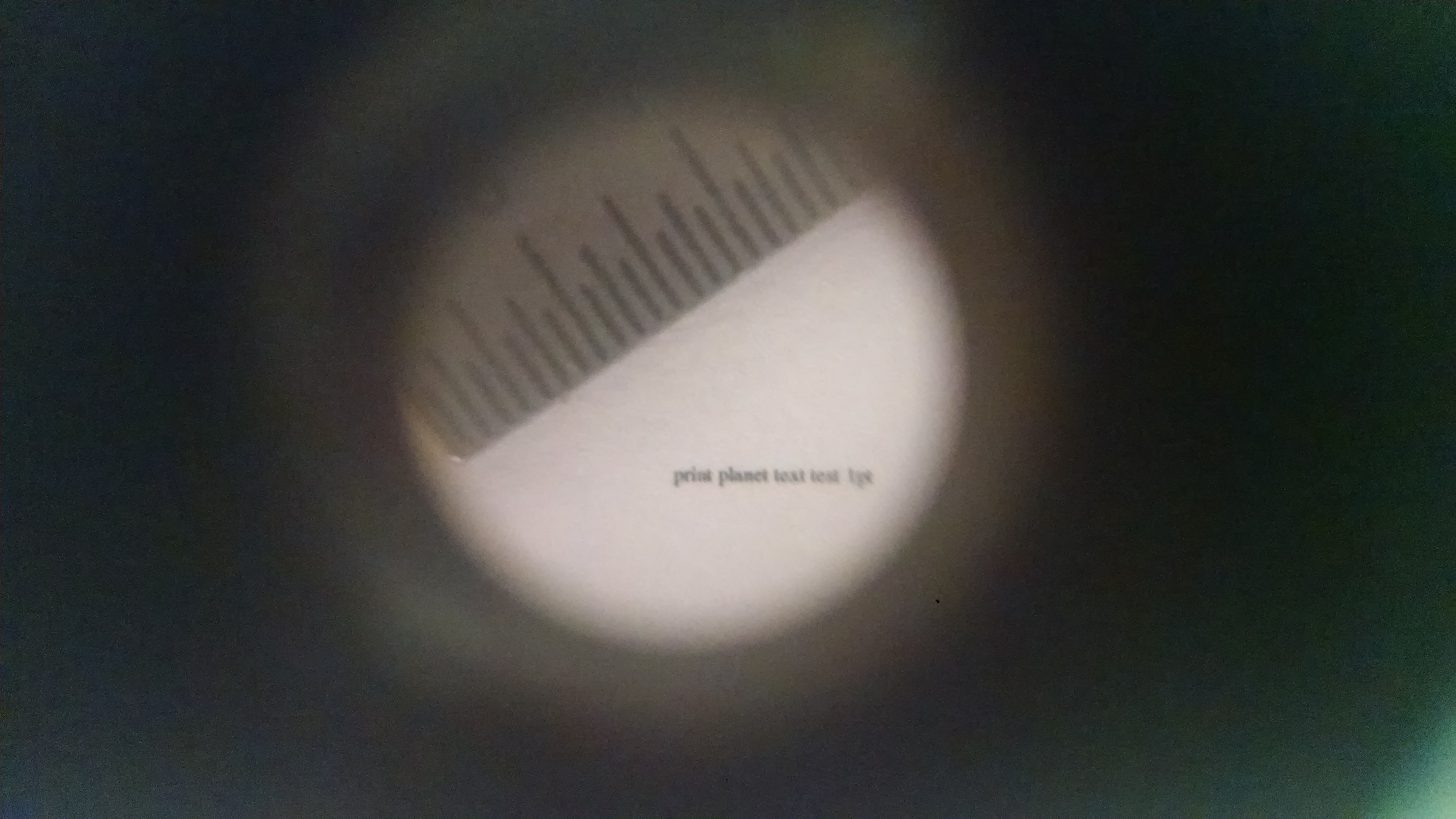

1 pt type. took pic with my phone thru a loupe. 60lb offset presstek 34DI.

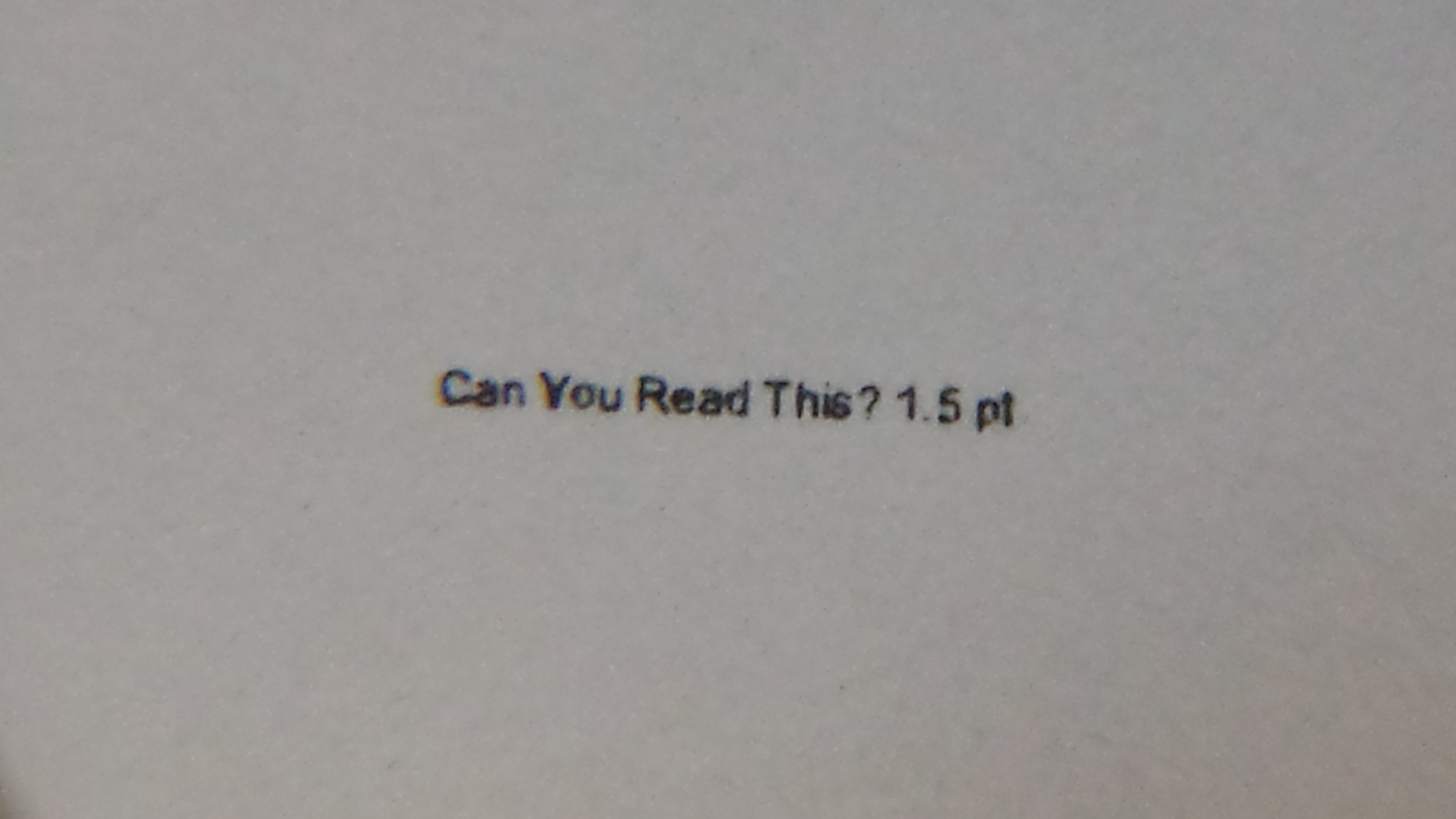

Wow that's a pretty good sample. I'm not getting anything that clear on my 1000i but it is clearly ledgible. If it was a limitation of the machine I could accept that, but I feel I'm getting something wrong to not produce it better. It could very well be the file they sent me, so I'm going to recreate one and test myself. Id really like to get this customer, so outsourcing to offset might be my only option if it's the machine. But it's only the 1.4 and 1.5 fonts that are questionable. 1.6 is good. So I'm a little stumped. Especially when you can use micro text for security reasons.

This is off our 1000 with an efi rip.

Attached is the Kodak Flexcel NX MicroText sample on folding carton, I have included a guage in 1mm increments for scale.
The focus is a little off on the micro-text, however it is very legible when correctly viewed.
