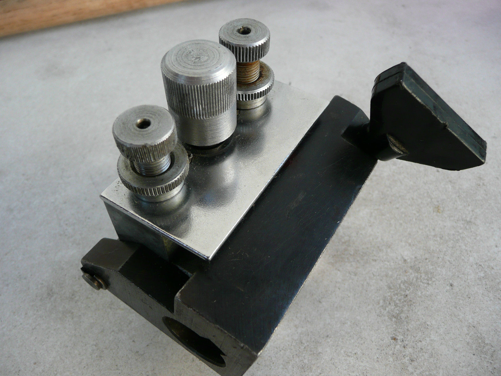

when it takes place only in one machine then the problem would be the machine it seems the problem is the human factor.
adast side mark
Regards, Dancco
I think pre press is concerned, because that paper work after 2; 3; 4 times on the same plate in the machine and then getting poor results from a mismatch of the register of the press. Perhaps there is another method for testing the side register, I do not know.
