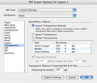

John W,
That Export Option is for transparency created in Quark. Below that option is one for "Transparent Objects In Imported PDF & Ai Files" that requires a "Flattening Resolution".

Flattening of the placed PDFs gets handled by JAWS on import, I don't think the flattening resolution for Export would make any difference to the quality. Quark specifically said NOT to re-place a native transparent PDF that it generated back into a quark layout but rather flatten it first.
