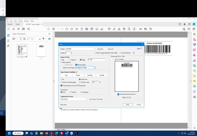

Sorry about deleting my original post I knew I was forgetting a step. after cropping the second half of the book print to pdf and use the reverse page check box to create a new second half.
that only works with reader spreads
edit... correction, it would almost work except the 2nd half of the document the pages would be in the reverse order
Sorry about deleting my original post I knew I was forgetting a step. after cropping the second half of the book print to pdf and use the reverse page check box to create a new second half in reverse order.
Since these are files from the 1990's I would do it this way.
"Reverse Pages" reverses all of the pages, you can not select a range.
print pages 11-24? you can't with the check box of reverse pages I can.
