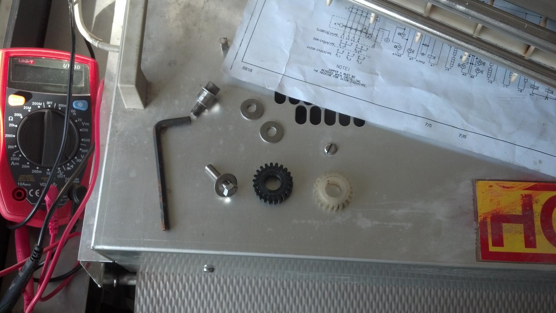

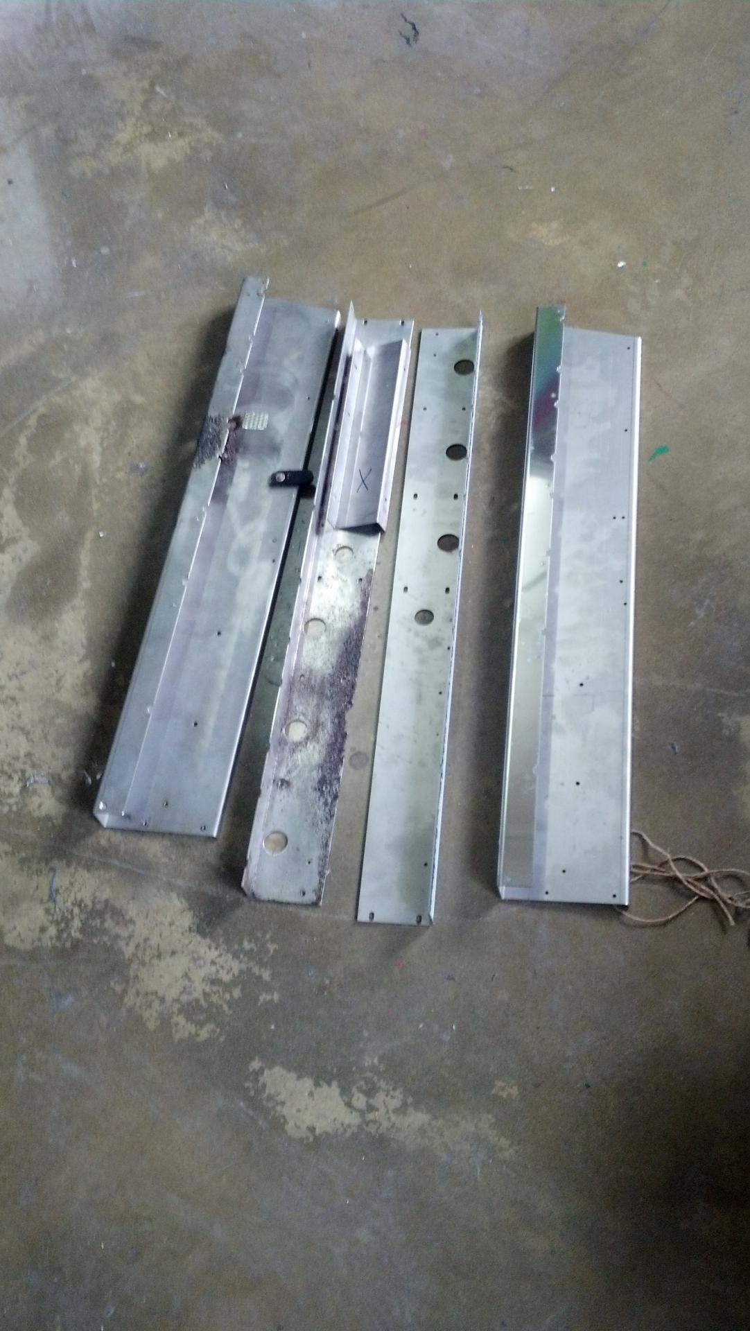

Well I got the new parts and it only took another five they-will-be-ready-next-week´s. But I got them and they fit, they fit actually quite well and that is the main thing.

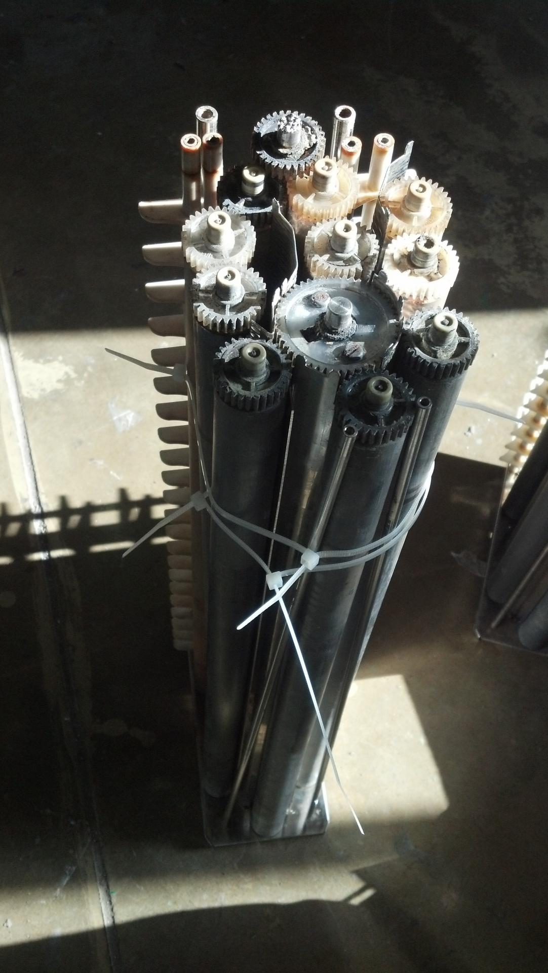

One other problem reared it´s ugly head; one of the gear wheels was missing from the fixer rack, the one that drives the entire lower roller bunch. So I have had one printed. Just picked it up today and it looks really nice, it was copied from one of the originals and rendered with a carbon reenforced nylon filament. It fits and it works.
I must admit though that I screwed the documentation up regarding the fuse box and wring, but I now have a wiring diagram for that processor and it should be a simple thing, I am however getting my colleague onto the act, he is an electrician and it should be even simpler. We will see.

BTW, concerning the developing speed issue - there is a workaround I remember we did a long time ago:
use the (shorter) Fixer rack in the developer section.
Naturally, you need an extra Fixer rack for this trick...
Got everything back together, at least mechanically, I did manage to swap the guides and put the wide ones on top and the thinner ones on the bottom with the result that the fixer rack would only turn in one direction, the wrong one. For that it got its self stripped down again and put back together the correct way, now it turns freely both backwards and forwards. I slipped it into it´s bath and now I am able to turn the main drive shaft with one finger on the main gear, dev, fix, water and dryer, all nice and free, until "CLUNK" damn fixer jumps off the worm gear, not always, just every now and then. So close and yet so far.
Worm gear jumps are usually a result of resistance from inside the rack or that one (or more) of the teeth on the gear/wormgear is worn/broken.
That is true, there was one tooth broken off on the rack gear, it was a fresh break so I assume that it came from the false set film guides, however I swapped it with the gear from the water bath and get the same result, it seems to turn freely without any resistance but after three turns I can feel the resistance building until it jumps. As I said all rollers are free and turn easy, gonna swap the racks and see if it still jumps. I did notice a build up of ancient crud on the rack side of the gear so I am assuming that the rack was never seated correctly and indeed it will not go in the bath without a bit of wiggling. You know you are on the right track when you start to solve the old problems of a machine.
Then I need to see my friendly neighbourhood 3D printer for a new worm gear.
