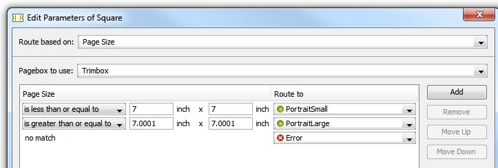

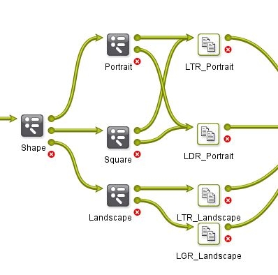

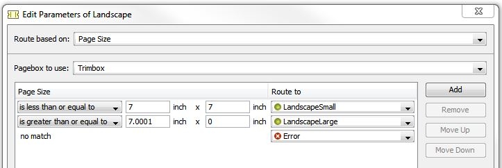

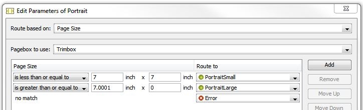

I'm trying to set up a way to route the reportmaker taskinputfile to the correct reportmaker template based on size and orientation (square, portrait, and landscape). Right now I'm just moving my test files and I'll hook it up with the reportmaker templates later. I've got 4 out of six to move a correct folder but the file dimensions triggering size keep tripping me up.
The LTR portrait, square, and lanscape stock fits a box of 7" with one side off 7". 11X17 LDR is larger of course.
