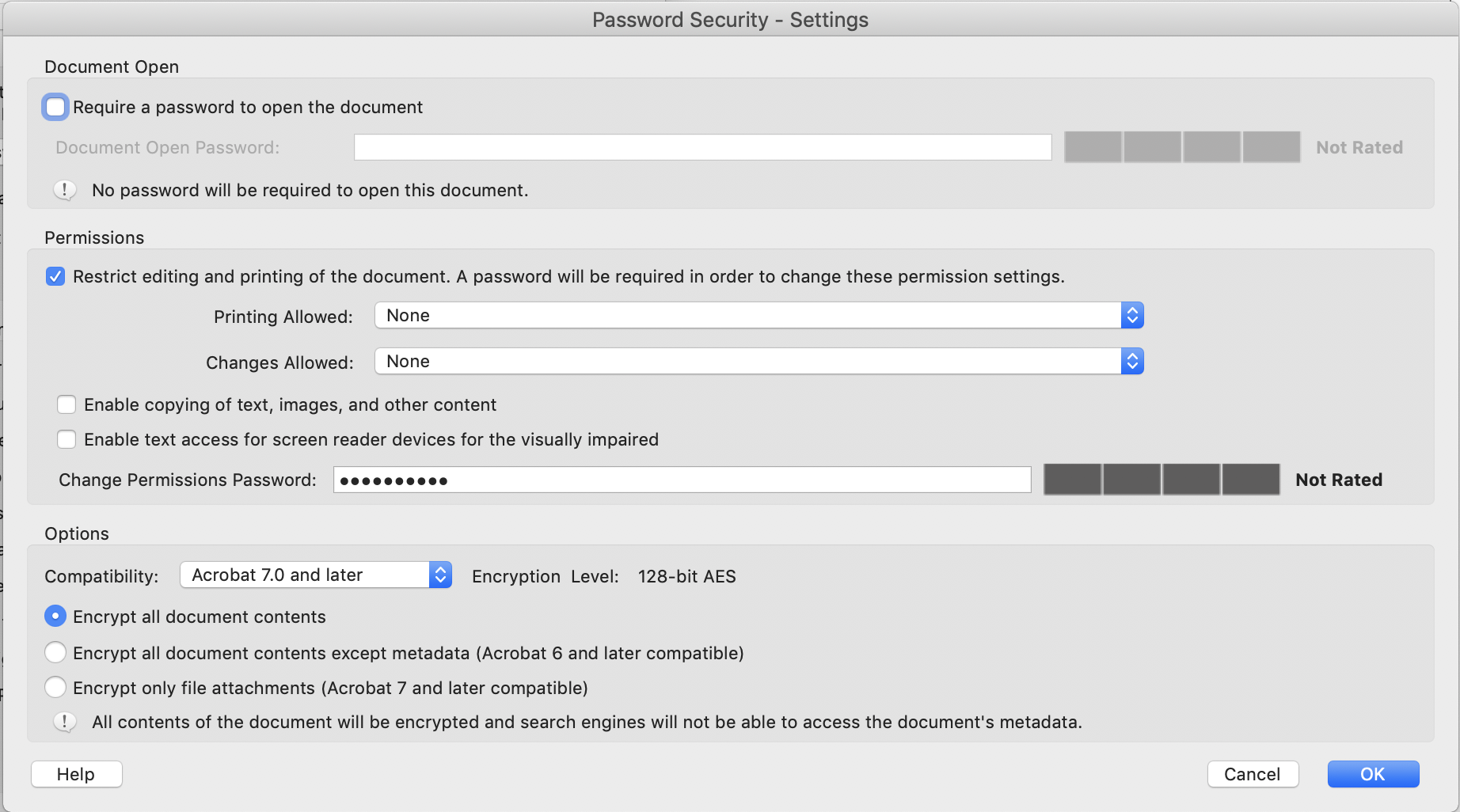

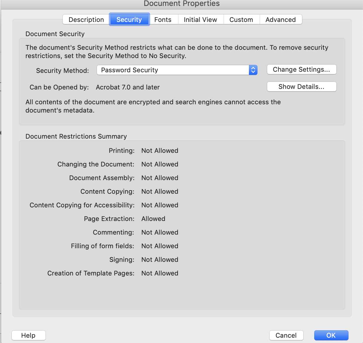

See attached images - I put these settings on a PDF, and I think they give the results you want - Everything is restricted except page extraction.
Yes, this is what does in fact work; I actually tried that before posting my response above. ;) You can modify it to allow printing as well as extraction.
