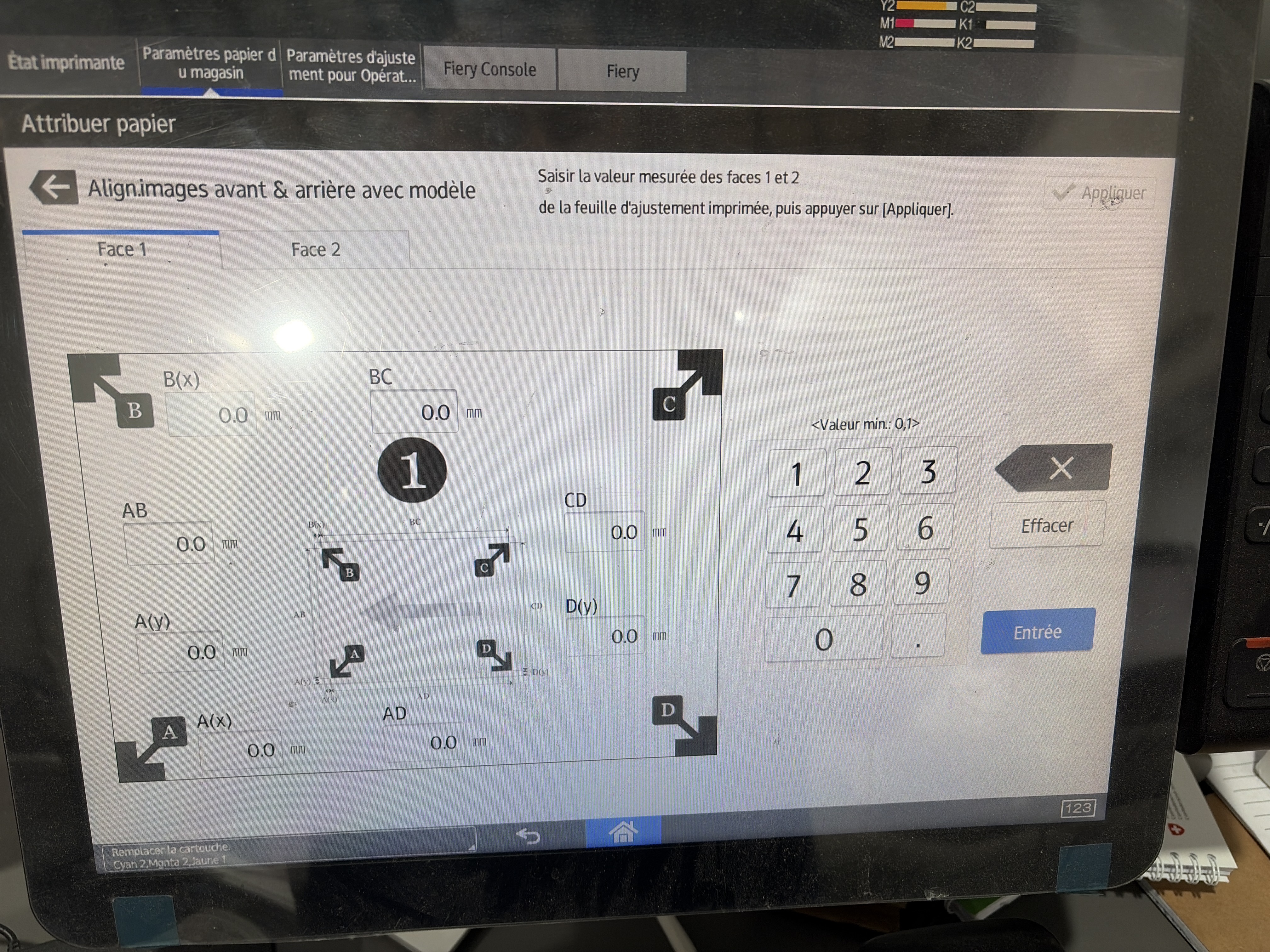

Can someone tel me how to print this pattern ? I can't find it in machine setting.
Thanks,
