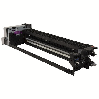

- the issue with the C7100 is, that you have to replace the whole thing - it is called photoconductor unit - and includes the developer group (I attached a picture). There is no information on servicing anything on this part (beside replacing one filter). The PCU does not even have a replacement interval, like other parts does, so I assume, Ricoh assumed, that it does not need to be changed frequently.
Or you think there is a way to service this and just replace the gears? We will certainly buy a new unit, but would then maybe try to work on the old one for the case, we need to change it once more later.

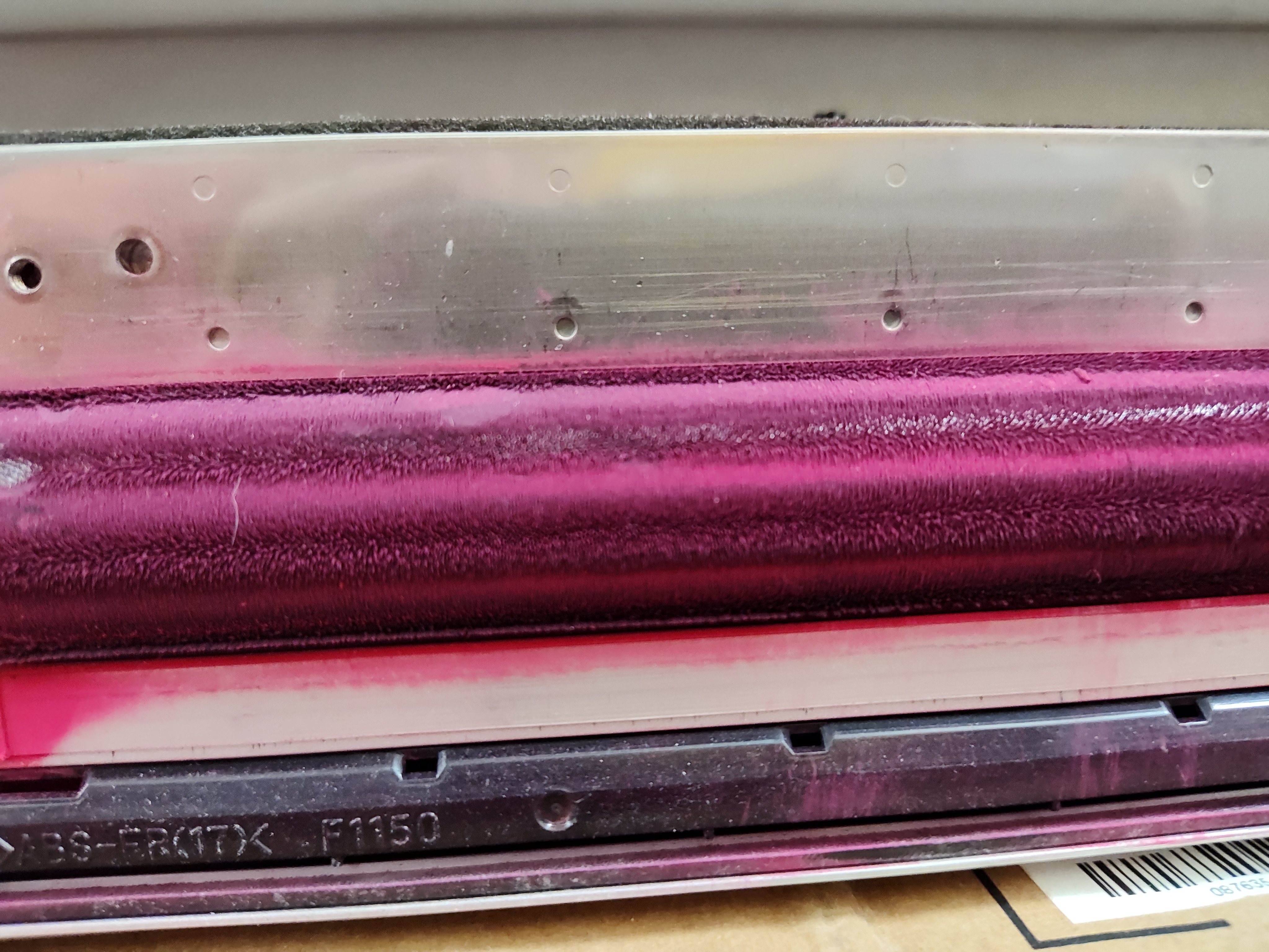

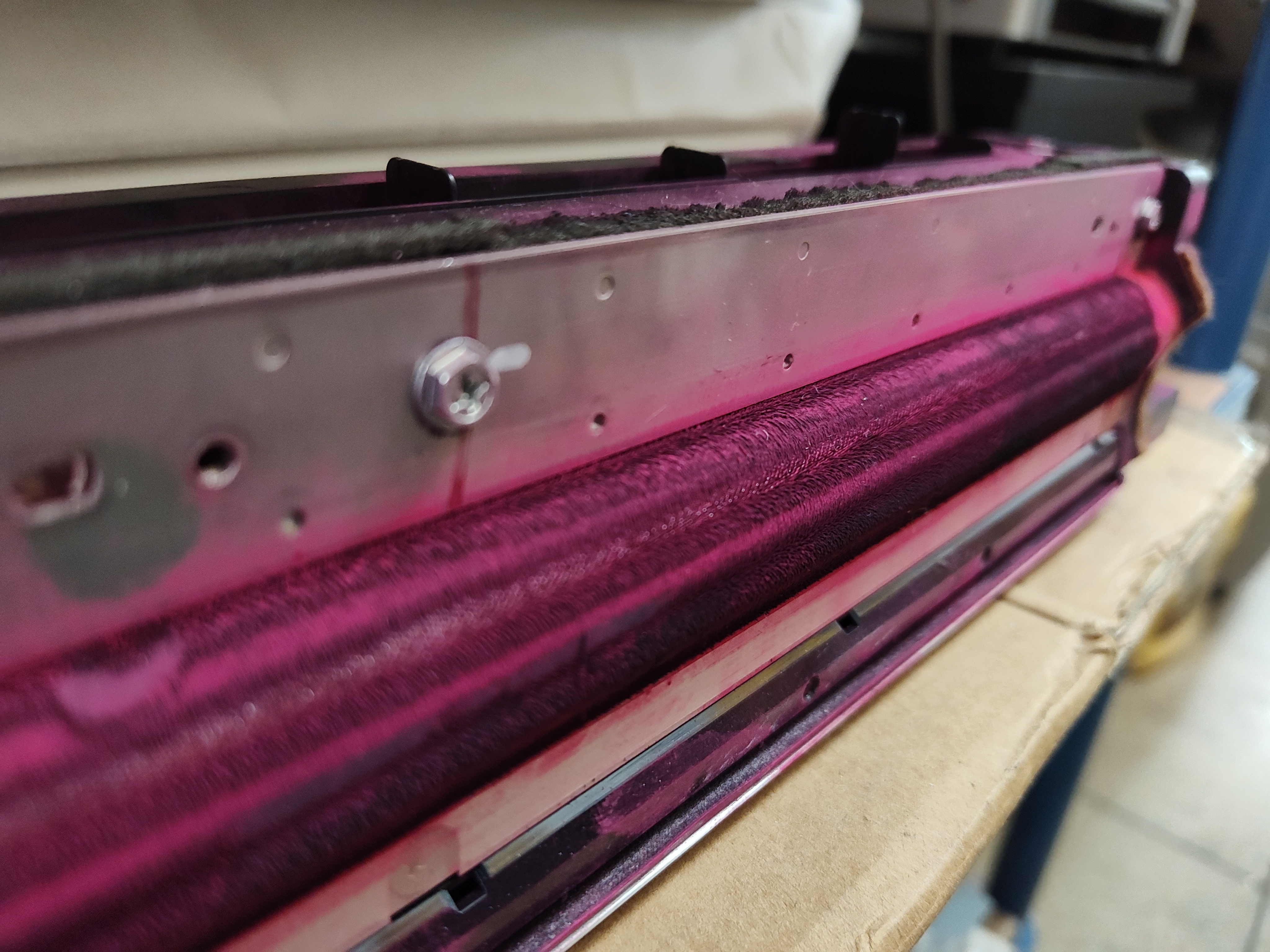

I looked today at the used magenta photoconductor unit that we got with the machine, which obviously has been changed as the machine still had the contract (we even got TWO used magenta PCUs - was obviously a more severe issue there).
It has a pattern that looks similar to our issue with black. So I assume, that after some million impressions something deforms inside of the unit. I can basically see that the shaft of the developer goes off center after every full movement - and I can feel that I need more force to move it at two points within one full move, - I assume this is what Ricoh relates to as they mention the "50mm, 25mm banding". So probably no way to easily repair that, if the recommended solution does not work (process init, toner refresh, DEMS) - we tried multiple times and it did not get any better.

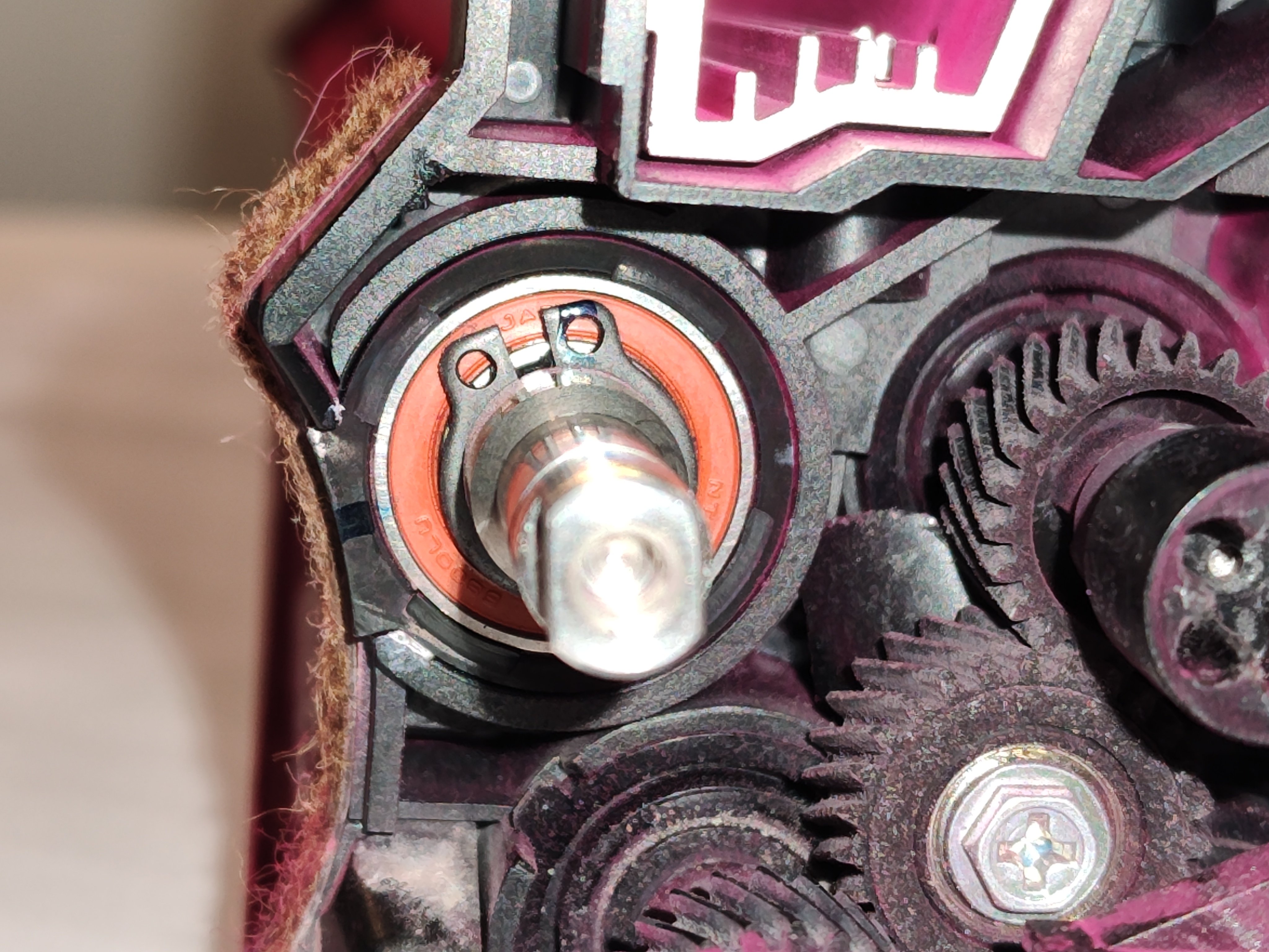

One more update: I further examined the magenta PCU, and now I can exactly see the problem (at least on this PCU, assume similar/same thing on the black one). I attach a video... The bearing on the left side (front) is loose to an extend of 1mm I would say. The right/rear one does not have this issue. This would also explain why I get stronger lines in front (bottom) than in the back (top side), should the black developer have the same issue.
I will try to dismantle the right (good) bearing and mount it into the black developer. But I am scared that I could make things worse - any hint of advice beside the obvious caution measures?
Btw: on the video you can also see that the roll movement is not smooth (it is smooth besides two points I mentioned earlier). Sorry for the bad quality, I had to keep the smartphone in the other hand. I already poured the most of the developer powder out of this unit, that is why it only gets so little of it sticking to the developer roll, - but still enough to reproduce the issue.
For the case someone else needs this information, the bearing on this particular magenta PCU developer roller is NTN 6800LU, as far as I can tell without the magnification glass.
I could need some assistance here - do you know a non destructive way to remove the bearing from the PCU housing? I don't mean the element securing the developer roller, which is obvious. I mean the bearing itself. There seem to be four metal latches every 90 degrees around the bearing - does it require a special tool (it is called "bearing puller", if I get it right) for sure to remove it or maybe there is some other method? I mean - this Magenta PCU is already broken, but I would like to try to remove the bearing without further opening the developer unit - if possible - so that I can change it this non invasive way on the black PCU later. The plan: broken bearing out, good in, ready ;)
I could need some assistance here - do you know a non destructive way to remove the bearing from the PCU housing? I don't mean the element securing the developer roller, which is obvious. I mean the bearing itself. There seem to be four metal latches every 90 grades - does it require a special tool (it is called "bearing puller", if I get it right) for sure to remove it or maybe there is some other method? I mean - this Magenta PCU is already broken, but I would like to try to remove the bearing without further opening the developer unit - if possible - so that I can change it this non invasive way on the black PCU later. The plan: broken bearing out, good in, ready ;) View attachment 292106
It is obviously more complicated than I initially thought. The bearing itself is housed in a plastic bracket of some kind, which is different for both sides, - I assume, that these have to be removed first, before the bearing itself can be removed (? Please, prove me wrong!), and for this, the developer needs to be opened (there is no locking mechanism or a screw visible from the outside, as far as I can tell). Opening the unit will mean removing the protective film and end seals (which are glued to the PCU and certainly not available as a spare part)... So any way, we need to get a new black PCU first, and then I can experiment a little bit with the old one.
