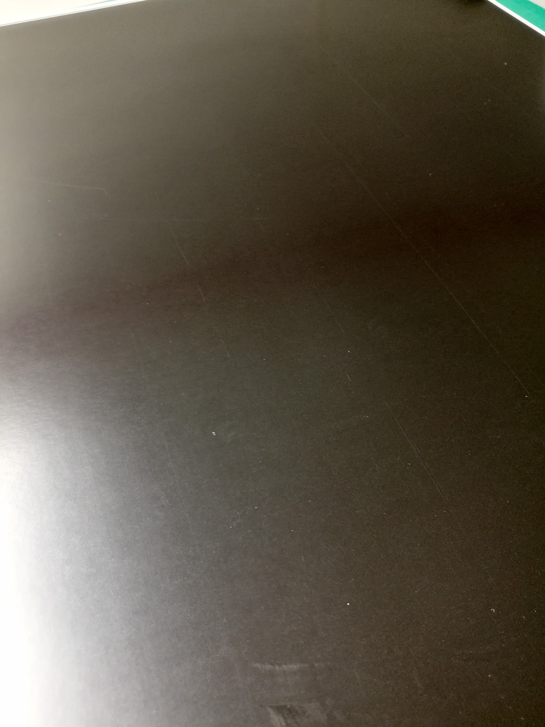

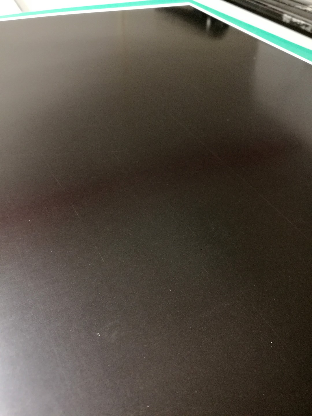

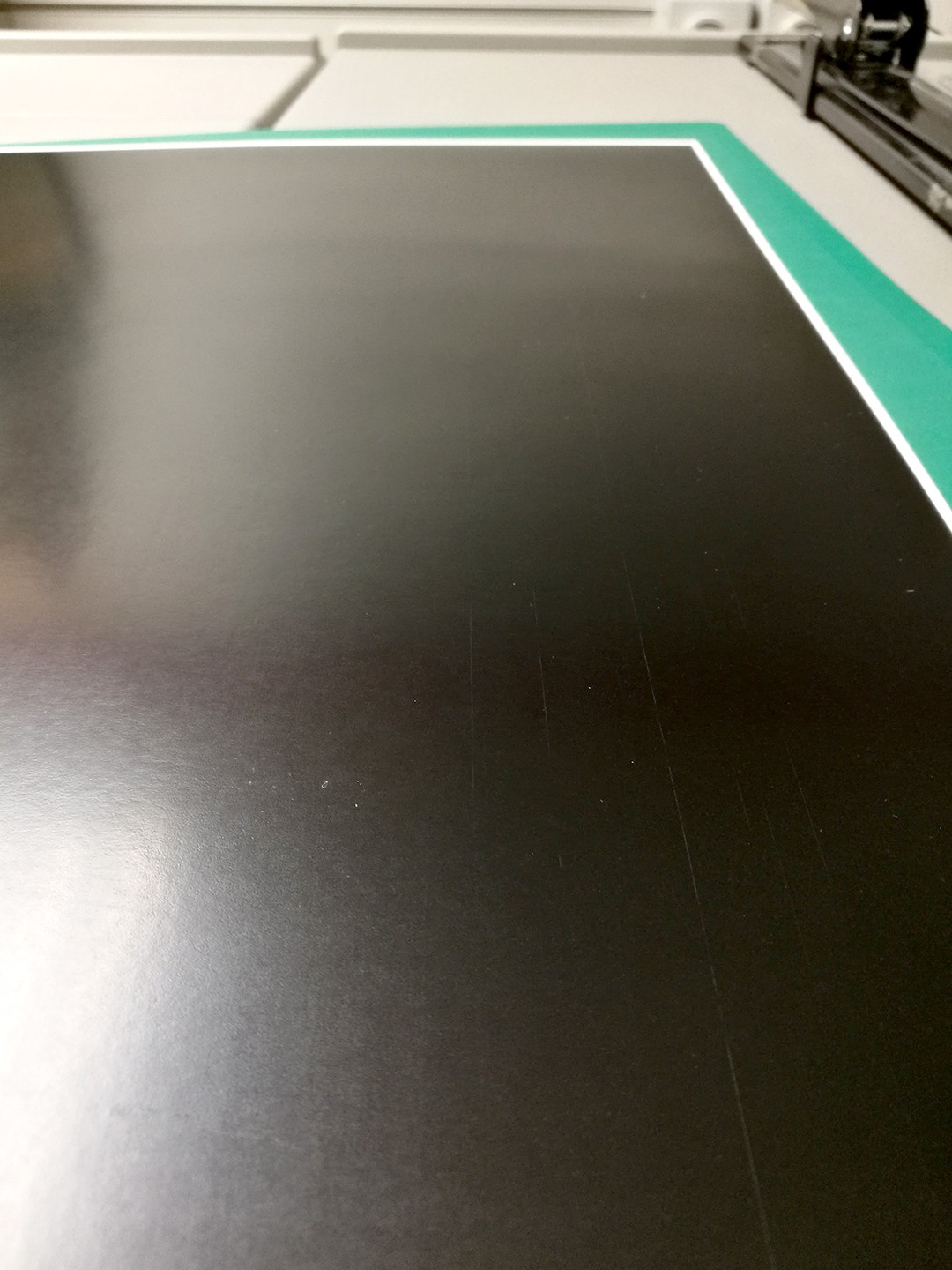

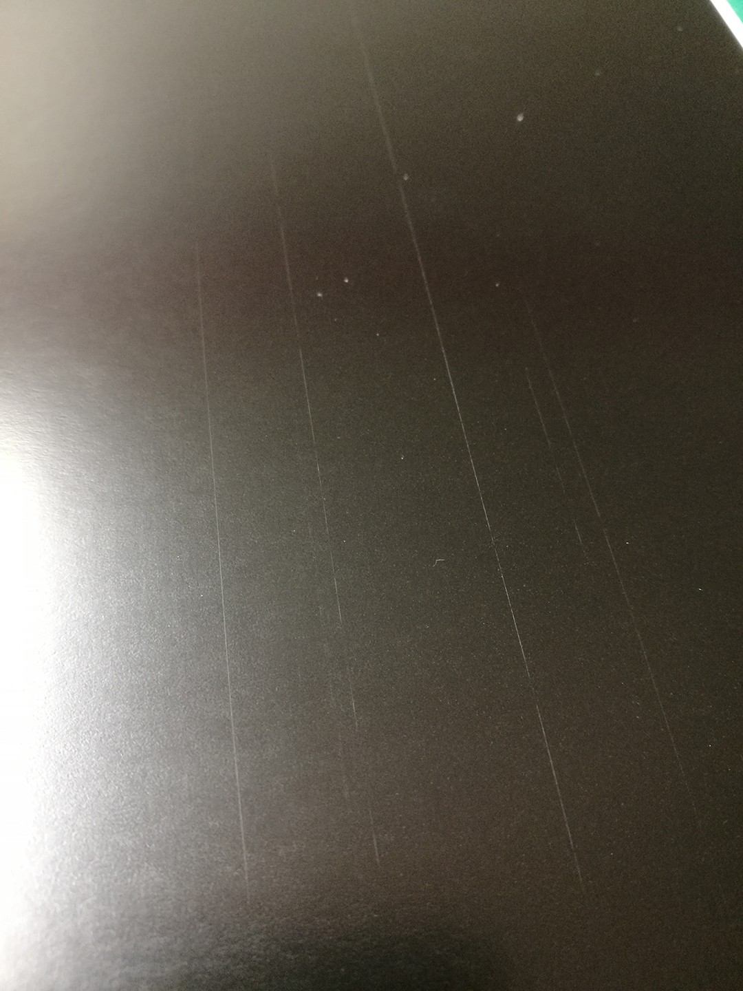

Sorry for the delay in uploading these photos, it's been a busy couple of days. These images show the scratches as best I can, I know it's a heavy black toner sheet which is extreme but it's good for showing the problem we are having. The scratches seem to be in the toner only, like the toner is being scratched off while running through the printer. It's always in track and shifts from sheet to sheet almost as if it's being scuffed or run across a sheet of sand paper. It's only visible in image areas and is being a bit of a problem for us.
As for envelopes we print a variety of sizes but mainly C4, C5, DL and DL+ both window and plain envelopes, we've done runs of 2,000 - 3,000, just fill the tray and let them run with no problems.
Thanks for all the help.

I get those, but usually it is from the paper transfer unit, I check it for lines and can usually match them up to the sheet, I just swap that out and the lines disappear.

My tech is here right now and I showed him your pictures, he works on a couple of 7110's and he thinks like someone else mentioned that it is the mylar on the bottom of the transfer belt. How many clicks on you machine?
Thank you both for your help, I've changed the transfer unit but no joy, I have got a tech coming in on Monday and will ask him to replace the mylar hopefully that will solve it ! :) The clicks on the machine is around 330,000
