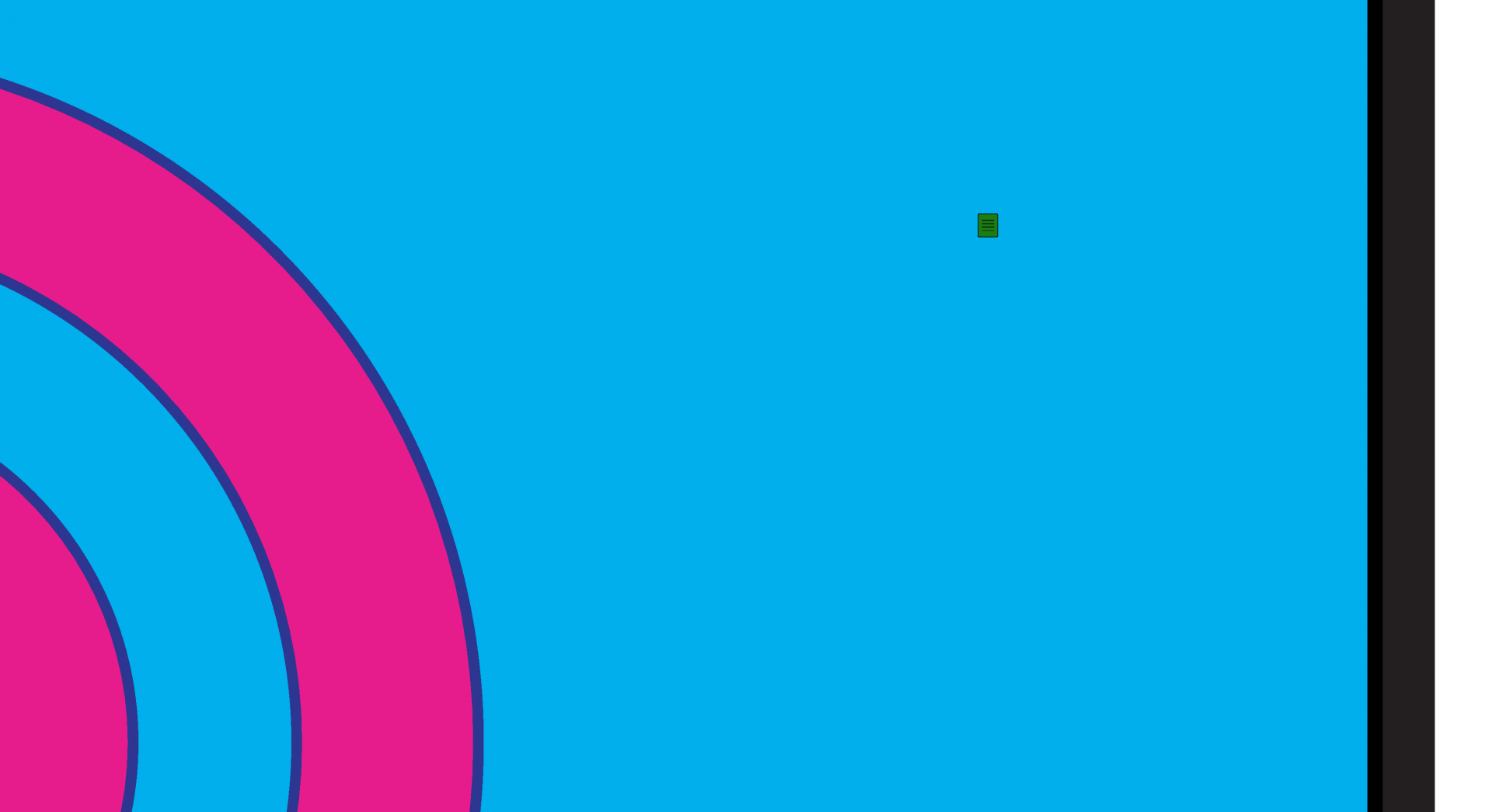

The weird thinig is, we look at the pdf in acrobat and it shows a trap (or is that just a previewing thing in Acrobat?)

Perhaps you're seeing overprints in Acrobat? We ALWAYS exported out of Indesign with no trapping applied and let the RIP do it. Worst case scenario would be trapping a trap-that gets messy.
Dov Isaacs
To repeat, there is no trapping feature in InDesign for exported PDF. If you are seeing something that “looks like” trapping, it is the result of manual overprinting applied in the design itself.

I believe I understand. It was just confusing me that when I looked at the exported PDF I was seeing what I thought was a trap, but was apparently overlapping, which is still confusing in that why overlap if it isn't to trap?
Can you post an example of what you are seeing?
Joe
Are you sure there isn't a stroke applied because the colors do not match up for what a trap would be? It would be easier to verify if you could post an actual PDF instead of a screenshot.
