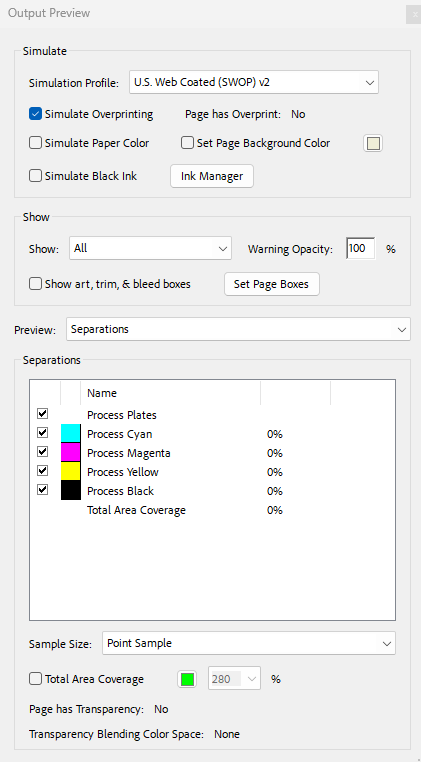

Can anyone explain what I'm doing wrong here? - by no means a colour expert and would love to learn more if time permitted, but I think I understand the basics...
Using InDesign, I have placed a client's logo which is C3,M71,Y100,K0
I then created a rectangle, created a colour to the above spec and filled the rectangle
In output preview, the logo shows correct as C3,M71,Y100,K0 however the rectangle shows as C5,M74,Y100,K0
I'm aware by changing the simulation profile the values change, however don't believe this is relevant here as the key point being highlighted is the shades of orange are slightly different between the logo and the filled rectangle, as the values are slightly different.
Any thoughts appreciated...

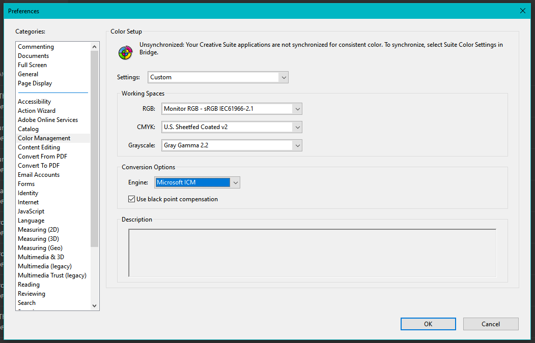

turn off Adobe Color Correction... its garbage in my experience (outside of printing photos on an 8-ink photo printer). Microsoft ICM outputs exactly what is input

Adobe made changes to Acrobat Pro some time early in the DC lifespan. Which causes color shifts in output, specifically output of vector artwork not matching input vector artwork. The ONLY solution we have found to date is to turn off Adobe ICM. Specifically when printing to a Postscript Printer using a Postscript Printer Driver.
