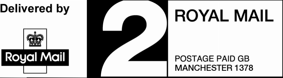

What's the quality like? We plan on overprinting envelopes with postage marks (Royal Mail image below). Do you think the quality will be good enough?
We get these litho printed at the moment, I know it could never match litho quality but how close do you reckon?

I run a riso 7150 for envelopes. the quality doesn't match litho or the Oki laser I also have. With that said most of our envelopes are going to that machine. Its fast, low cost, and with tweaking the image has a high quality. I tried a feeder with it but gave up when I couldn't get more than a few to feed consistently. Much of our stock needs to be de-curled to load the feed, but its the same curl(de-curl) technique we use at the insert-er so it is habit here for our operators. It runs faster than our ab-dicks and the ink doesn't run when the envelope print gets wet like our big secap jet1 can.

I don't think feeding is the problem, it's when the envelope gets in the machine, it trips a sensor because it's not flat or it rubs against a print head cleaner rod and leaves a smudge. But as long as the envelopes are flat, it'll be ok. As Bill Kahny said, you'll need to de-curl if necessary.
As for quality, depends upon who you ask. The printer in me says it looks like crap, the consumer side of me doesn't care. It's just a stupid envelope with a job to do. As long as it's legible and arrives at it's destination without smudging, good enough for me. So I think the quality is certainly good enough.
