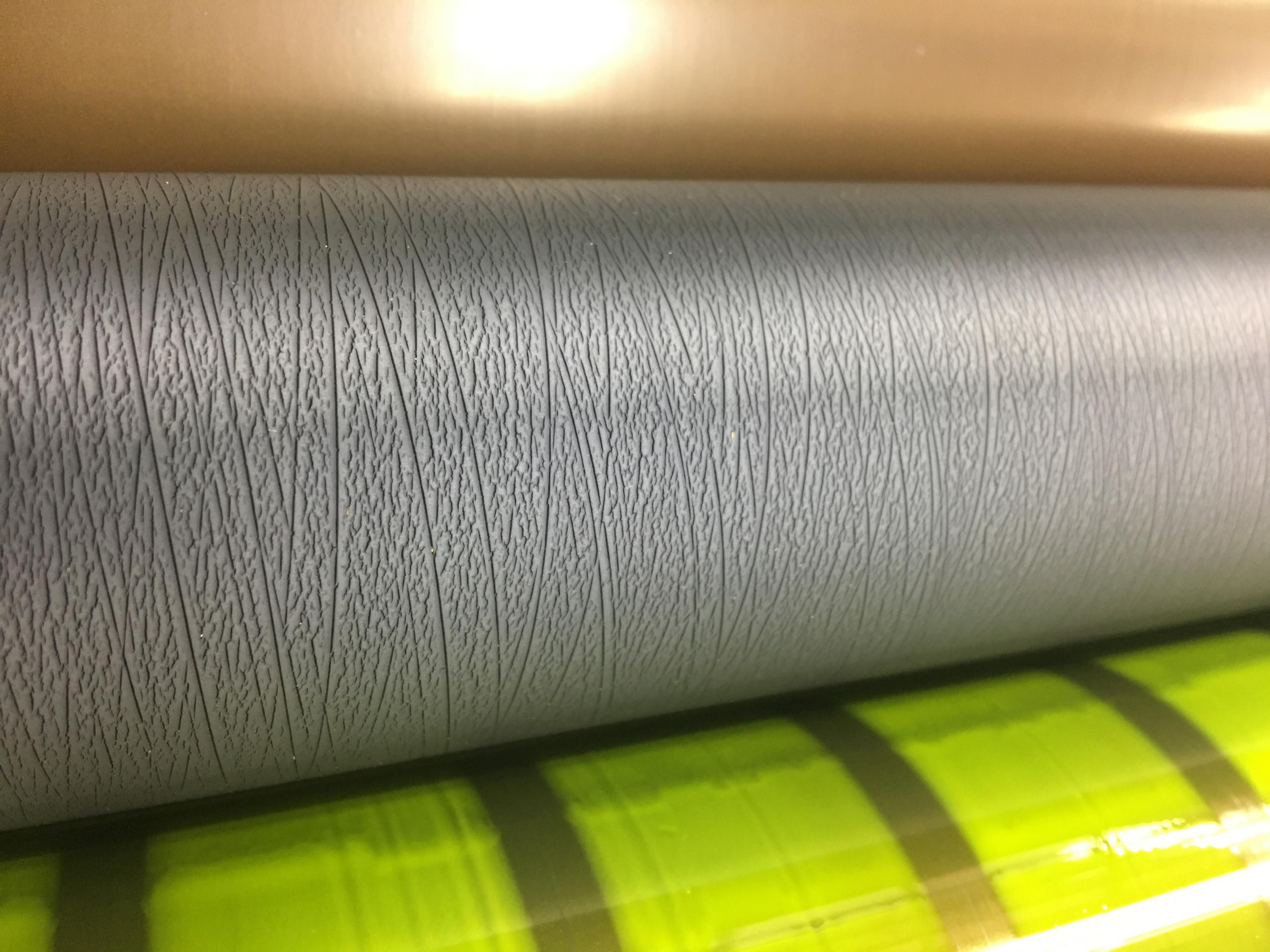

Good question Alois, The cut lines are in every unit,but very diff.. I had this problem before when I ran test rollers for parmarco. it was determined that they were using the emery cloth to long causing a build up which caused these lines, kinda like using sand paper when sanding it will build up in certain areas causing a score or cut in this case. Hope I'm explaining it good enough.. I will try to send a pic. This is on all rollers in press except water rollers.

Good morning guys, Alois to your question, the answer is yes to some degree, but faint, I did mentioned to the upper mang. that the rollers looked defective in a way, before putting them in.. The very strange part is, when I set rollers i always back off to the vibrators before putting in and then bring down like you should, I don't just throw them in, it took me at least five tries to get an even stripe, now, on our 2/color 40 inch the pressman had the same problem. actually he mentioned that these rollers seemed different when setting them. (he was right). Also when tech came in from Heidelberg we check the durometer 38-40.. (remember the rollers are only two months old).
Aliibryan, you are right on what you said caring for rollers, on appearance, the last set of rollers I got lasted a very long time with no problems. All of our chem has been checked way below VOC and flash point, I believe the problem could be, the rollers came in with defects (lines or cuts) when solvent and ink fills these cuts it penetrates even further into the roller causing swelling thus contaminated the rollers.( Remember I also showed Hedelberg this right after putting in).28 years of printing and I'm stumped. I just hope they stand behind it, alot of money at stake..
you mentioned the possibility of solvent causing rollers to swell and show more of the defect that was only faintly visible during installation. Have you noticed a need to back off a bit on the roller settings. If the rollers were as you say ,swelling, then they would need adjustment as they got larger.
Have you noticed any small metallic specs imbedded in the rollers? Ive seen this happen when plates get cut down to fit on a different format press. Edges cut in house would not be as clean as a cut from the plate manufacturer.
Tom, the weird part is I have to readjust the rollers a lot due to shrinking, Now that the rollers have been in for awhile there is minimum adjustment.
I took out one unit of rollers on Friday to inspect even further I did not notice any fragments but I did a durometer test only one roller was reading 25. All rollers had the cut line in them, which i had suspected, also starting to pit. Heidi informed us that good news is coming. I hope they are right.. Thank you for the suggesting I will let you know the out come..

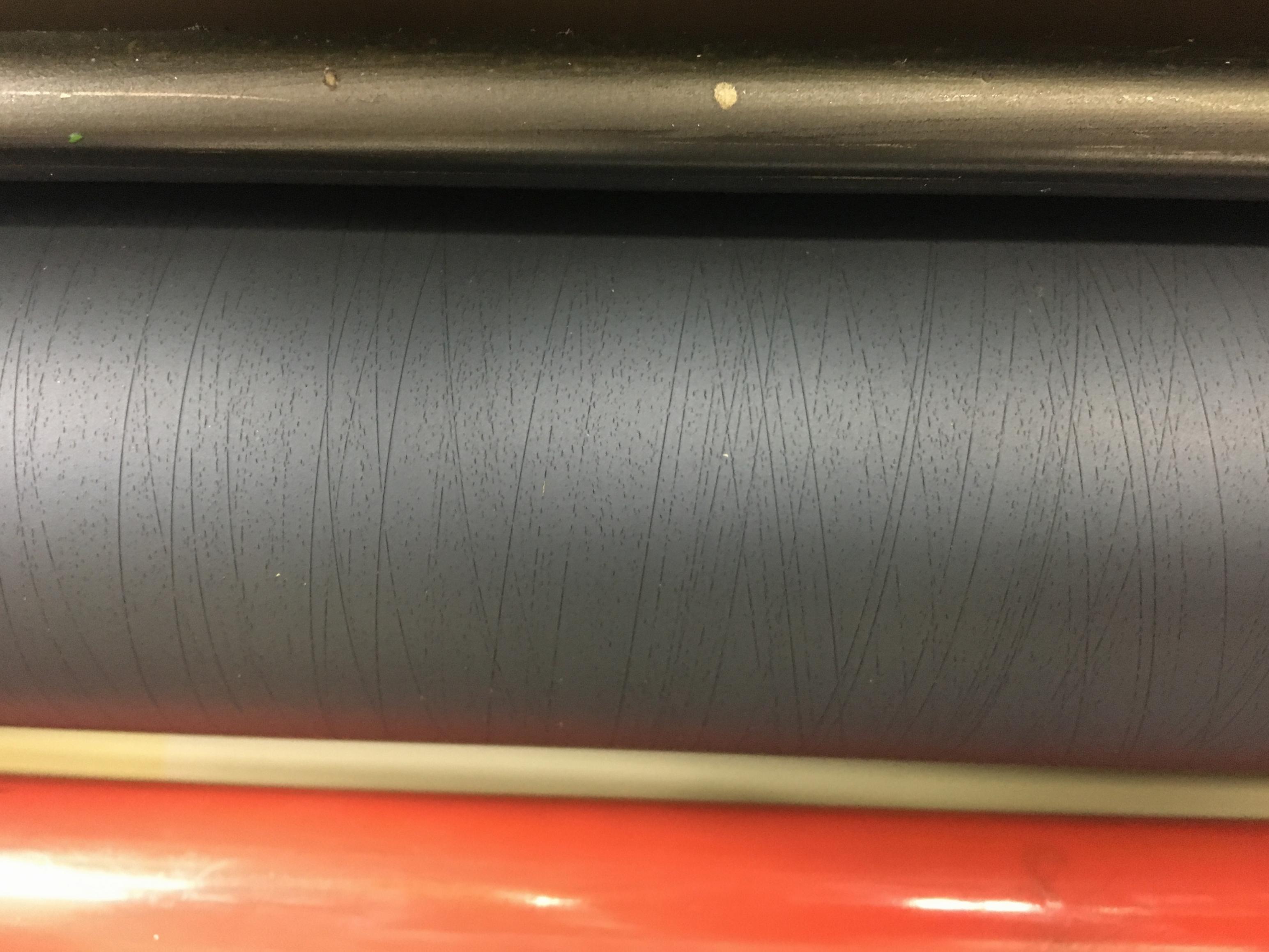

Not sure exactly where you are, but we always used Advanced Roller in Southern California. Awesome people, and always happy with the quality, speed and price for their recovers. Botcher was way more expensive and no better quality IMO. Wouldn't hurt to give them a call and send them a couple pix of your issues. They may be able to identify what is causing that. http://www.printing-press-rollers.com/
