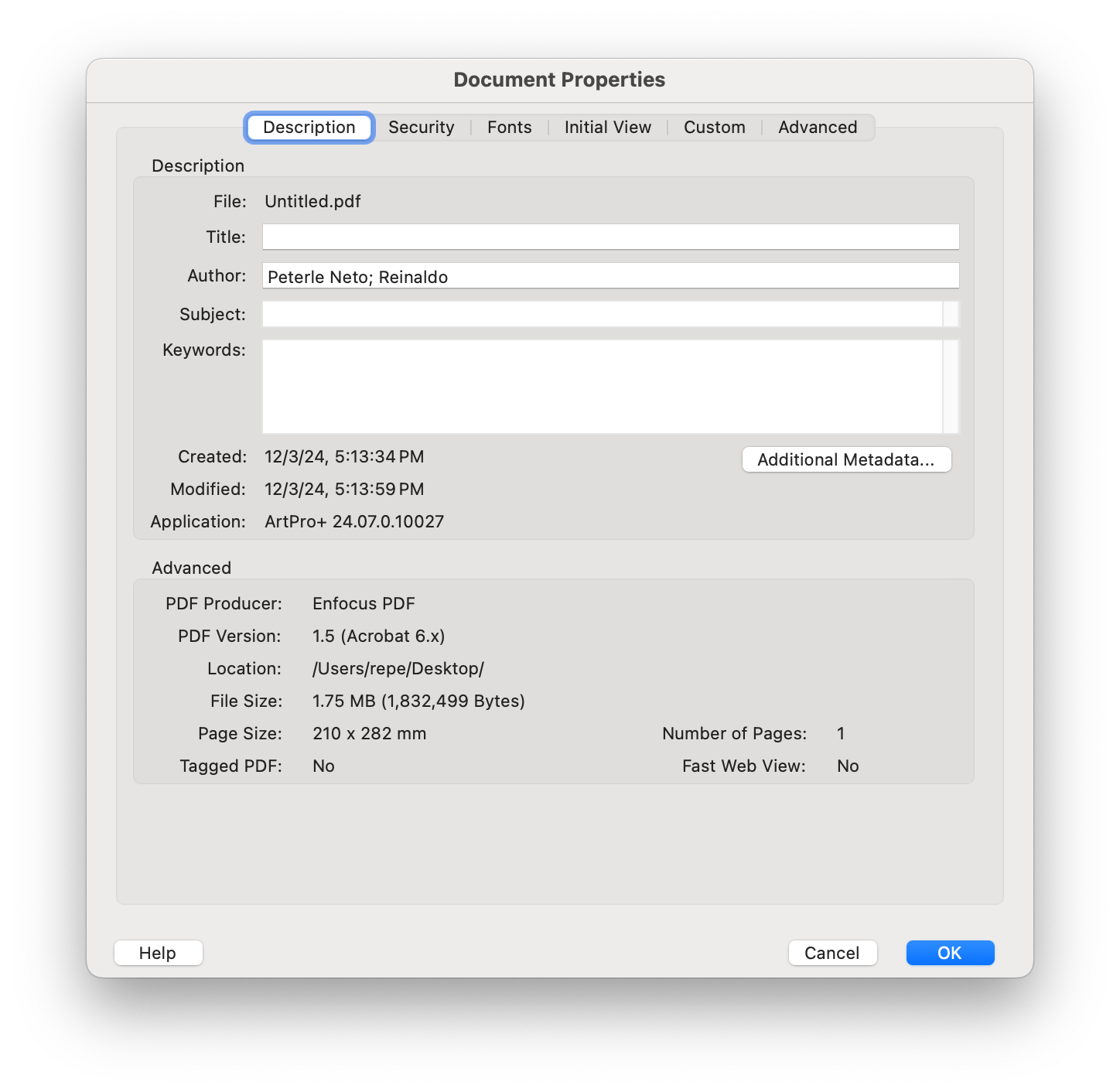

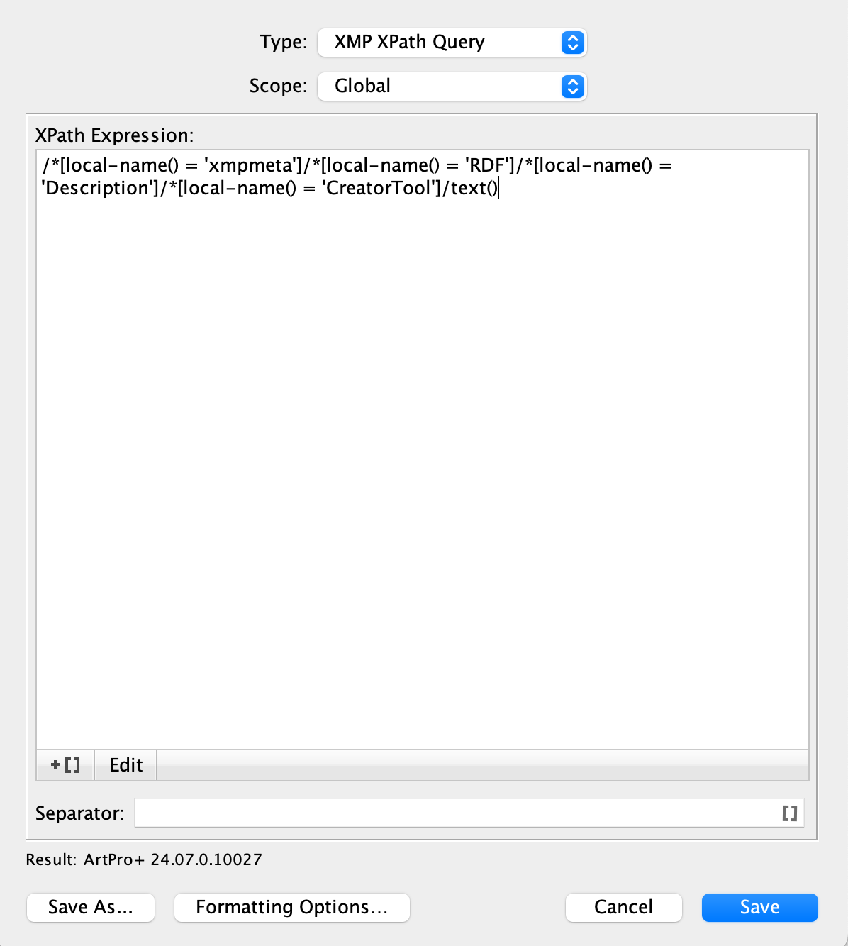

Hi Hans,
Could you try this trick? Create a Smartname and extract this XMP Xpath Query:
/*[local-name() = 'xmpmeta']/*[local-name() = 'RDF']/*[local-name() = 'Description']/*[local-name() = 'CreatorTool']/text()
