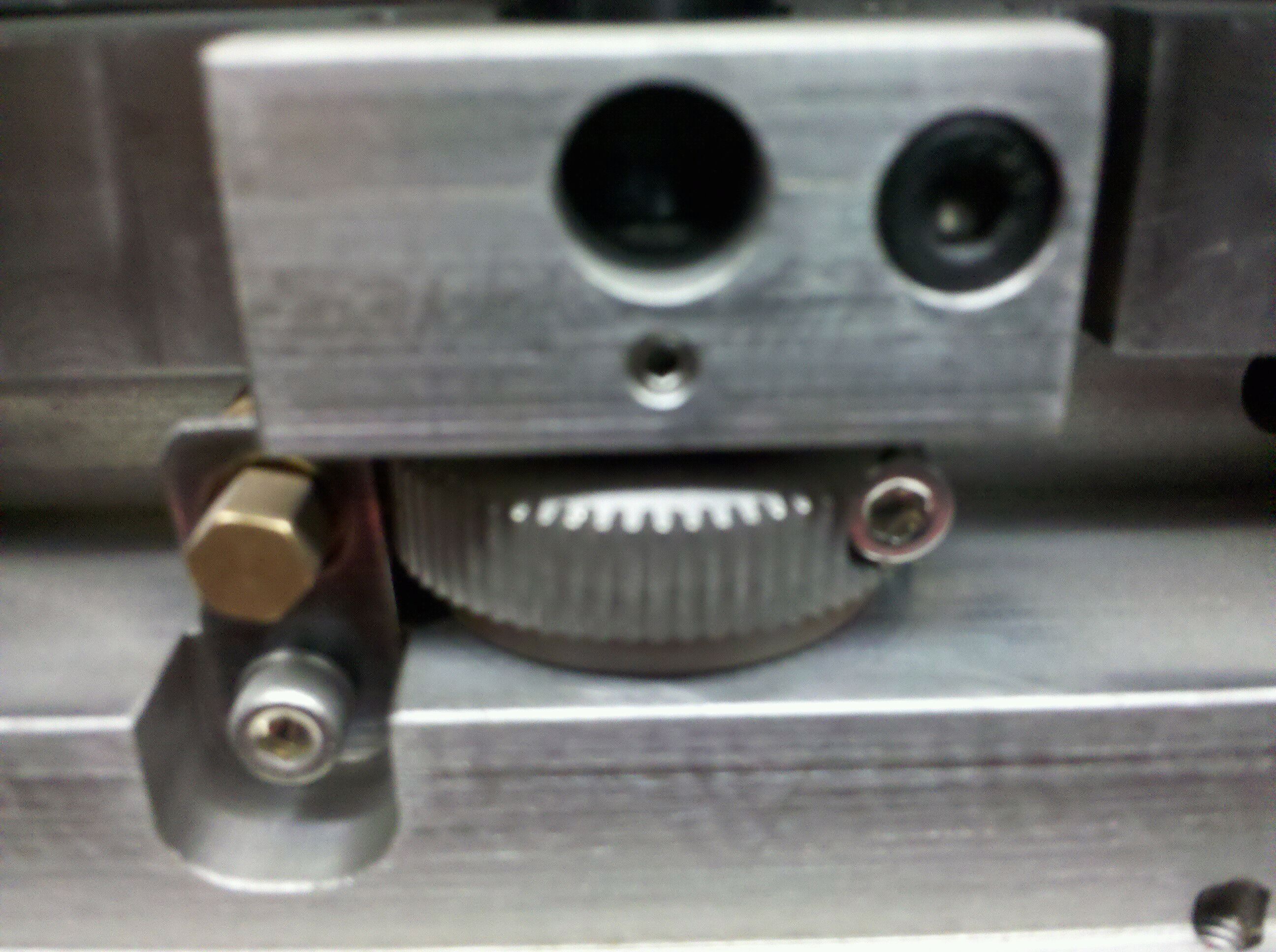

Can anyone tell me if this is the adjuster for the laser, and if it's as easy as spinning the dial?
Would hate to have presstek come out if I can do it myself...seems it's a 'guesswork' type of adjustment, and I can do that.

Hey RiversideGX, did you ever resolve the laser spot positioning? I am undergoing the same issue and have been turning the screw by the lens and i am seeing no progress.
Hi Tony671, the "screw" you are trying to adjust, is it metal or plastic? The first couple of years the machine was produced, they used plastic and it was prone to snapping at the axel - if that is the case you are basically out of luck.
Hey Mutti, the screw is plasitic. Out of the 6, the 3rd one snapped off. Adjustment is needed on the 3rd but since it has snapped off I am compensating the 4th, 5th, and 6th screw to favor the 3rd. Any help will be great. Thanks
